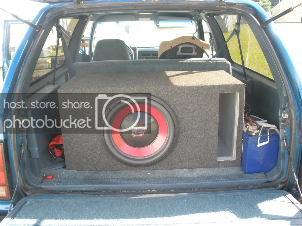

i have one woofer now...previously i did a 144.1 at 47hz (not sure if that is even my peak freq.)with one door open,then i ran 2 re sx 12s reconed by Fi audio and did a 145.3 to music sealed with same amp... at the next show im gonna use the 9515 and play the same song i did with the 12s to get an accurate comparison then some tones,also i have not tested my 9515 since it was repaired a few months ago and it handles the power a lil better than the 2 12s too.The box i have now gets pretty low and loud but it seems like it could us more port or something box is 37x17.5x19 double 3/4 all around port is 4"wide 14.5"tall 21.5"long
