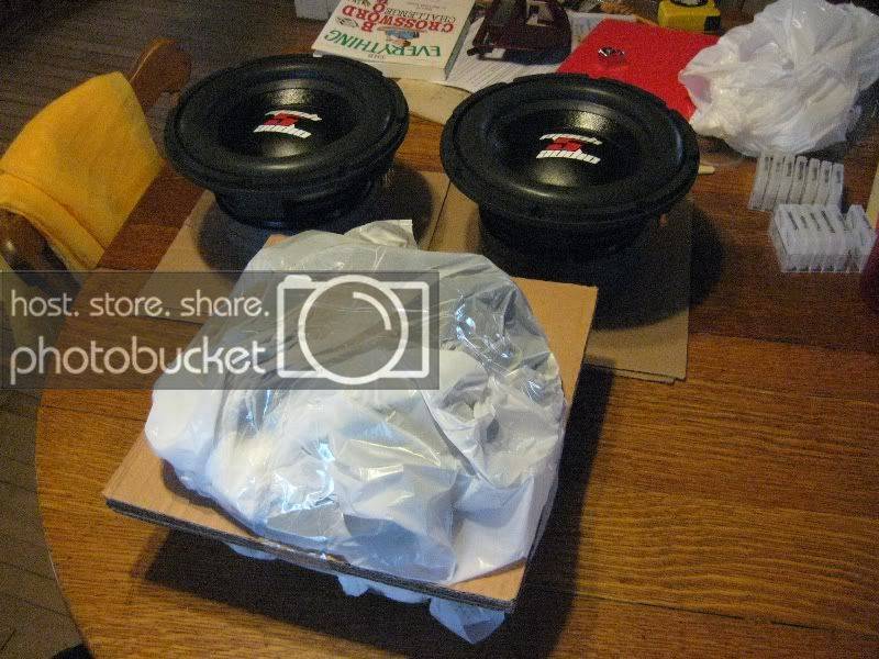

All Thanks go straight to Mark @ Mach5audio for all the help in getting me all this nice stuff :) and helping me along the way answering all my questions about passive radiators. I haven't seen many builds with passive radiators so hopefully this will help out anybody on the edge of getting involved with them..

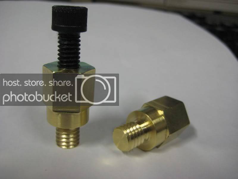

Here's some battery terminals I made in shop class at school on the lathe and vertical mill in between my other projects, Didn't like the ones you can buy, they didnt seem to fit right and well, it's too fun making things lol..

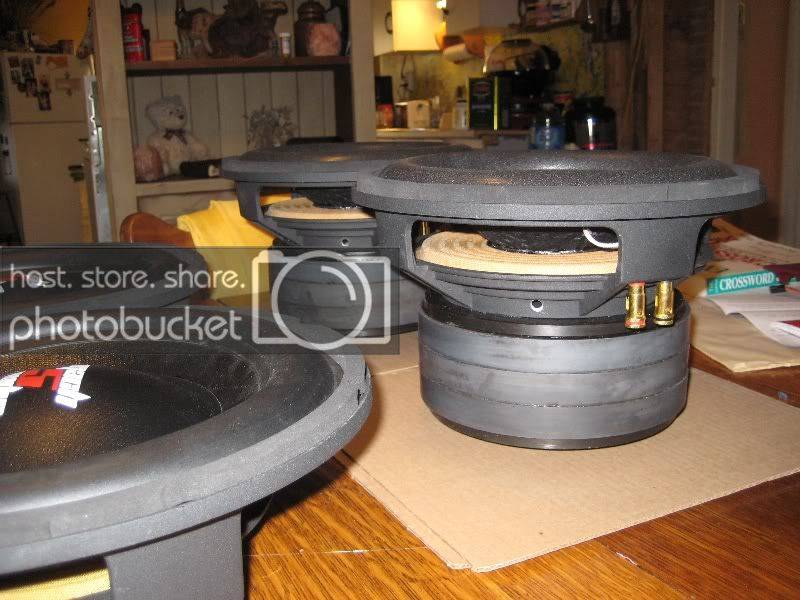

i just realized that those ixl-10's look pretty identical to the SA-12's..... beefy lookin subs, i've read that that make poor spl subs though....for the price you cant beat em
We'll my friend that's why they make the SPL-12/15 versions lol...because some people actually like to listen to music . the way it was intended to be heard haha

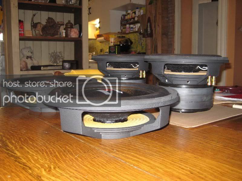

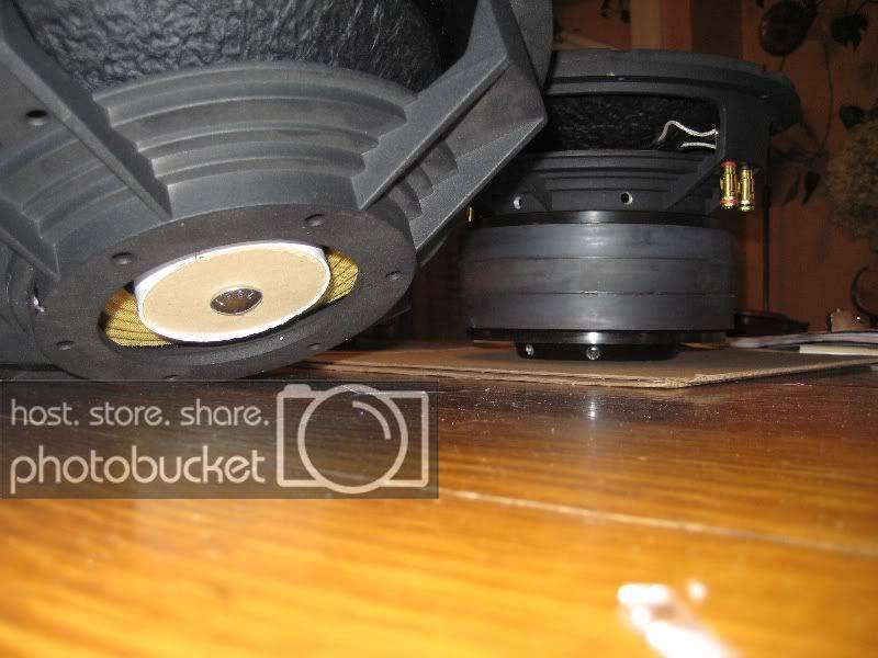

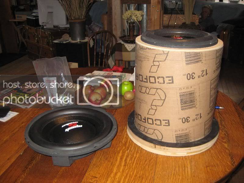

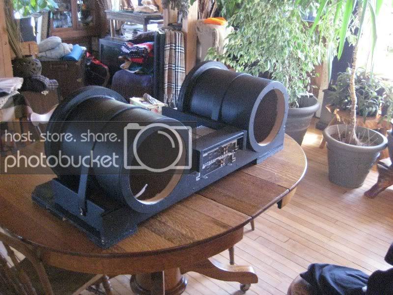

This is not SPL oriented,The plan was that I wanted a small footprint in my trunk , just wanted something very lightweight, no heavy mdf box, but wanted to have an amazing low end so I went with the passive radiators. and with a box volume of .4, bass reflex ixl version, it was possible to have that with a sonotube, and the sub and PR opposing each other...
The whole assembly weights barely nothing all assembled. pics of the whole rack to hold amps and subs finished coming up tomorrow

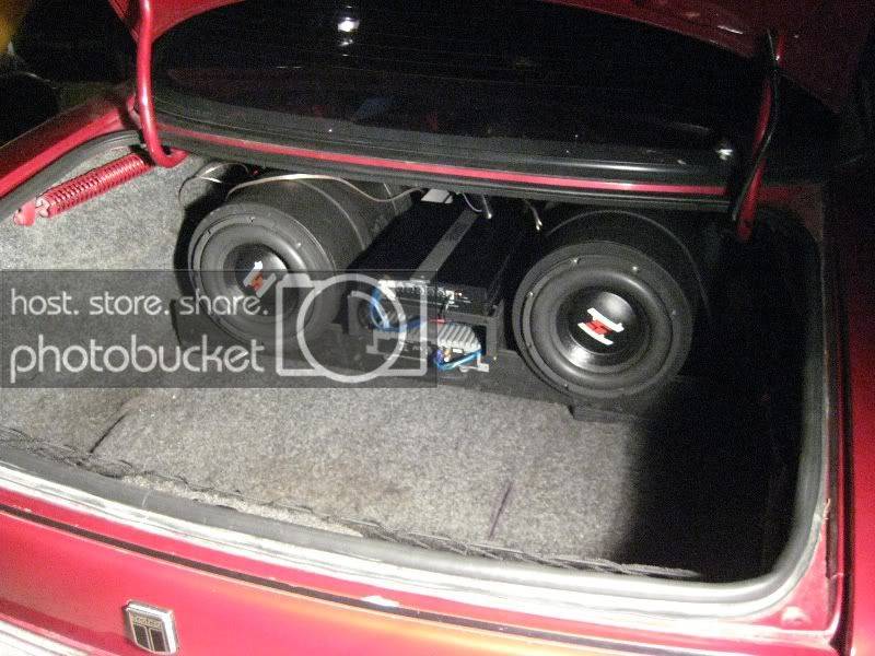

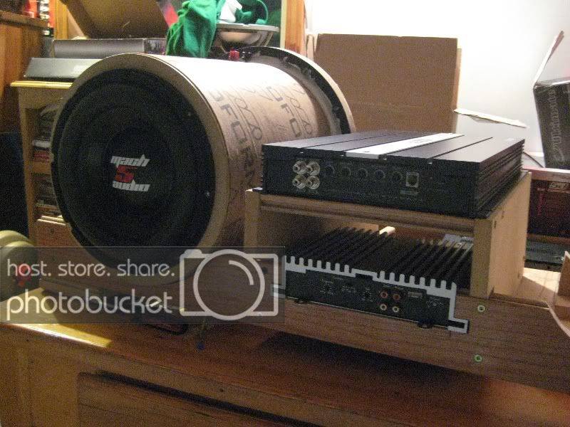

Here the final assembly minus the subs in and the sundown saz-1500 on top of those two smaller ultimate t2-2250 for my RSD6 components, one amp per side, setting the amps @ 100x1 @ 4ohms for each side. Don't know if they can handle more lol.. they are rated for 60 rms, and my amps will do 160rms @ 4ohms bridged.
Here it is, sitting in the trunk where it should be permanently, still lots to do, but this gives you a rough look of how its going to look..
