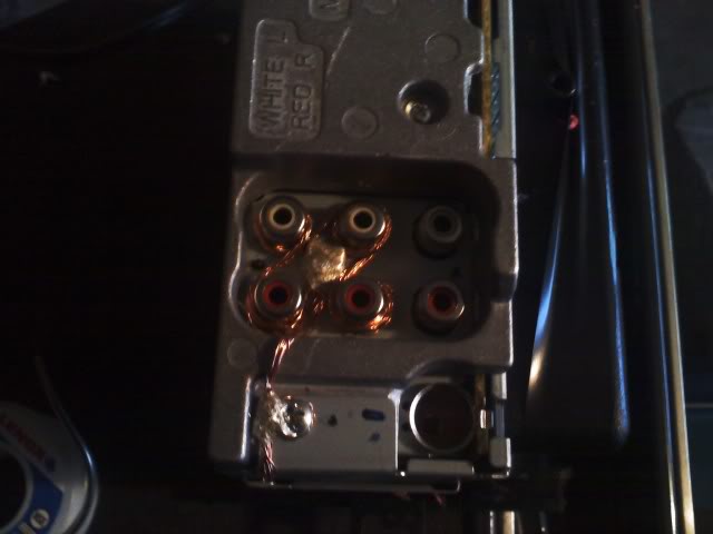

the "fix" is to ground a set of RCA ouputs from the HU, to the chassis of the HU. theres a little threaded hole on the back of the HU. get a metric (i think its metric...M2 or something i cant remember) bolt, a little ring terminal, and ground it there. just strip some wire, and wrap it around the metal part on the RCA output, and tape it in place. ghetto, but itll work. ill get pics of mine tomorrow although i think theres pics around here but the search doesnt seem to work.
ill post pics tomorrow though if there isnt any, or if you still need help.

this is what i did on mine to fix it (the red wires)
