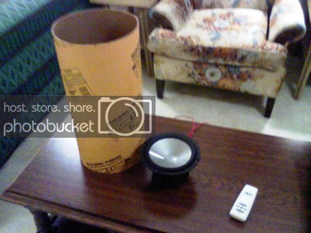

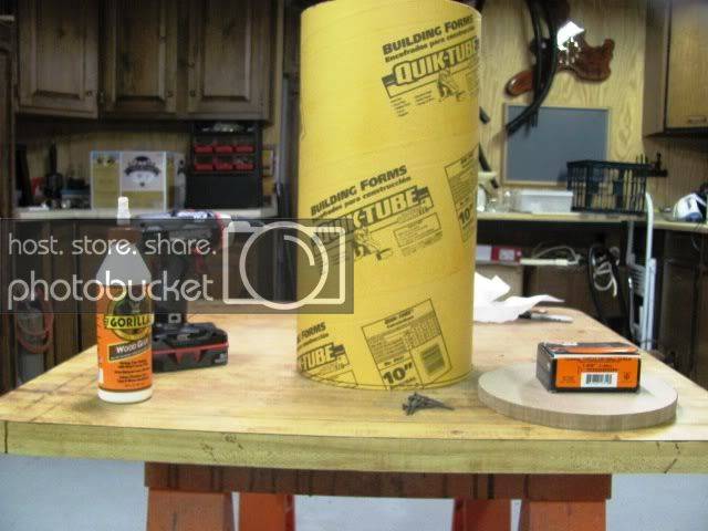

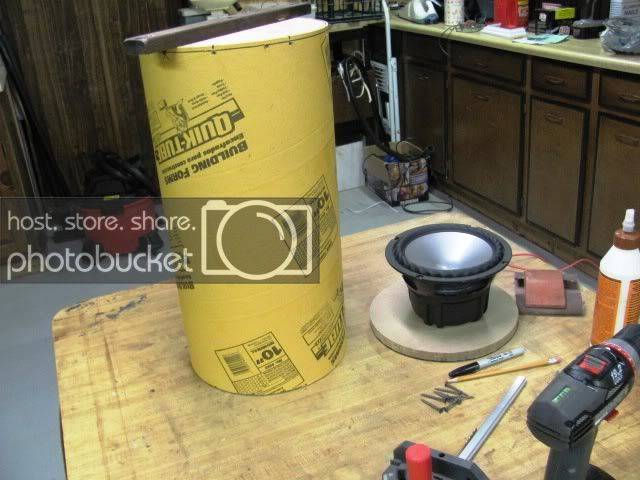

My little winter project. Specs:
Bravox 8" PXW
Sonotube - 0.84cuft w/ 2" Aero tuned to 33hz
Power - 240w rms
Pic:

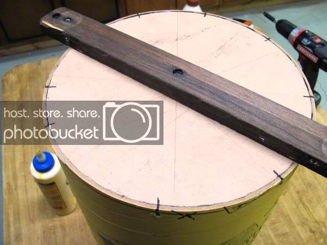

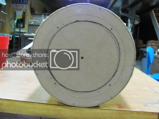

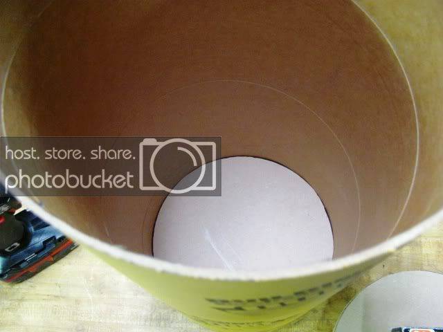

Waiting for a better day to go outside and cut the endcaps. Will keep you guys updated asap. Feel free to input thoughts and questions!

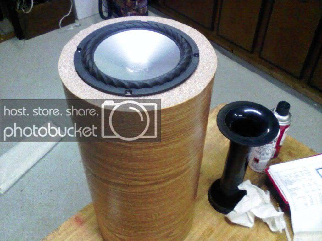

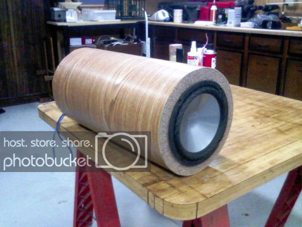

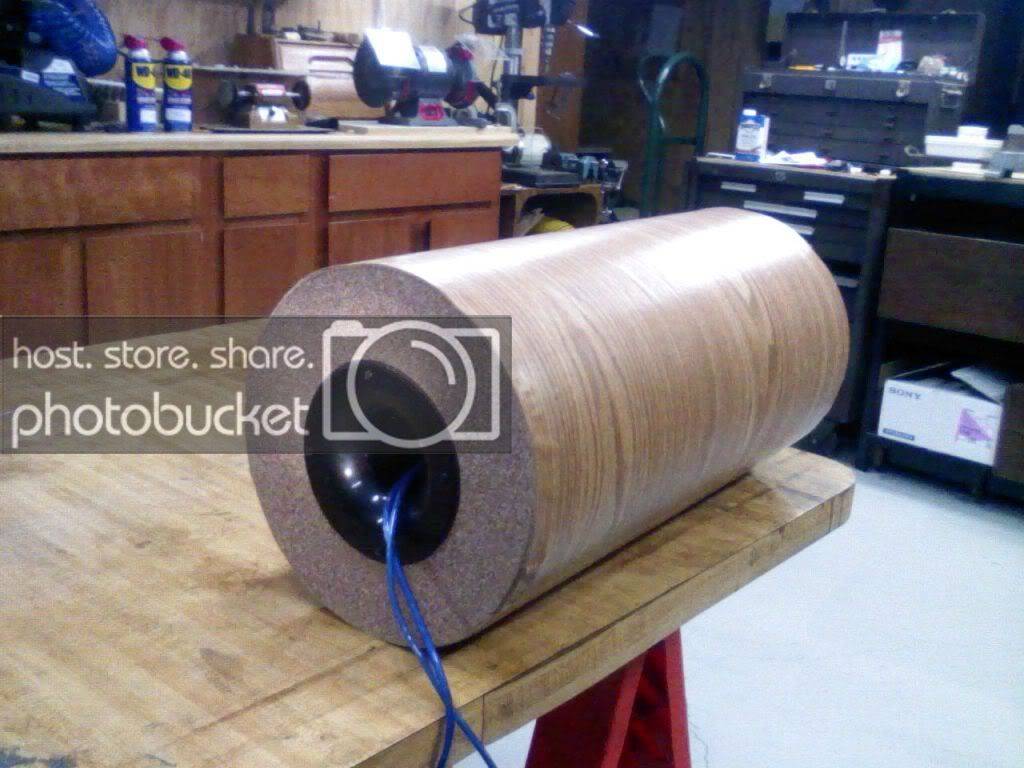

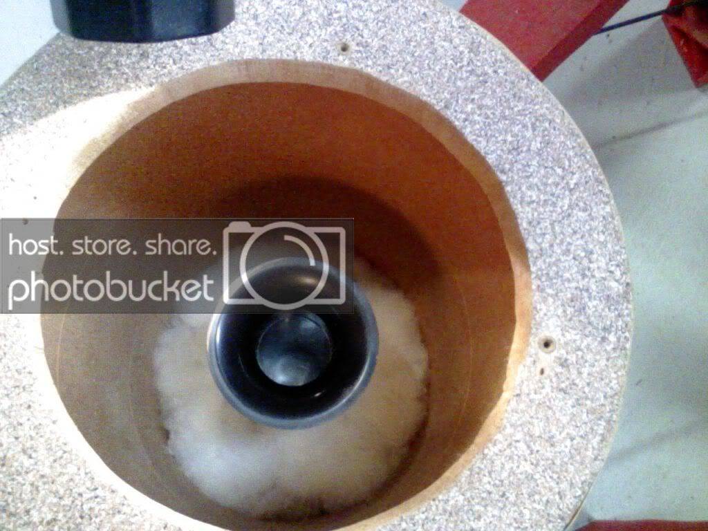

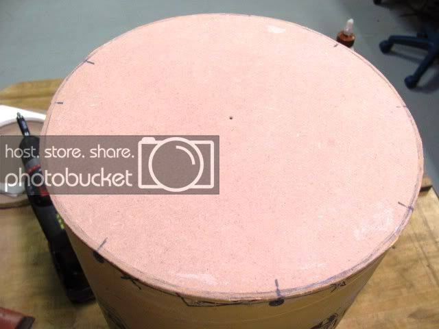

Finished!!
What you guys think? I'm running it off a 240w plate amp and IT SOUNDS AMAZING. So clean and smooth. Fills my whole room and even rattles the walls. Did not expect this build to have such a good turn out. After displacement it is .7cuft tuned to 30Hz.
