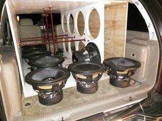

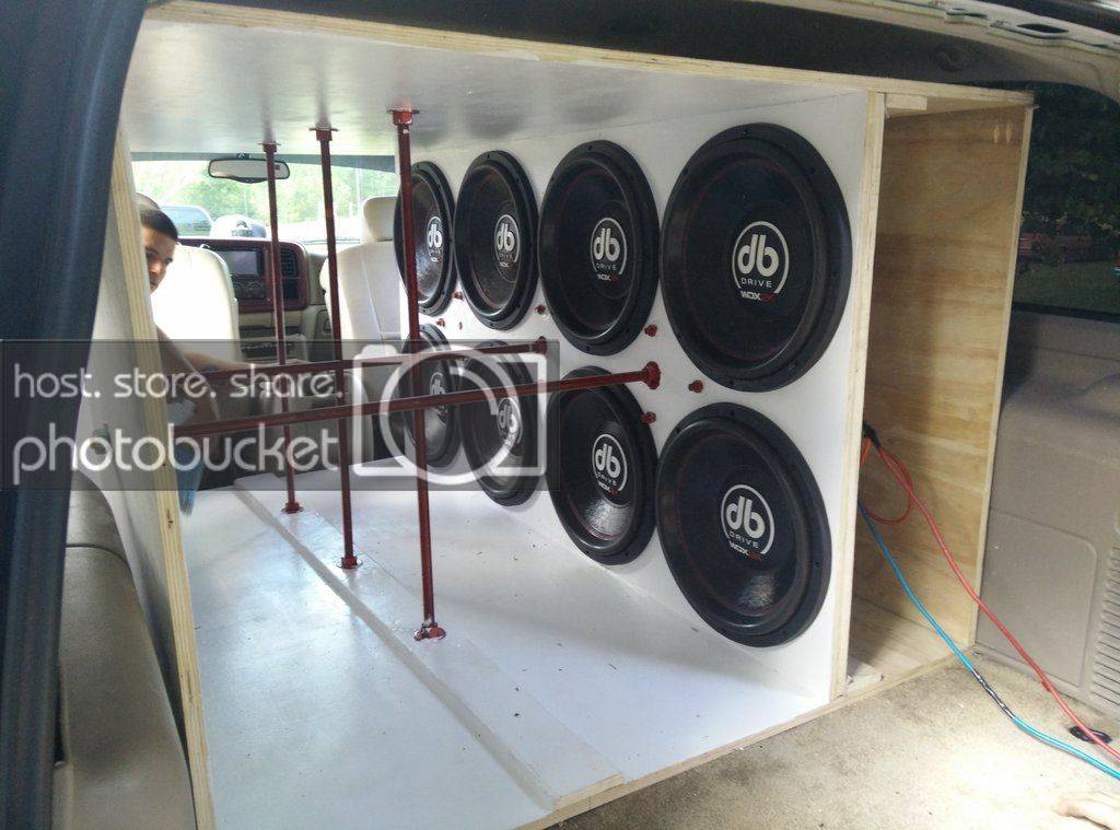

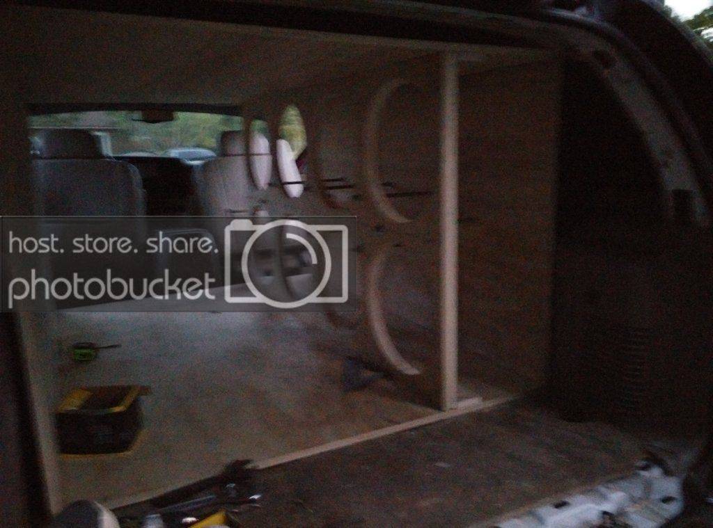

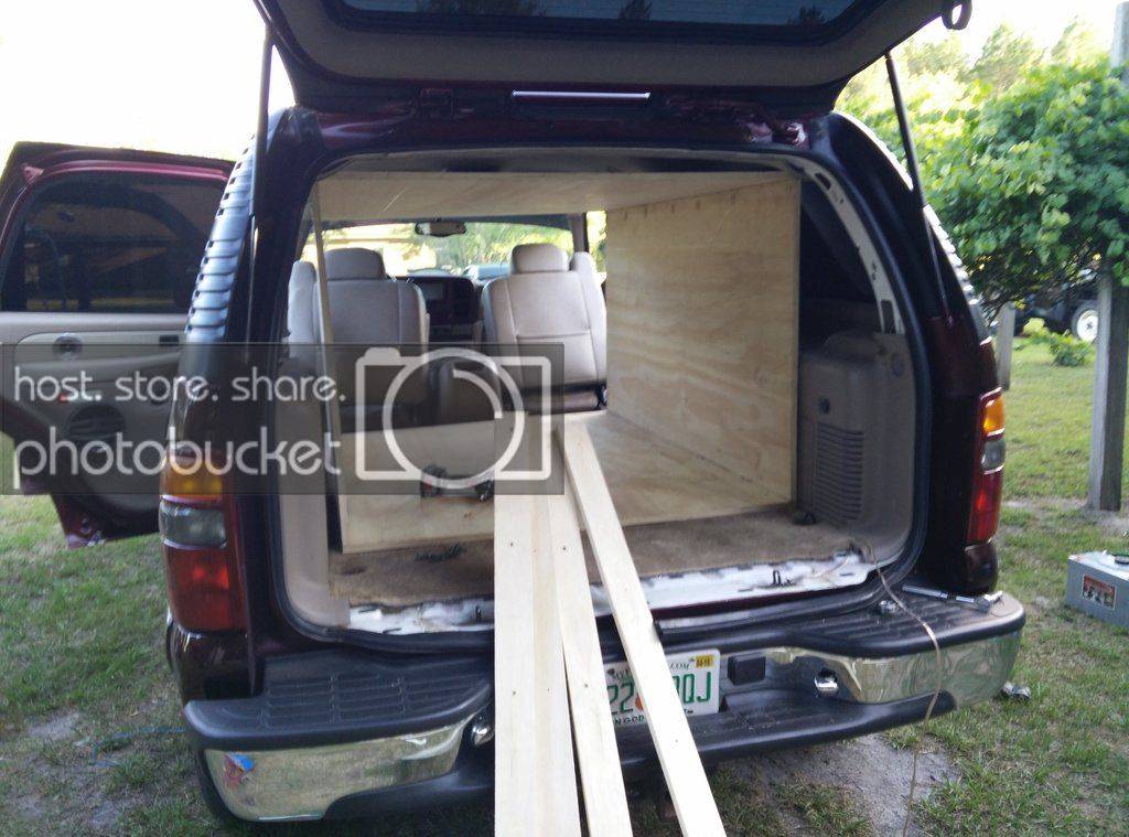

Build we did this weekend. 2 days straight no sleep. Cheap DB drive "2k rms subs" on a Taramps 20k with ZERO gain. popped one sub in 5 mins. Didnt finish port,trim panels, sealing off or anything. Going to be doing a sub swap. Hopefully Sundown X 15s
8 15"s
60 cubes. 4th order.
14 sealed chamber. 45hz tuning with test port.
Taramps 20.2kw
Lots of mids, tweeters, and horns all around. PRV, McClaren, and American Bass.
Crescendo 1100.4 and 800.4
TJ the owner is cool as hell.
Don't understand people that have a nice amp but ****** subs.
Or sometimes its the other away around/.
These were in a normal ported box on a lanzar opti 6k. He heard my buddies setup at our last show and wanted us to rebuild his setup and bought his taramps 20.2kw.
