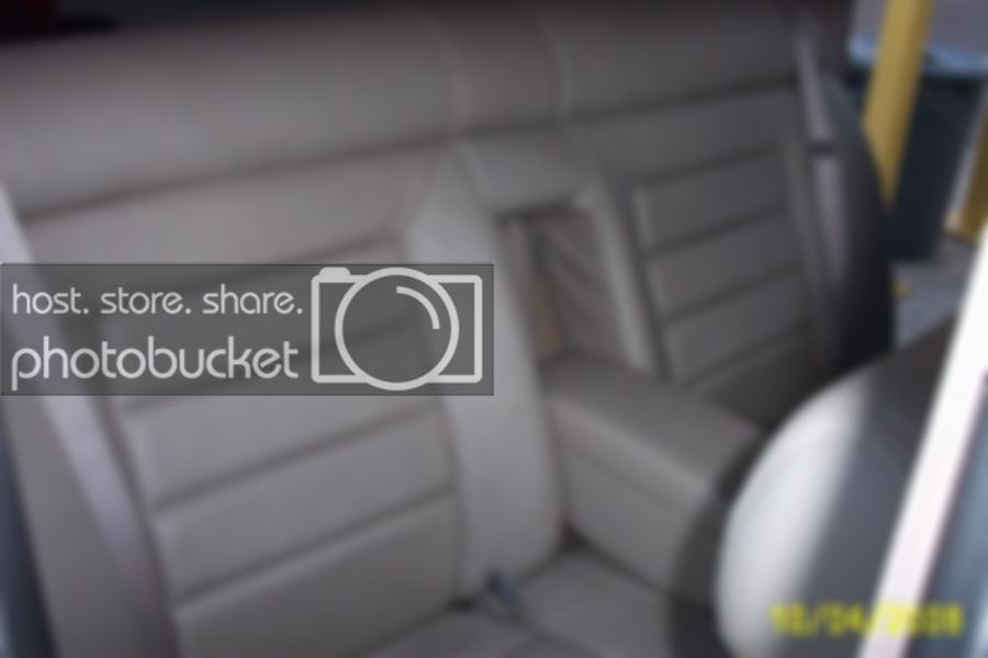

Well, my seats are bench they do not fold at all *however* ... //content.invisioncic.com/y282845/emoticons/naughty.gif.94359f346c0f1259df8038d60b41863e.gif ... I managed to break the mounting studs for the top of the bench when I installed the 6x9s... (not my fault, rusty bolts) . So I'm getting somewhat of a vent from the trunk with the seat sitting slightly forward (about 2 inches). And I also plan to cut out the leather that backs the "armrest hole" for more p0rtage... //content.invisioncic.com/y282845/emoticons/biggrin.gif.d71a5d36fcbab170f2364c9f2e3946cb.gif
Because when people sit in the backseat it closes the gap and I get almost NO bass up front, while everyone in back enjoys a lovely back massage //content.invisioncic.com/y282845/emoticons/verymad.gif.3f39c5c2fd57527b671fad3efdfac756.gif
Shot of the armest you can see the leather-wrapped insulation material in the middle that's going to be cut out... would this make a sizeable difference IYO?

i told ya before that you could just cut out the center of that armrest real quick...but if you wanted to get crazy with your build its better on these lacs to just vent the rear deck...//content.invisioncic.com/y282845/emoticons/cool.gif.3bcaf8f141236c00f8044d07150e34f7.gif
Well, you save 3/4" of the total width but there are no sonic advantages. It's always better to have the center divider as it keeps turbulence down when the two port sections meet. The triangle in the back will help with that but a center divider would be much more effective and would allow only one side to be hooked up at a time with no ill effects.
True, I went this route due to space restrictions (the box has about 1/16" of clearance on either side)
I remember that, I might look into the rear deck once I get everything hooked up and ready to go //content.invisioncic.com/y282845/emoticons/smile.gif.1ebc41e1811405b213edfc4622c41e27.gif

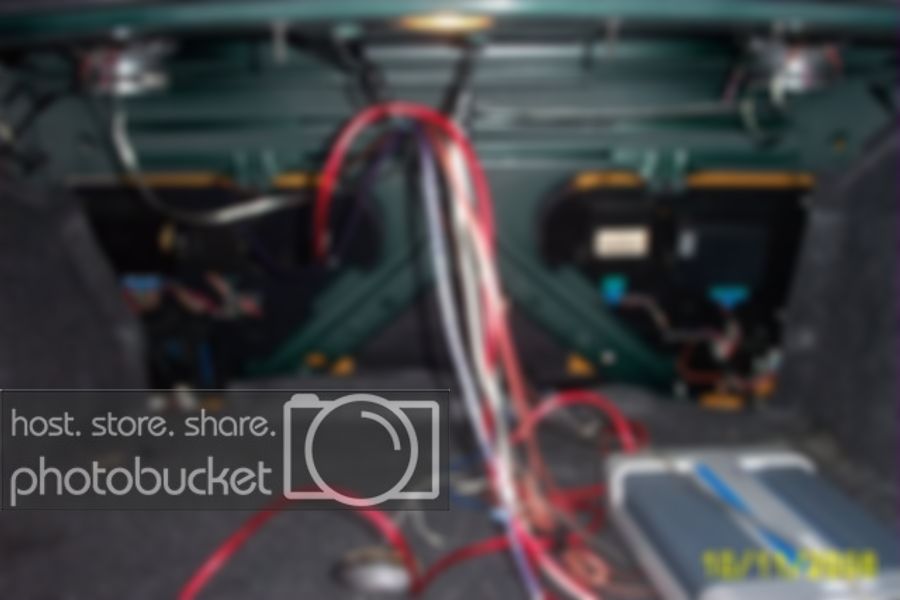

EDIT 1 And here is a shot of the trunk space please disregard the mess it is temporary! The little triangle on the bottom can be cut out and vented directly into the cabin, but the spaces to the left and right have steel supports with electronics bolted on to them //content.invisioncic.com/y282845/emoticons/frown.gif.a3531fa0534503350665a1e957861287.gif
EDIT 2 lilcarus... I'm thinking of cutting out the 6x9s as you did as well because they are completely muffled sitting underneath the carpet! Bad design IMHO! It's like listening to them through an apartment wall //content.invisioncic.com/y282845/emoticons/crap.gif.7f4dd41e3e9b23fbd170a1ee6f65cecc.gif
You should fire them forward, and cut out that armrest hole. Seal the box off from the rear of the trunk with MDF falsies carpeted to match interior. You need to either remove those 6x9's, or build a box around each of them, so those moofers dont make them slap........
