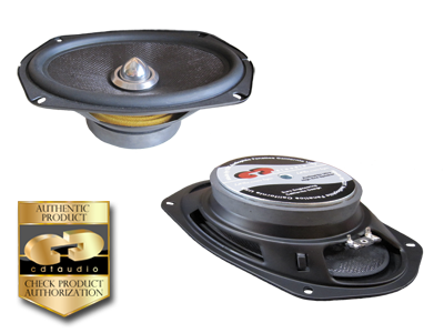

This is it. CDT Audio ES-690CFS Gold
Technical specs and contents:
Frequency response 30Hz-3500Hz
Power handling: 180W
Nominal Impedance 4 Ohm (2 Ohm available)
Sensitivity: 86.1dB
free air use mounted in rear deck, large door or panel
Mounting depth: 2.87”
Cone: Mix carbon/fiber glass cone
Magnet weight 27 Oz
Cone surround rubber
Voice coil: 1.4”
@Jeffdachef; Thank you for the mention.
