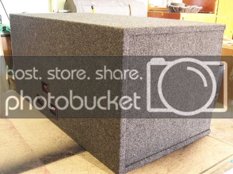

Have you ever tried doing your braces like a "T" instead of flat against the walls? Normally that's MUCH stronger and they'd only need to be about 1 1/2". Or do you think it would disrupt airflow through the box too much?

They're fine how they are. If you didn't have dowels, he'd be right, but it's supplementary bracing instead of primary.
I don't doubt that the T brace would be stronger, but I feel that the bracing that is on the back wall is more than sufficient to prevent flex.
Plus, I've never been a big fan of the way the wood protrudes into the box when using T braces, too much chance of disturbing the airflow IMO. If someone can tell me that's not the case, then by all means I'll turn that puppy 90 deg... but otherwise I'll stick with the bracing the way it is.
Bingo. The concept of a shelf brace is excellent. Airflow is a problem though. They create turbulence inside. Air is a fluid, so let's compare it to water. If you have a stream of water and stick a wall in the middle of it, it's going to create a pocket behind it (turbulence) which disrupts the flow. If it's round, then not so much. Problem with dowels though is that they don't have much surface area.
