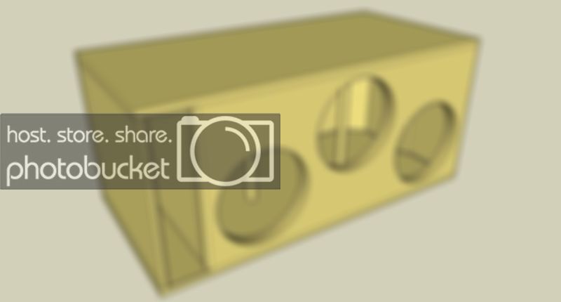

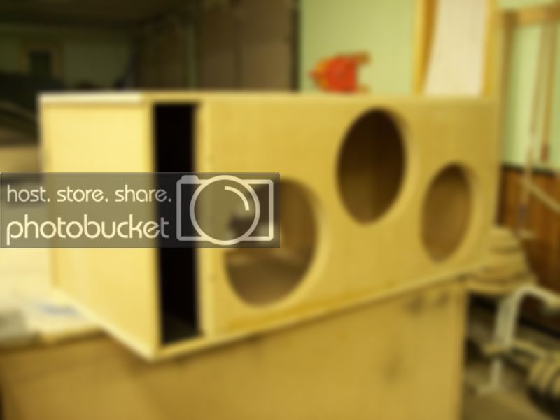

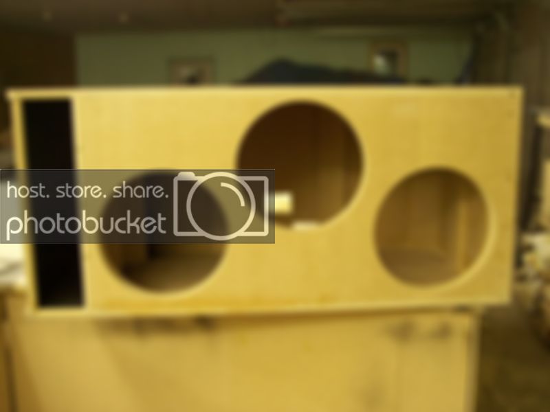

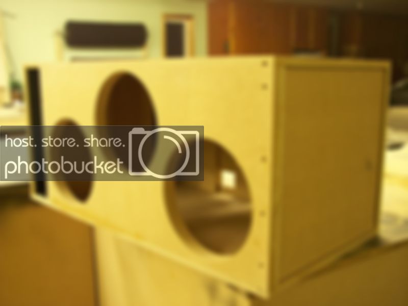

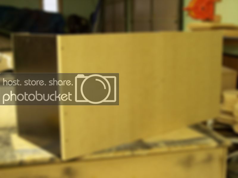

This box is for a returning customer. It will be 6 cubes NET tuned to 32 hz. It will house a trio of Rockford Fosgate Punch HX2's.
Box will be going into the rear of a Jeep Grand Cherokee, so we have some good amount of room to work with.
Box will be finished off in a charcoal gray carpet. The design is compliments of Chris (IonSQL) who can now be contacted through http://WWW.FisherCustoms.com for designs.
Thanks again Chris,

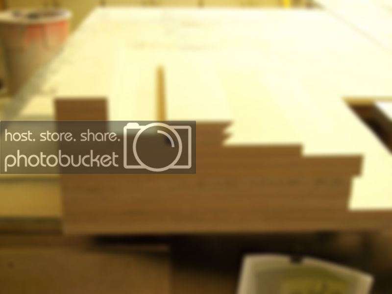

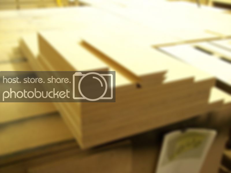

It looks like a layered piece for the second baffle piece. Do you mix plywood and mdf? If so, how well do they glue together?
I'm guessing what you're seeing is the indentation that the cam made from the flush trim bit, but feel free to correct me BJ //content.invisioncic.com/y282845/emoticons/biggrin.gif.d71a5d36fcbab170f2364c9f2e3946cb.gif
Nailed it. Both front panels are Trupan. It does appear to almost be a layered ply, but like Chris said, is from the router.

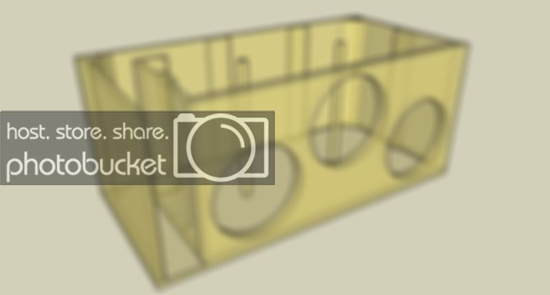

Have you ever tried doing your braces like a "T" instead of flat against the walls? Normally that's MUCH stronger and they'd only need to be about 1 1/2". Or do you think it would disrupt airflow through the box too much?
Looks nice as always, and the questions are just to learn from your experience. I'm going to be building a BIG box for 2 MJ-18's in a few weeks and trying to decide the easiest way to brace it. Sorry for the thread jack...
