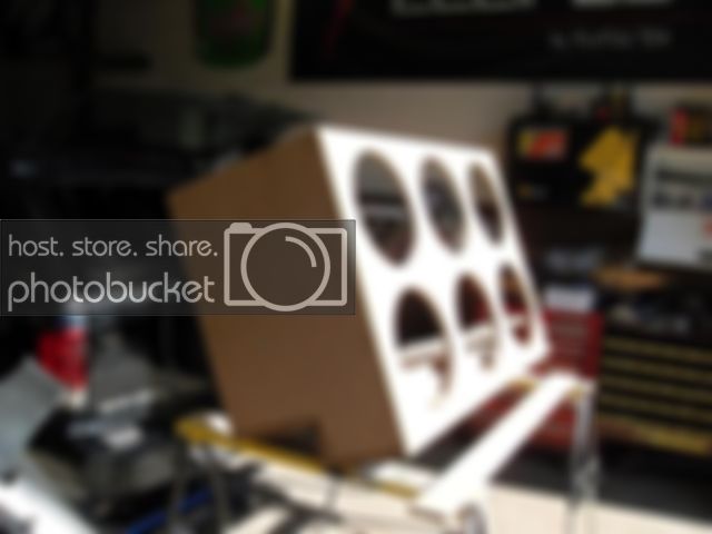

This is a rebuild for a customer (the last setup was 3 15" sr's sealed aka the one in my avy). The new setup will be 6 15" Re audio D2 SR'S in 18cuft after sub and port displacement tuned to 34hz //content.invisioncic.com/y282845/emoticons/biggrin.gif.d71a5d36fcbab170f2364c9f2e3946cb.gif. The sr's will see power from 2 us amps md1d's. 2 runs of american bass 0ga front to back, and 2 kinetik 1800's in the rear with a ohio 250 alt. It will also get a new Eclipse cd3200 in place of the alpine, and front and rear re audio 6" coax's. In the end should sound nice //content.invisioncic.com/y282845/emoticons/veryhappy.gif.fec4fed33b4a1279cf10bdd45a039dae.gif

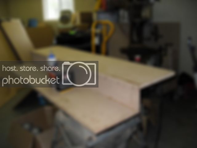

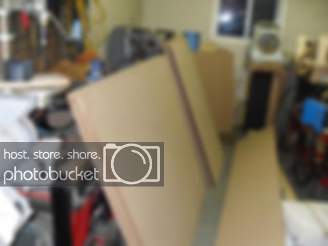

Wood cut for the box
Pic of bottom going gether

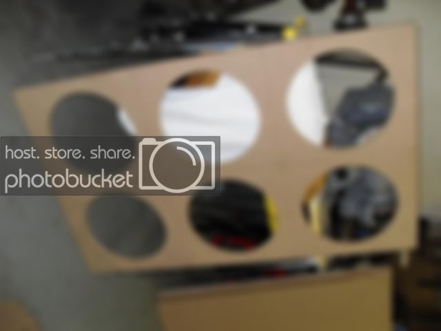

First front baffle getting cut (love the jasper jig //content.invisioncic.com/y282845/emoticons/biggrin.gif.d71a5d36fcbab170f2364c9f2e3946cb.gif)
2nd front baffle done
more to come:)

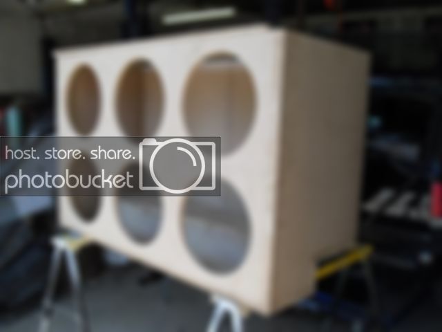

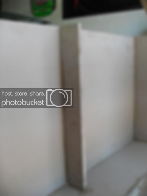

Pic of 1 end and front going onBack of box going on
That's all for today, Have to go pickup my kinetiks for my blazer build:veryhapp:

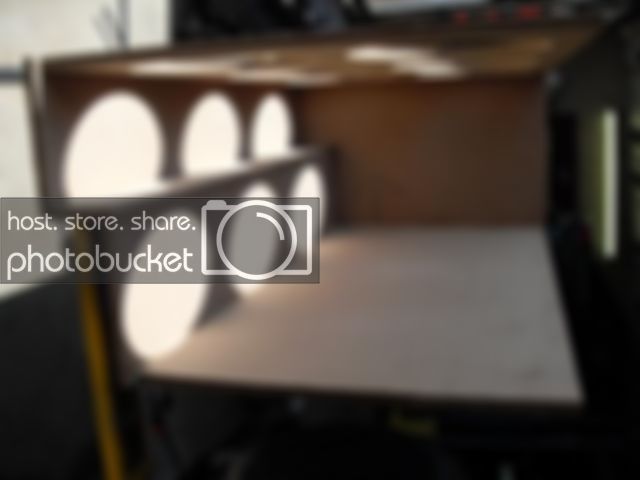

i didnt notice the cutouts in the top at first. i saw the shadows and thought those were the holes. i was going to say, i dont think the subs are going to fit in your holes. //content.invisioncic.com/y282845/emoticons/laugh.gif.48439b2acf2cfca21620f01e7f77d1e4.gif
Yah tight fit:laugh:
