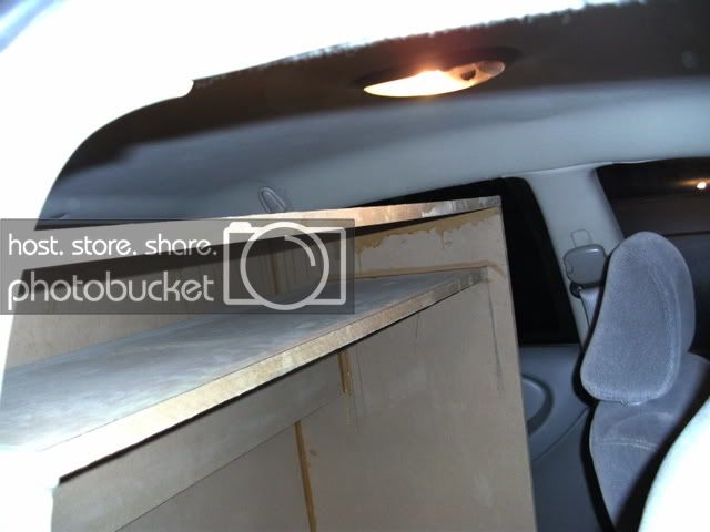

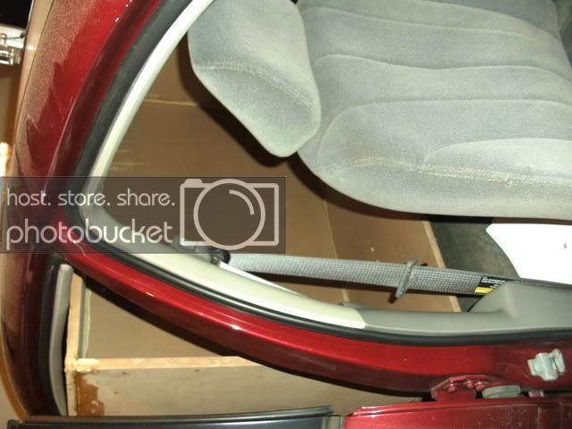

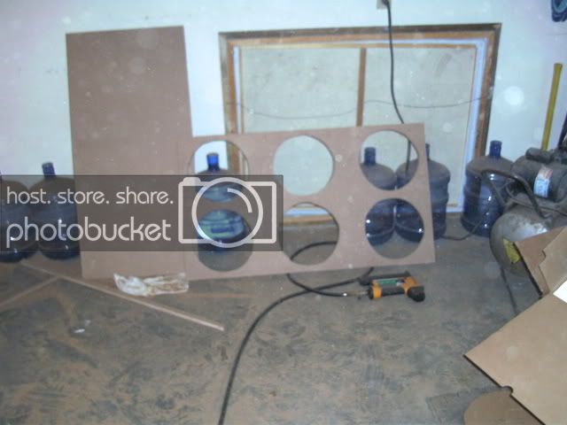

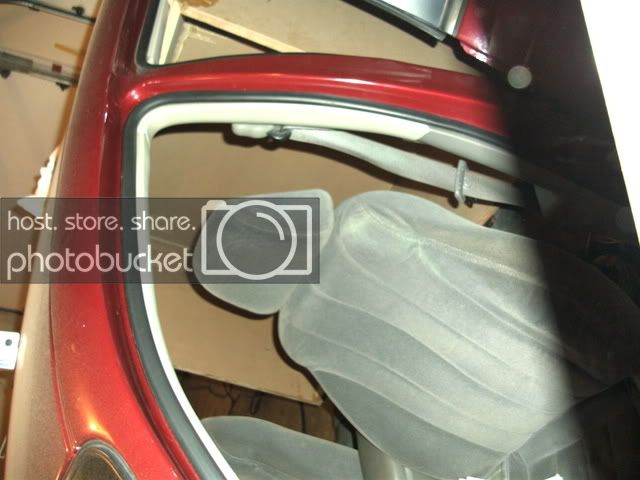

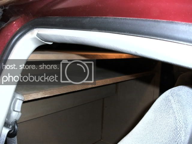

Well got the box done. Anyways we played around with it today, is quite ****ing loud, I have a head ache as we speak. No vids as of yet, trying to avoid the "flex" vids, as my car does not flex. None the less it is loud as ****. There are a couple of issues that need cleared up though, mainly the trunk. I have it sealed off very good, but somehow there is enough air moving back there that the trunk rattles like the system is in the trunk :shock: I am pretty sure I can get another 2 or 3 db's out of it, when I get the issues addressed. Also port came out to 194sq inches //content.invisioncic.com/y282845/emoticons/crazy.gif.c13912c32de98515d3142759a824dae7.gif
did you build the box inside the car?
To a point no, but in the end yes. It turned into a pain in the ***:crap: In case anyone was wondering yes the face is double baffled, and when it gets a little warmer I am going to hit the interior of the box with some resin. Had three people check it out today, everyone was smiling:)
