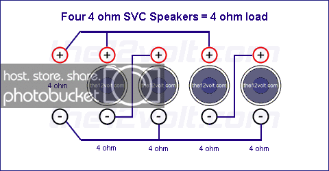

4OHm? hope you can tell me if this is correct...
You could just run each individual wire to the amp. //content.invisioncic.com/y282845/emoticons/fyi.gif.9f1f679348da7204ce960cfc74bca8e0.gif instead of trying to link them, unless your trying to cut down on teh wire usage.
thanks misfit and worst...and to misfit thats what i had in my original post....just was wondering if there was any other way but i can wire them up like thatthanks guys.
i was wanting to see if i could do this ....
http://a248.e.akamai.net/pix.crutchfield.com/ca/learningcenter/car/subwoofer_wiring/4SVC_4-ohm_2ch.jpg
these are the ratings on the amp i got
# 100W x 2 @ 4 Ohm
# 125W x 2 @ 2 Ohm
# 300W x 1 @ 4 Ohm
There's no reason why you couldn't wire each pair @ 2 ohms and use a 2 channel. It'll work out just fine...
