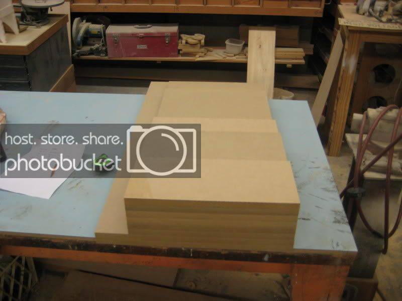

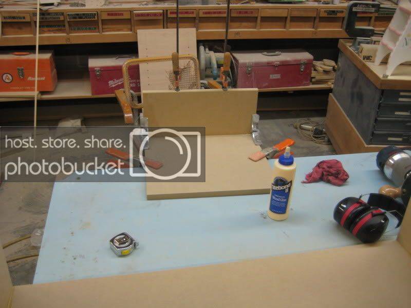

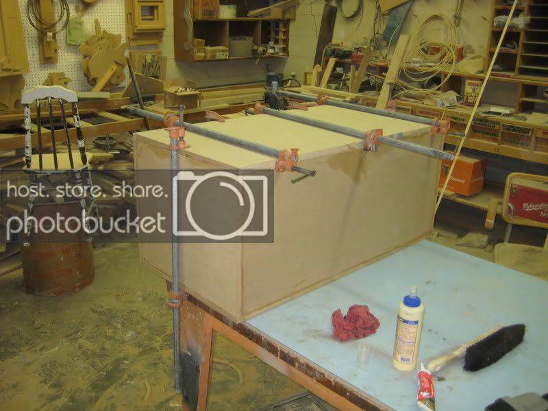

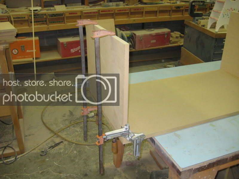

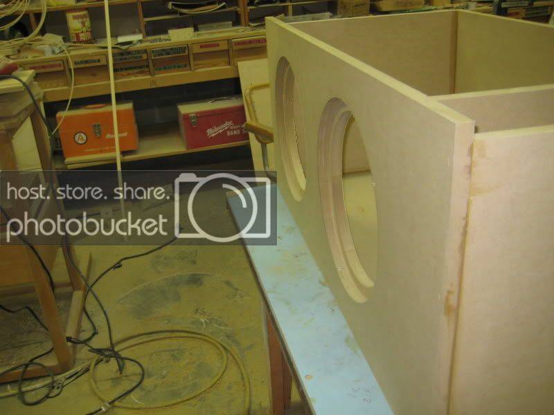

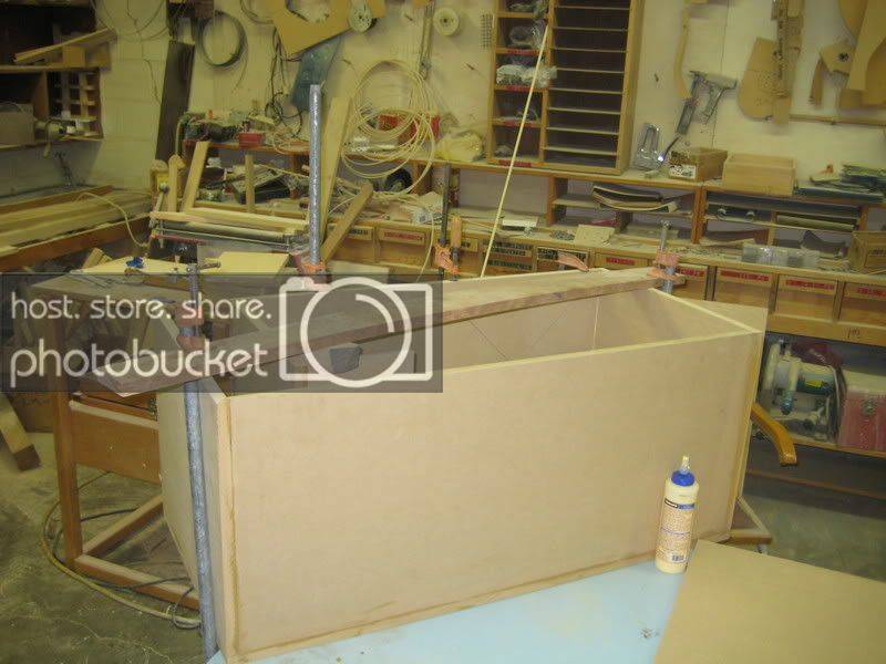

This is for 2 12's not sure what kinda of subs. Flush mounted 4.5 cubes @ 35hz anyways pics:
Wood Cut:

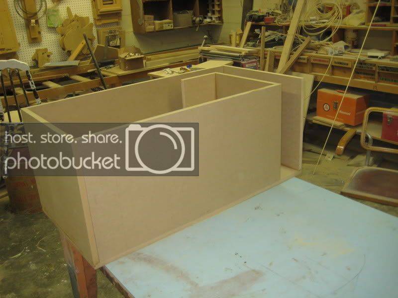

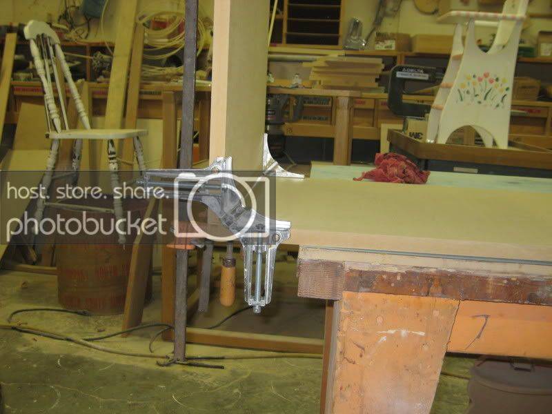

Sides:

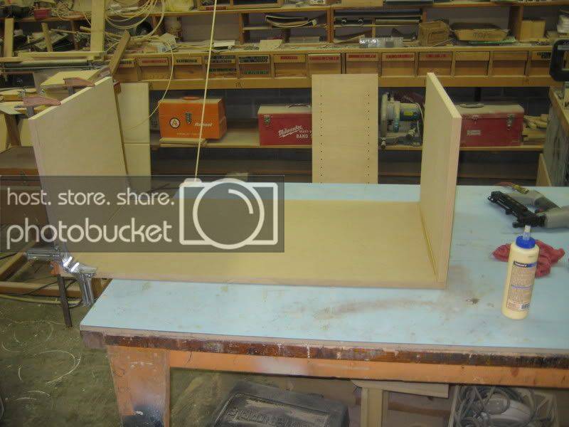

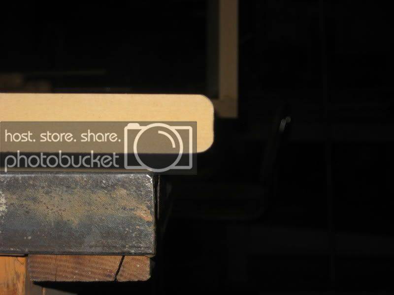

Rounded Port:

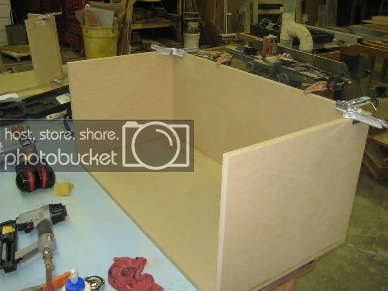

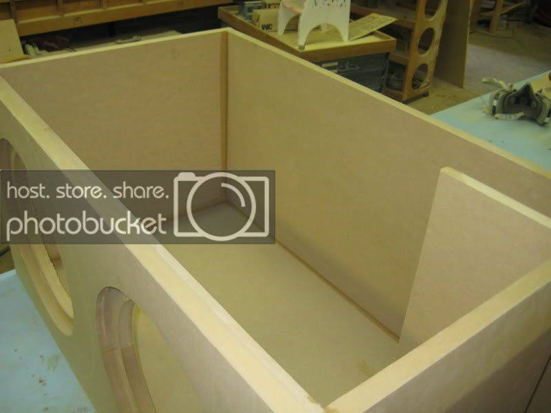

Sides and back:

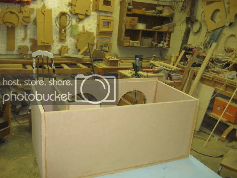

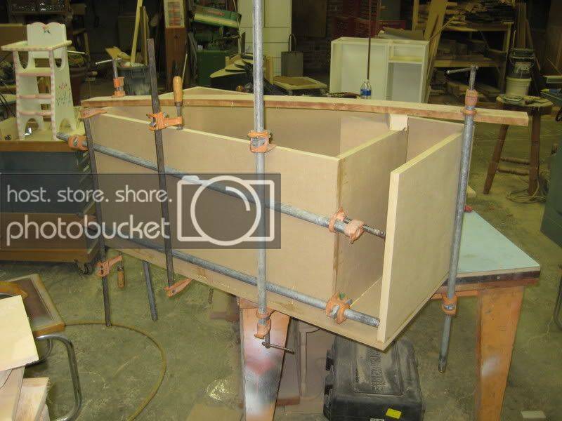

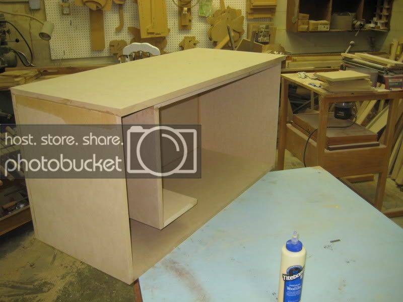

Front and Port:
Nice lookin' box...
Thanks man
Looks about the exact same as mine lol.

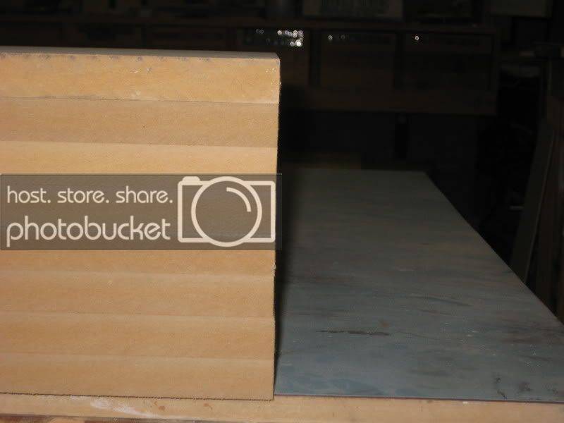

1/2" though? (cept baffle)
Nope 3/4" all the way around including the baffle.
Thanks
Looks good. I like the flush mount.
Yeah its a nice lit touch
is it just me or did you cover up the port? isnt that a problem? lol
It gets a hell of alot louder!
im sure its gonna be cut out lol.. instead of having the extra gap with the face being 3/4 of the way out instead of flush..
very nice box man..
Thanks man
