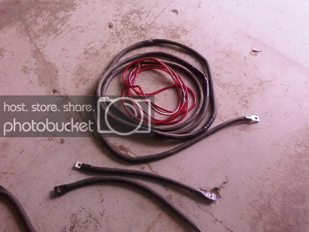

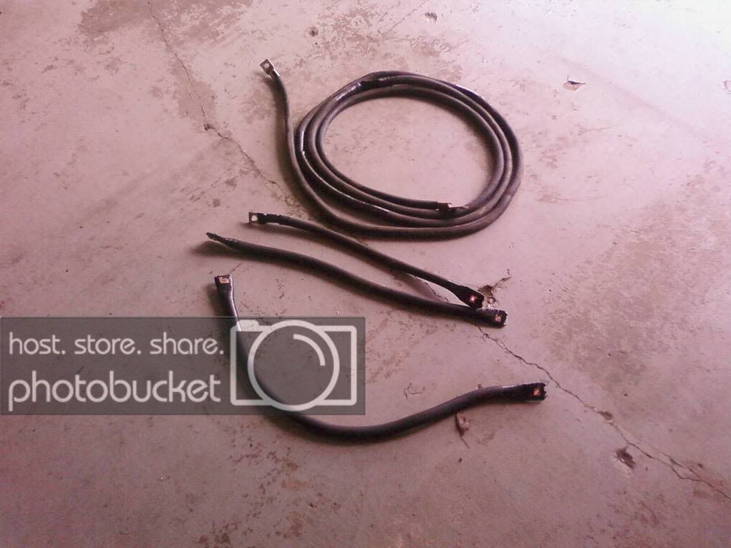

4/0 big 3, power and ground made
lincolntc690
thats 4 awg in the middle, for crimp ons i used 3/4" copper couplings.
i flattened them over the ins. and wire, i used a punch on them to hold better, then drilled thru works great, and saved a few pennies:)
4/0 is half the resistance of 1/0, which means half the voltage loss, and while pulling 300+ amps that can mean .1+ volts

i have to agree. for the the big 3 thats just a waste of time/money. for power wire it may be needed when you upgrade to two 2500d's.
for now, u ever heard of adding on?? so when i add another 2500d i dont have to run multiple runs, easier to just do 1 wire.
