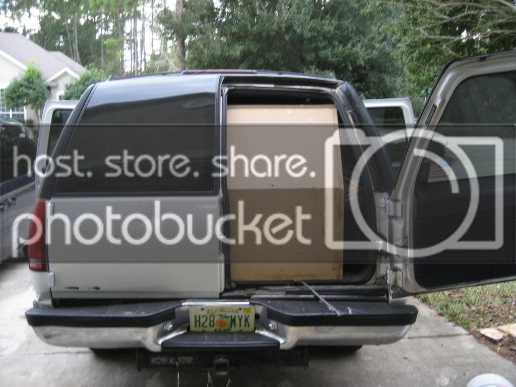

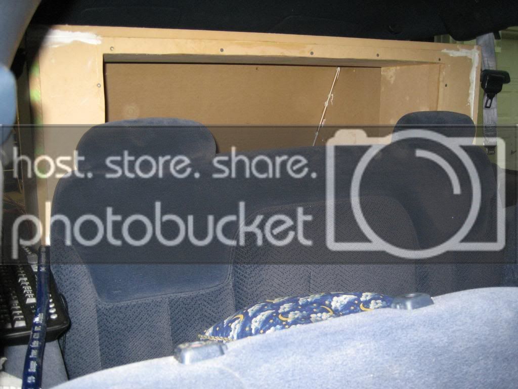

3rd row seat build.
I build one for a buddy of mine to go in the back of his tahoe with the third row seat up, and it came out to be 3.5 total int. cu feet total, so it was .5 cu ft for the port and 3 cu feet for the subs... box demensions are 48" wide, 20" tall, 7" deep on top and 10" deep on the bottom... He put his Kicker CVR 12's in it with a 900 watt amp and it was slammin pretty hard, I was impressed. Here are some pics of the box...
http://i160.photobucket.com/albums/t195/05gliguy/040607_1141.jpg
http://i160.photobucket.com/albums/t195/05gliguy/040507_1854a.jpg
