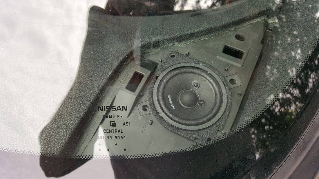

Yes sir. I'm running wideband 2.75" drivers in the dash, actively crossed over at 1.25 kHz.
Ah, that would explain why. Horn drivers....are they Image Dynamics?
Haha... No, not quite. I wish. I'm just using some cheapie Memphis PRX27 cone drivers. They replace the stock nasty 2" cone tweeters that were crossed over at 8 kHz.
Well, I call them "cheapie", but they aren't half bad, and definitely tons better than the stock crud. They actually get some decent vocals up on the dash now.

This is what I have...

I'm just using stock locations, no cutting or fabbing in this car. Also, being fully active and the ability to tweak time alignment, it's not too bad. And all of this tuning is just by ear. I use REW software to measure and tune my home system (which is also fully active via a dbx Driverack Venue 360). One of these days, I'll bring the laptop out to the car and do the same to compare to what the Pioneer will be able to do on its own.

You'll never sound "good" out of those. 3" "full range" drivers might work at very low power/output levels (full range drivers in general is a debate) but trying to overcome the noise floor in a car at highway speeds you won't do much.
Simple solution is to see if you can find Q-form kick panels for your vehicle, they are very easy to plug and play some proper fronts. Get some mid-tier components or coaxials and call it a day.

I wouldn't say that. As it sits right now, I'm getting pretty good sound from this simple system so far. Granted, it's nowhere near the caliber of my active Martin Logan system here at home, but it's not bad either. And it's a heck of a lot better than the factory Bose system.
I'm just running these little drivers in the dash @ 1.25 kHz, the stock base door speakers from 40 Hz - 1.25 kHz, and the Pioneer head unit. With the little bit of Dynamat, Hushmat and Wave Breaker that I've installed, this little setup does pretty good at highway speeds.
Of course, I plan on upgrading the drivers in the doors, adding a 5-ch amp, a sub or two, and more dampening. Again, this system isn't for show or comp. It's just for me, but I want it to be flexible and sound good.

At least consider 3" coaxials for that factory hole? Going without tweeter just seems like the weakest link here.
