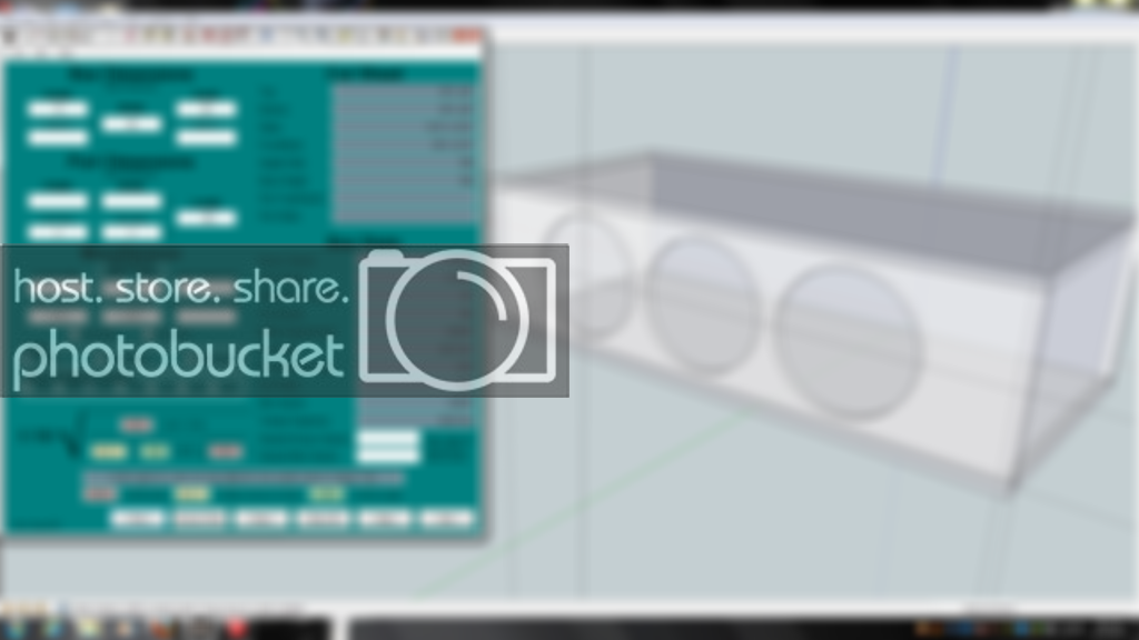

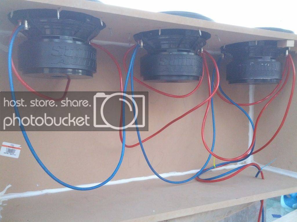

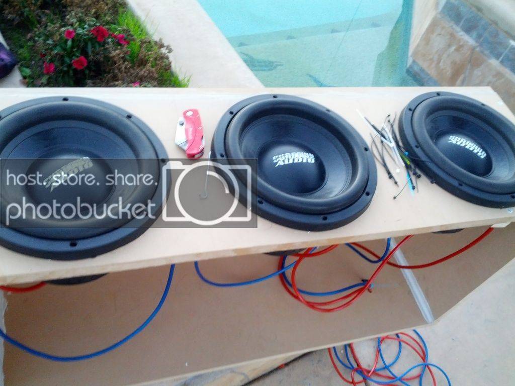

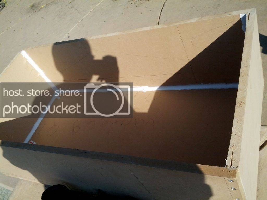

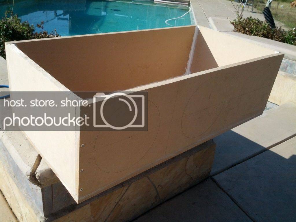

i built a box for three sa-10s subs sealed with 5.15cube b4 displacements and was looking to use aero ports tuned to 32hz
with torres it says to use two 4in diameter 10in long.
my question is will this cuz alot of port noise?
and where would be the best place to place these?
is it better to use more than 2 ports? or 1 big port?
and the box is in a trunk of a 86 volvo.
the power is about 1000wrms.
