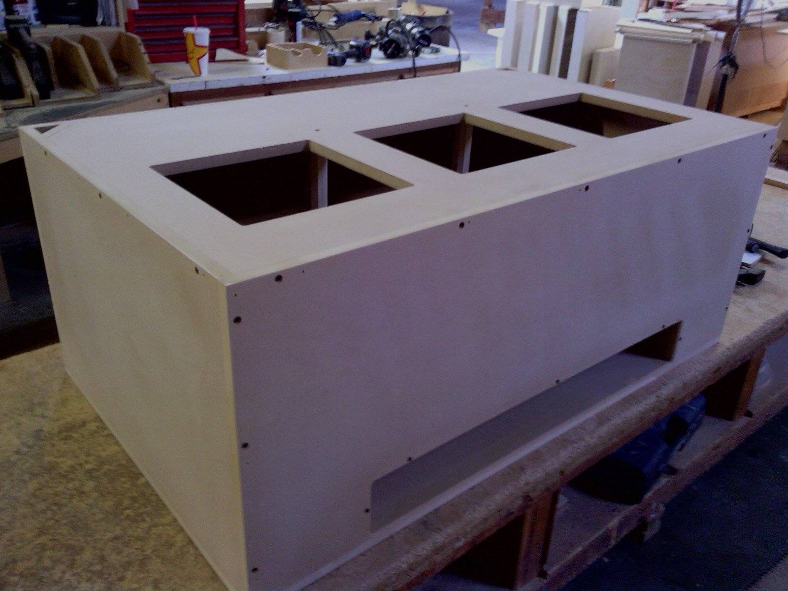

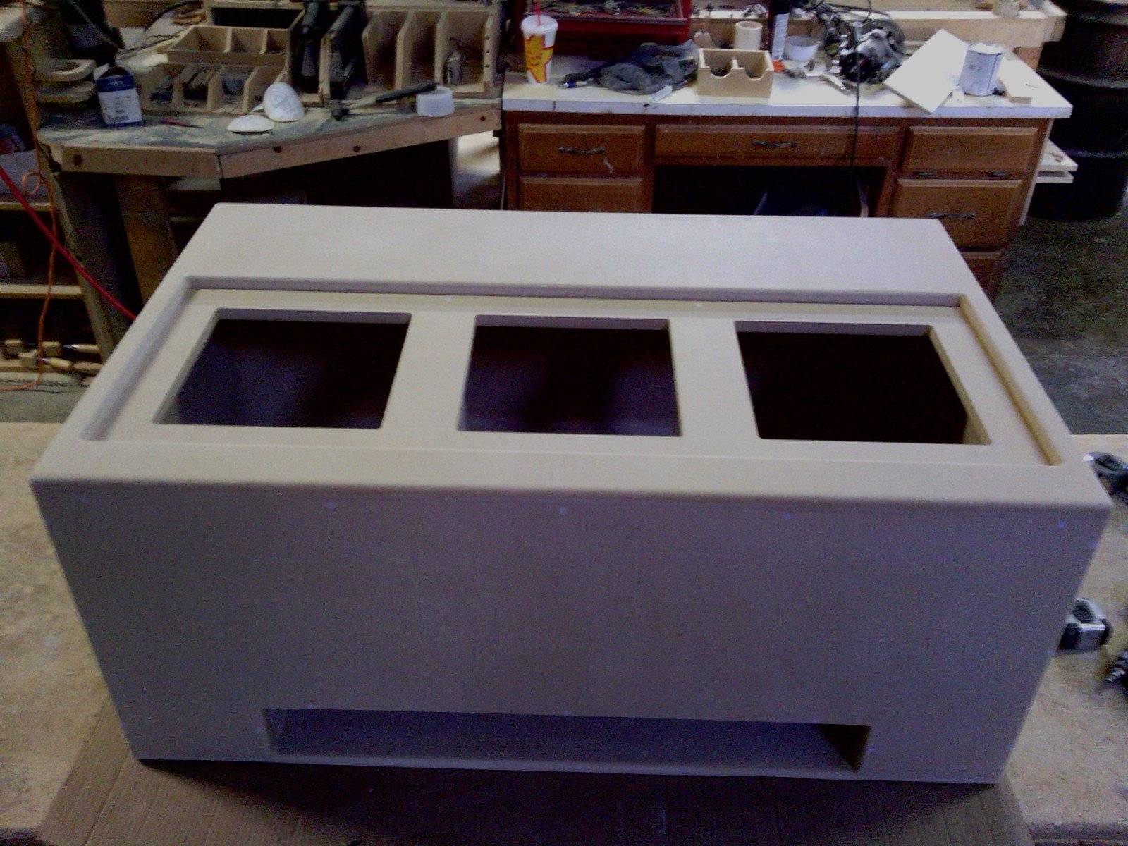

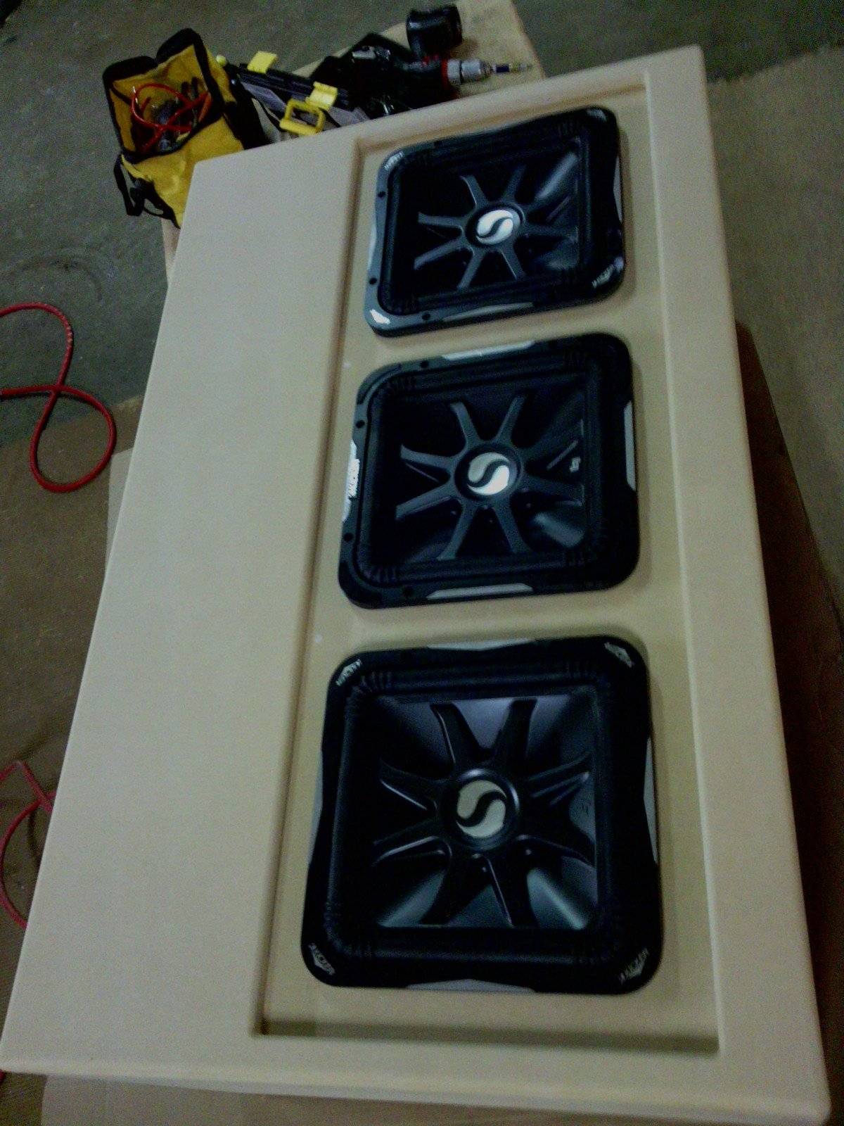

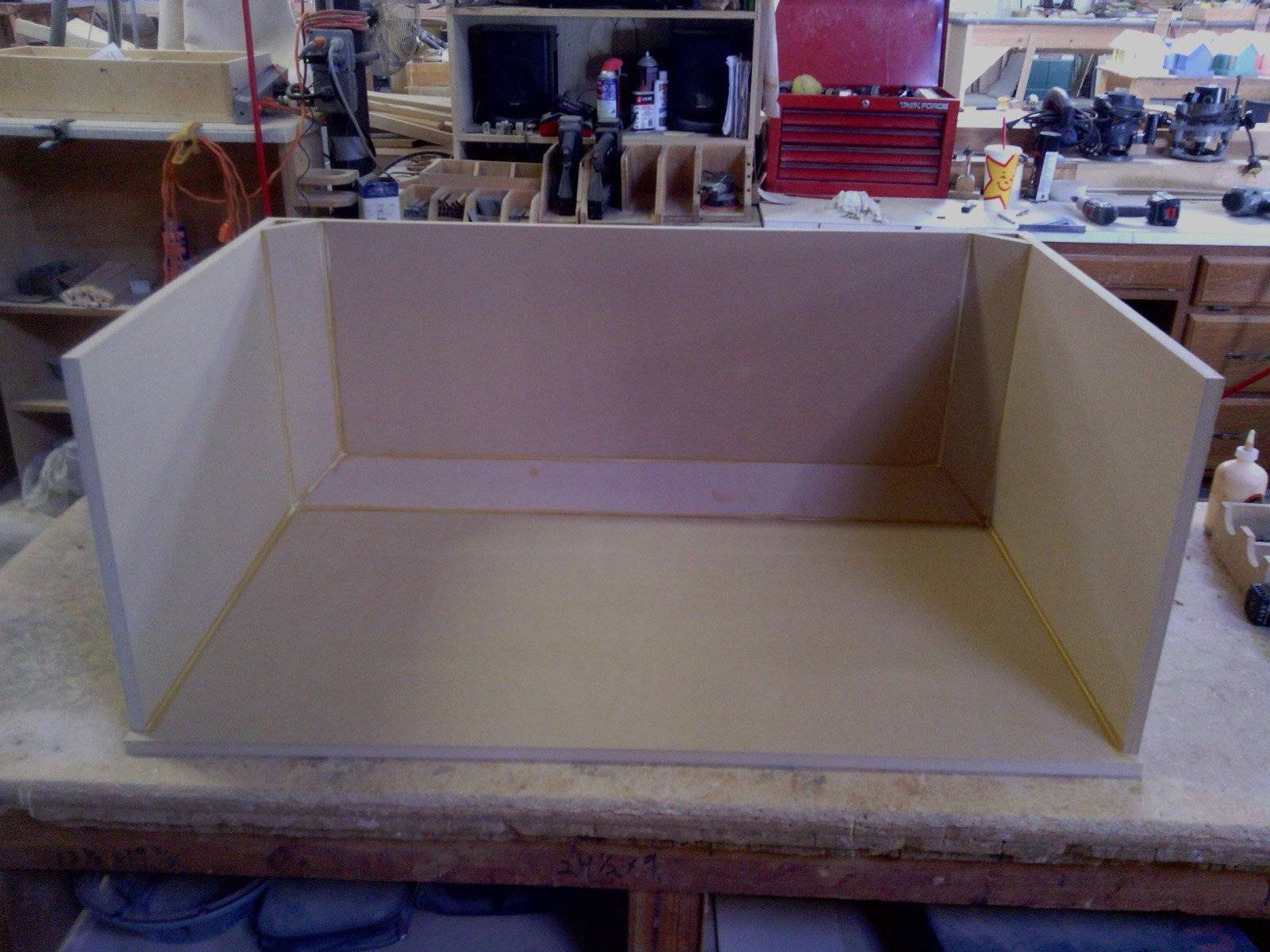

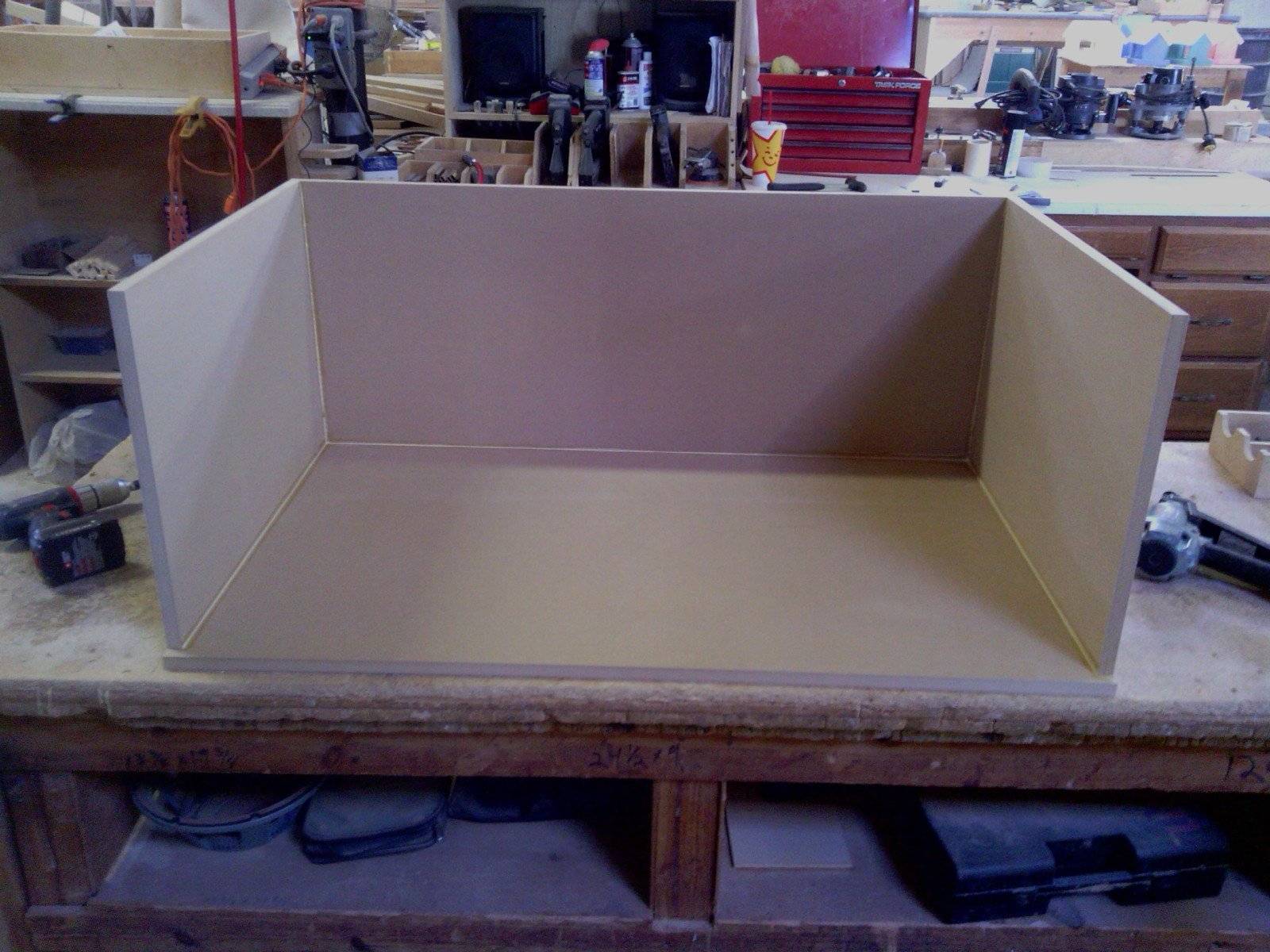

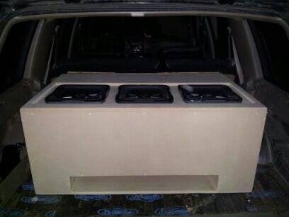

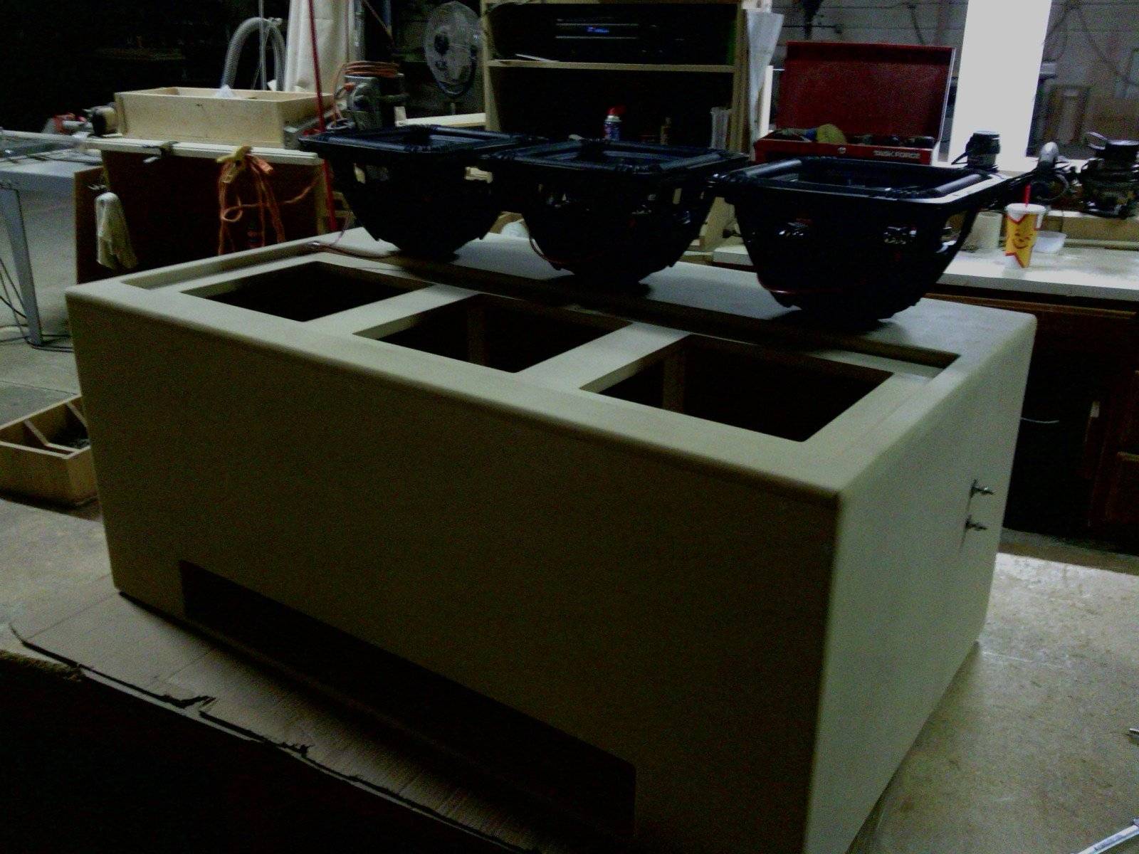

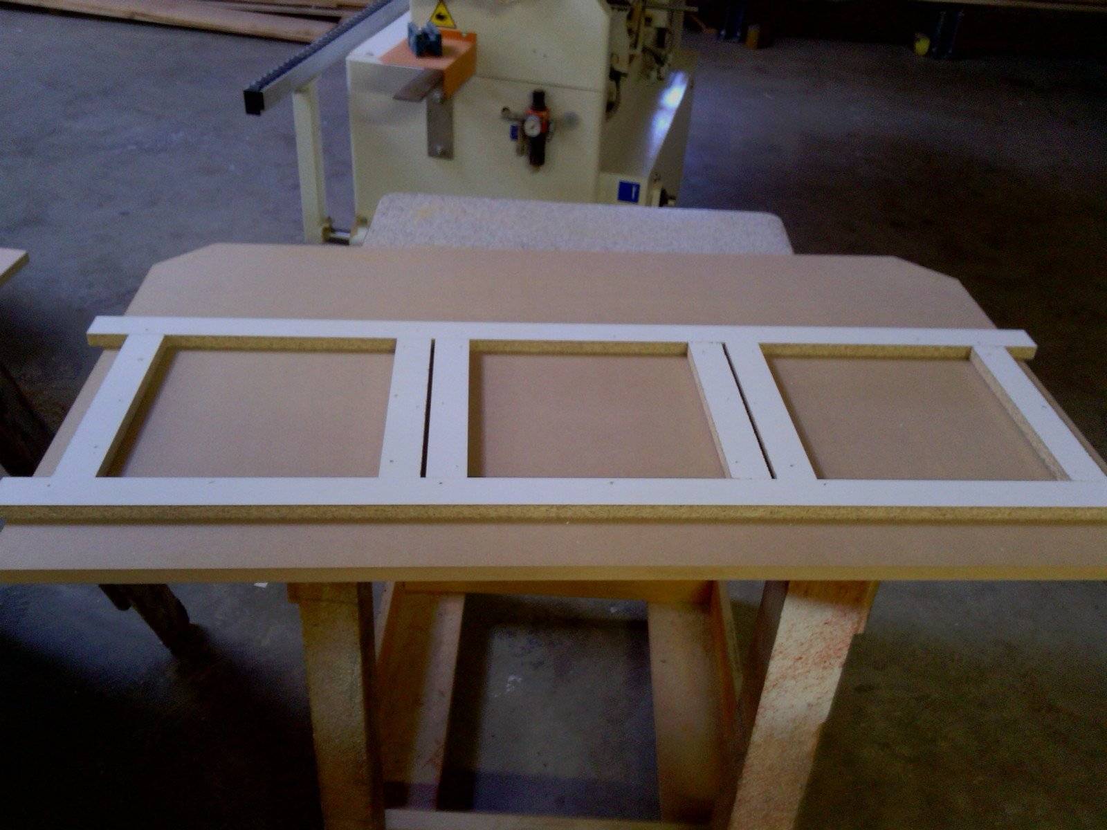

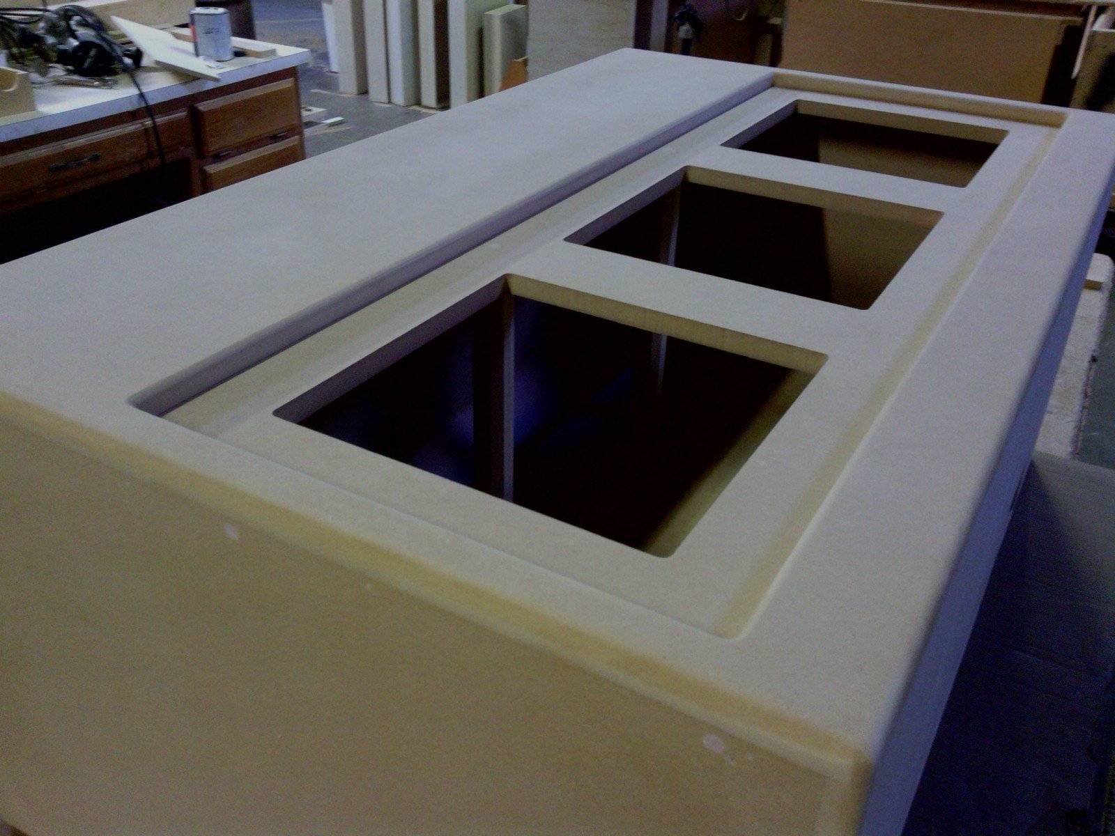

I'm building a box for 3 Kicker L7 12's for a guy locally.
It's going in a Tahoe powered by a Fosgate 20001bd.
9.75ft^3 tuned to 34hz designed by myself.
Here's some pics.

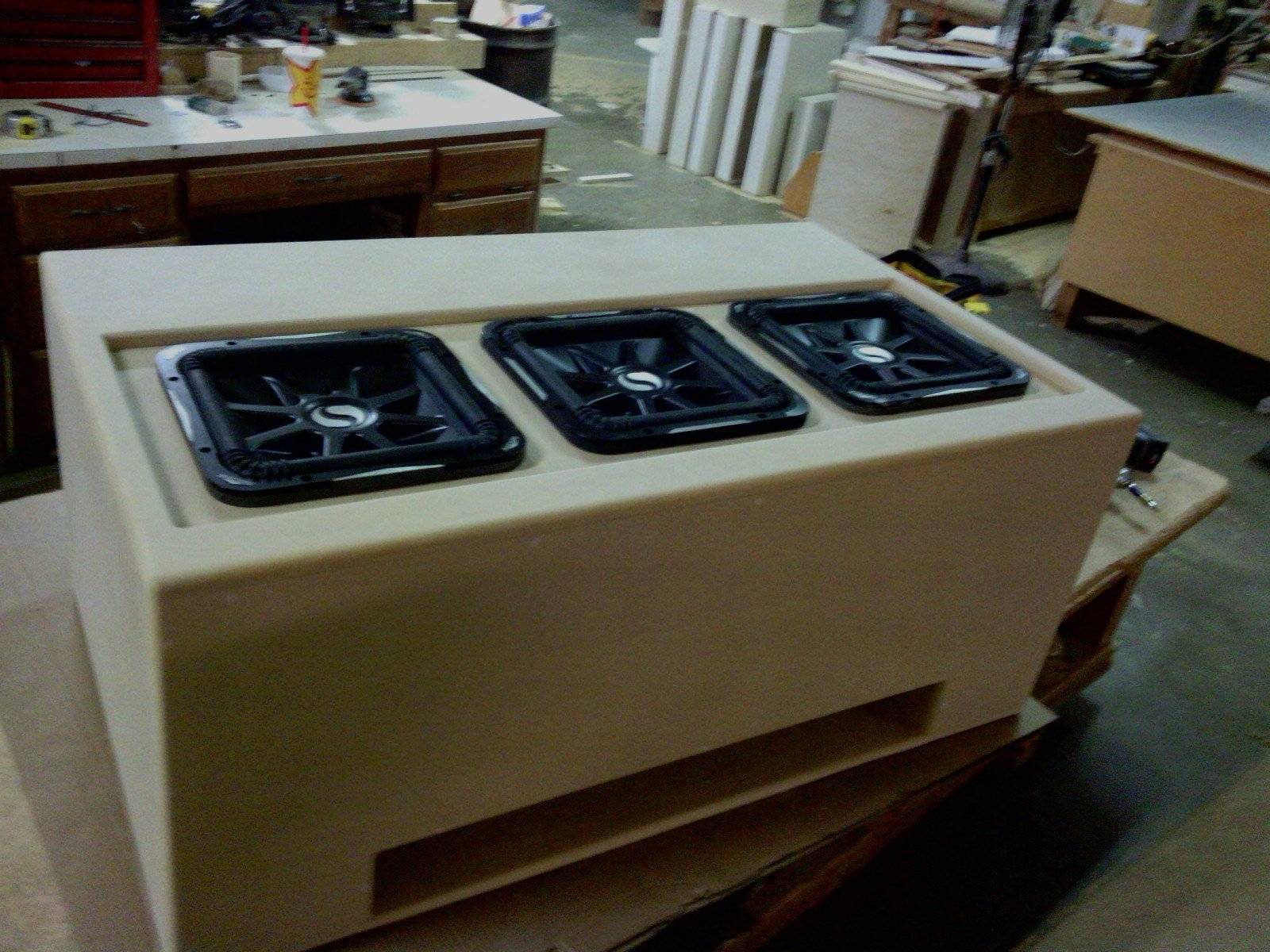

Good start man. Should be loud for sure. I miss my squares . People dont like how they sound but I never felt they sounded as bad as most people would lead you to believe.
I was surprised how good they sounded.
The guy said it was like day and night compared to his other box, and I'll be getting more work from him;)

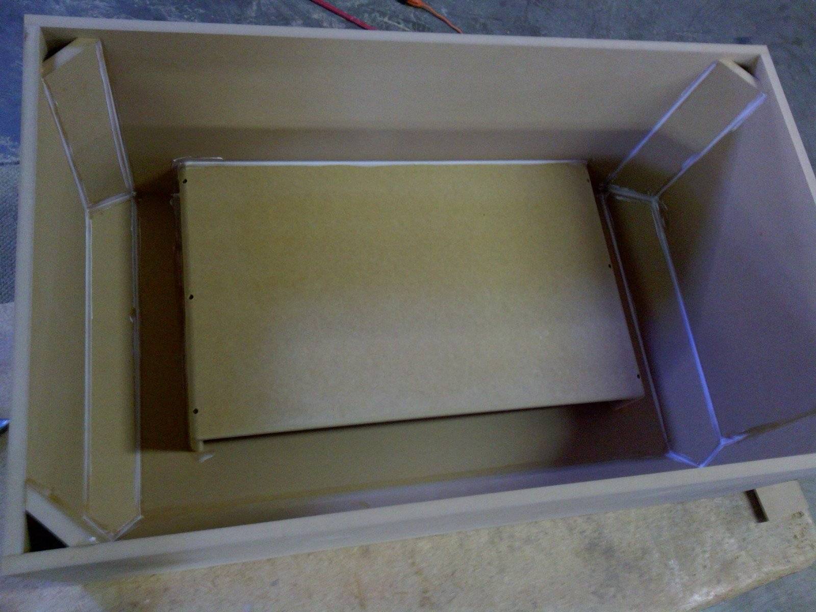

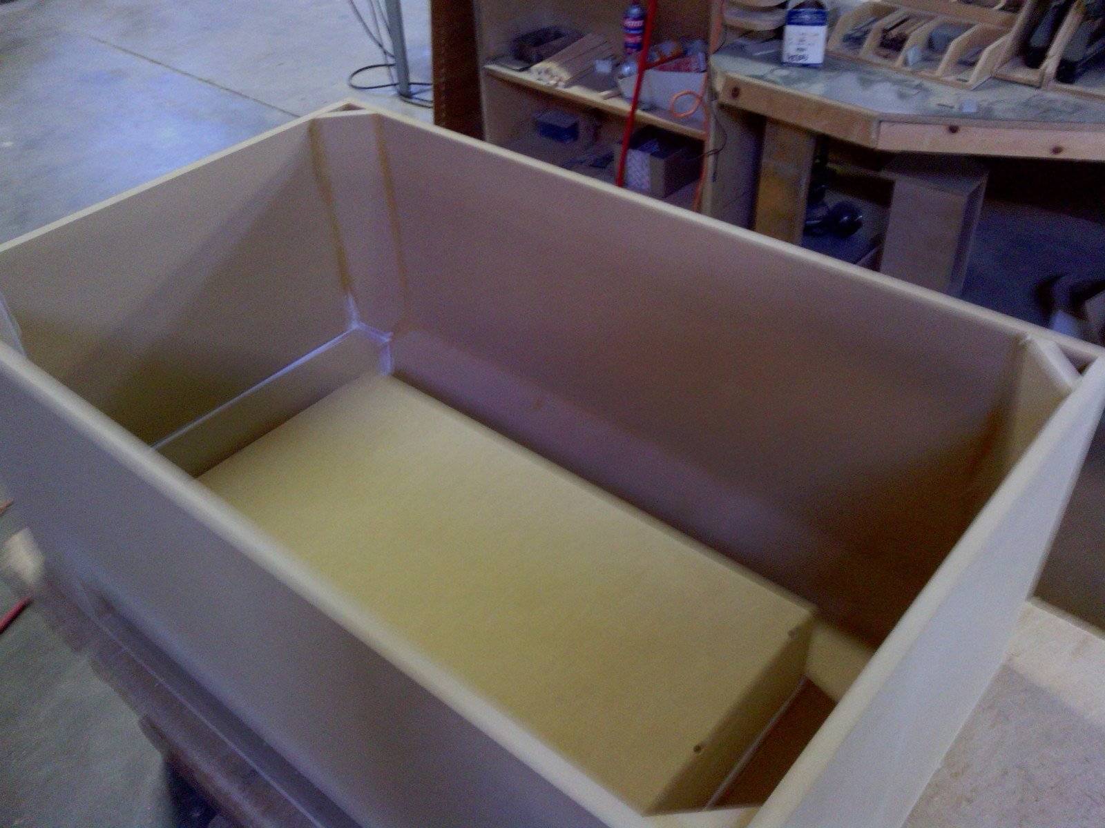

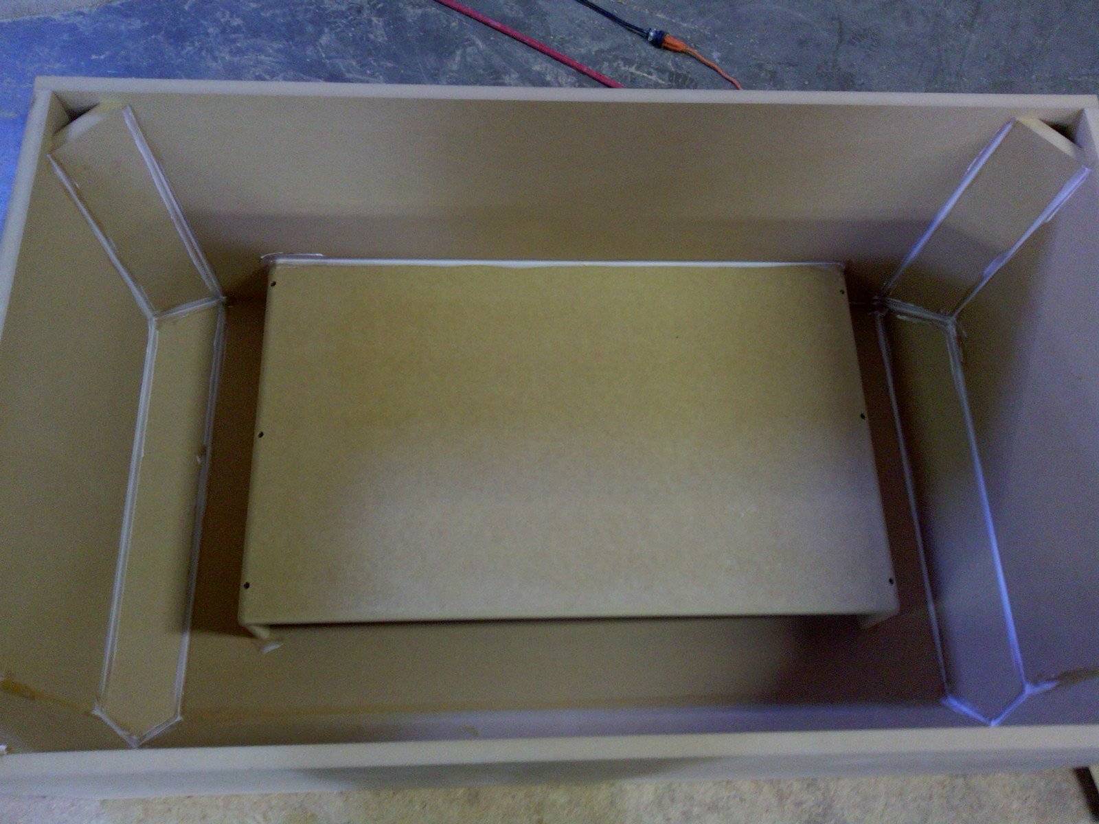

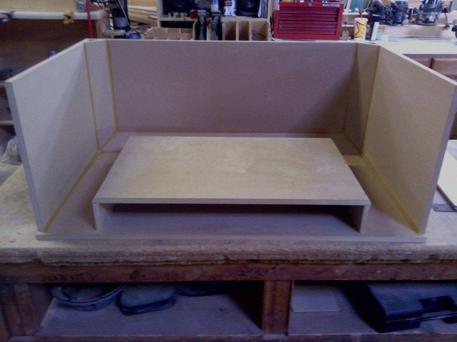

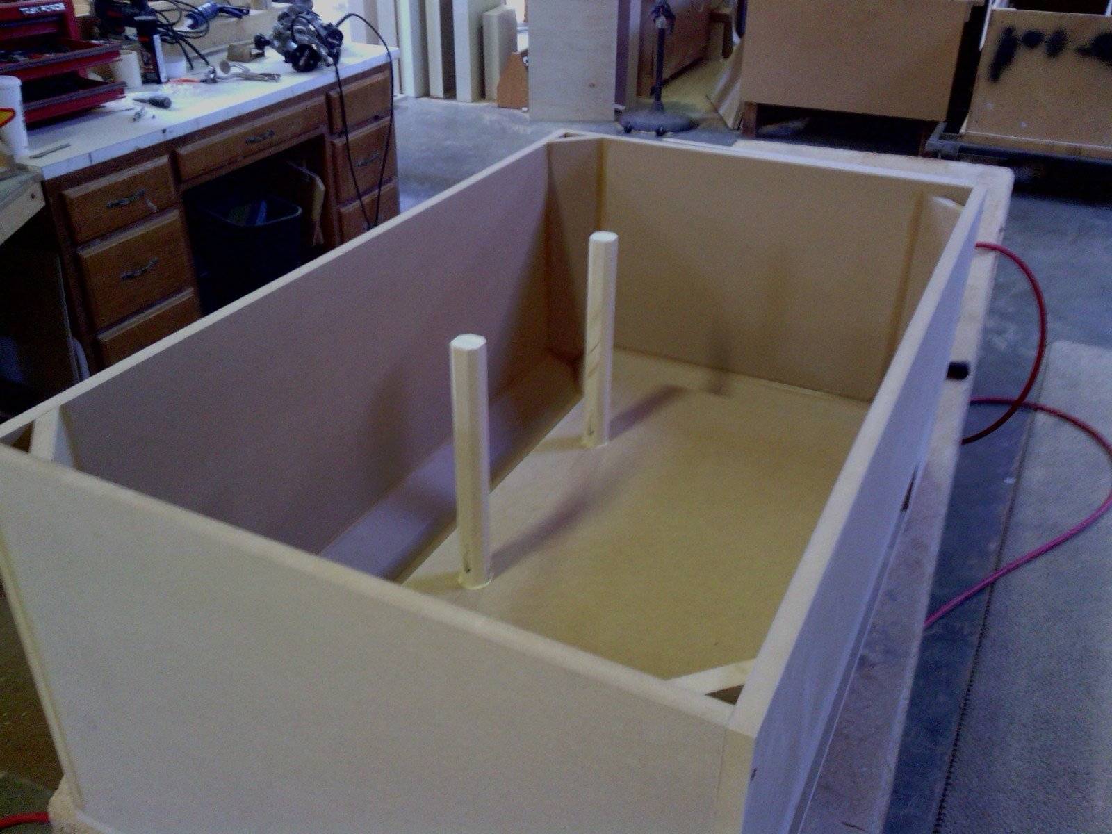

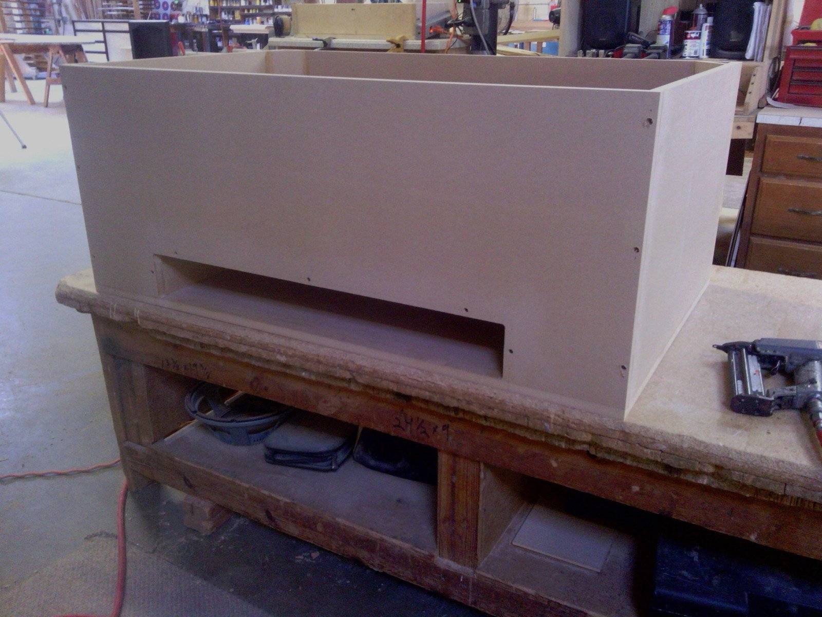

Do you just use glue, no nails or screws?
Titebond II, 15 gauge brad nails to line up, countersunk #2 square coarse thread pocket screws to squeeze tight. silicone caulk on inside joints.
Pretty much overkill...all you need is glue and clamps.
