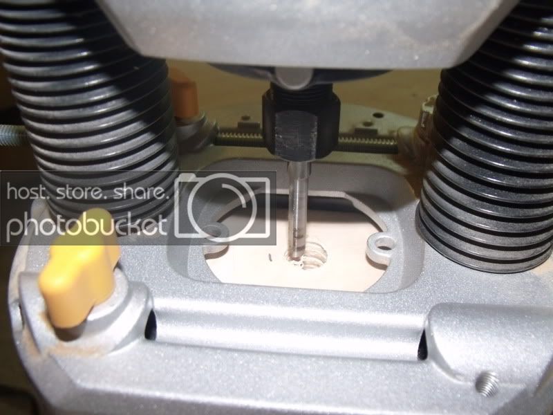

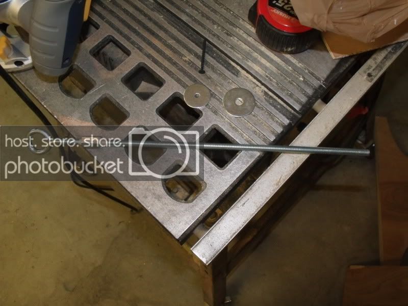

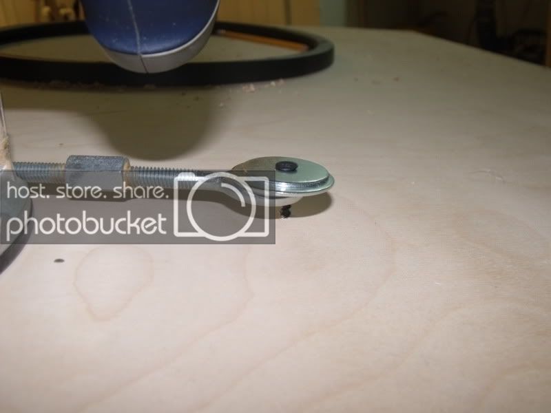

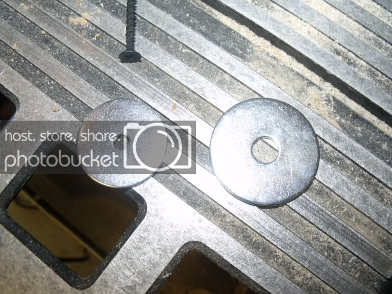

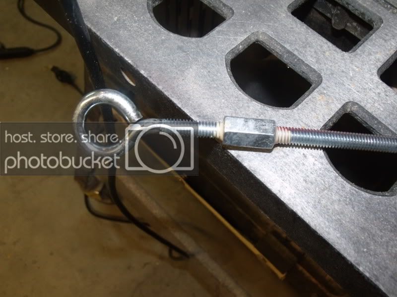

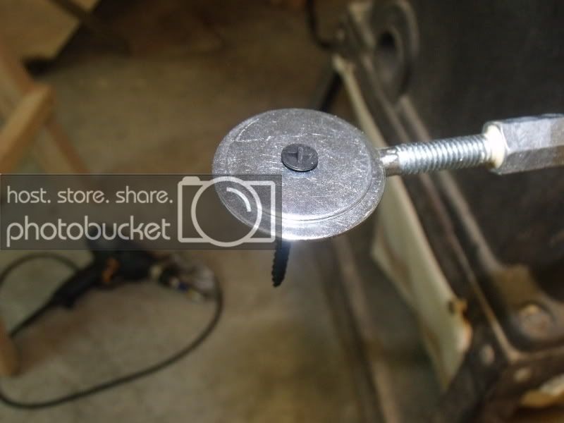

i guess it is kind of hard to explain. basically the screw makes you maintain constant tension. Wont allow for much movement. just goin in a circle. heres a Video and two pictures of how it works.
I suppose it would but it hasnt cause an issue the way it is. and i havent seen a wood screw that isnt threaded all the way. also havent looked for one lol
There are some screws at Home Depot, with the purple label, that have a smooth area under the head...uses a square bit.
