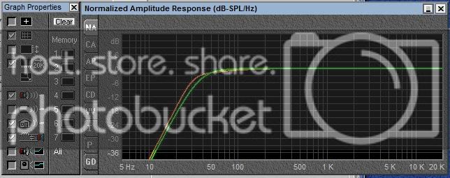

Originally Posted by Autiophile View Post
Ask and you shall receive:
From Magnetar over on DIYaudio.
Using 250 grams "mass loading" method and LIMP this is pretty much where they all average-
FS - 31.61
RE - 5.59
RES- 59.81
QMS- 4.03
QES- 0.38
QTS- 0.34
L1- 1.88
VAS - 274.29 liters
SPL - 95.4
I cant verify the validity of these just wanted to pass them along
green is optimal
orange is 'Xbass'
assuming his measurements are accurate
