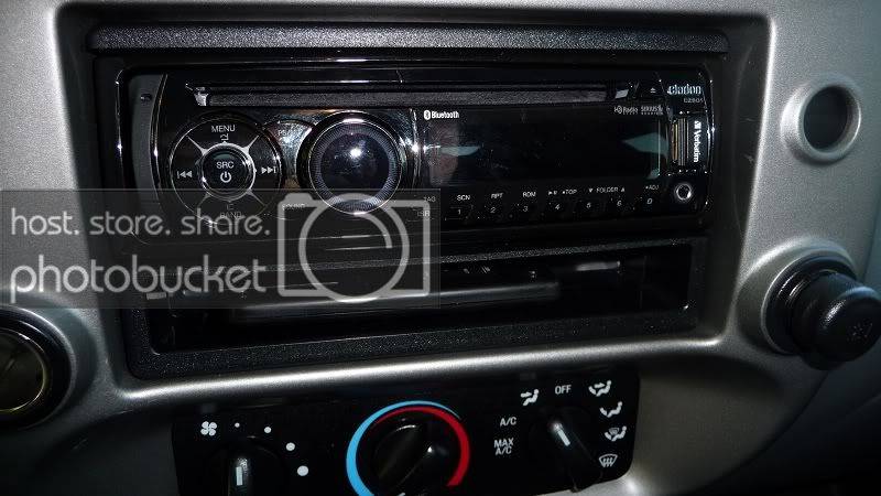

The Source Unit: I got a fantastic Black Friday deal on this deck, Clarion CZ-501 and its pretty much loaded with all the features that I wanted: 4v pre-outs all around, Bluetooth hands-free and audio streaming, iPod/USB input, front Aux, XM, HD radio etc. It also looks good, in my opinion, a classic overall feel to it. Also, see the absolutely tiny USB thumb drive on the far right side? That’s a neat 16GB unit loaded with music!

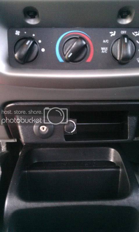

Bass knob: Below the deck and A/C controls I mounted the Alpine RUX-KNOB to quickly control the sub level. I love bass knobs!

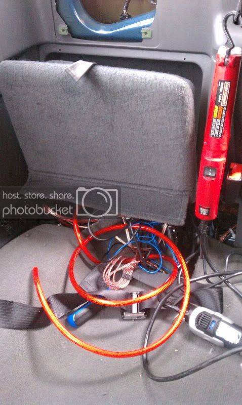

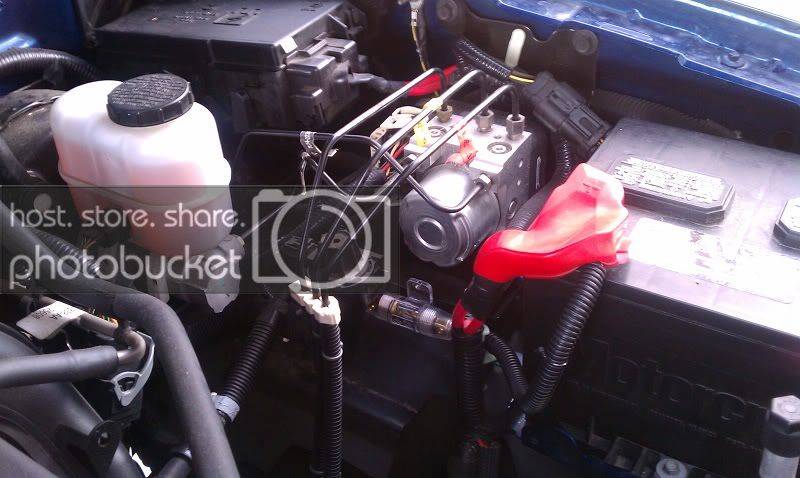

4 gauge power cable. I spent a few extra minutes and made sure all the wiring looked as stock as possible.

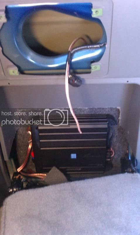

I mounted the Alpine MRX-V60 amp behind the driver's side rear jump seat. It fits so well the seat can still fold up 100%. I normally leave the seat down to ensure the amp stays plenty cool. Which it usually does, it’s a very efficient amp.
You'll notice I had to trim the plastic up a little above the amp to fit it properly. This area is almost never seen, which is how I like it.

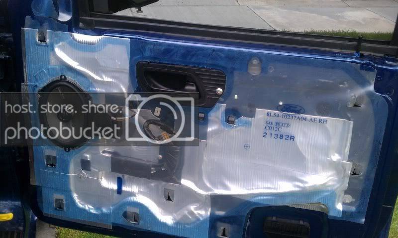

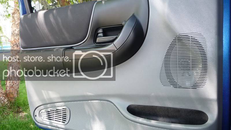

For the front stage I selected the JL Audio C2-570x, these fit perfectly into the stock location. I used some sound deadening close to the speakers and covered most of the large holes. (Also not pictured is the fact that I used the sound deadening material and constructed a weather shield above the speaker so any water drops will run down and around the speakers rather than dripping onto the speakers themselves) Then I re-attached the plastic moisture barrier for good measure.
The C2-570x noticeable behind the grill. These speakers have a pretty good offset on the silk dome tweeters, really helps the overall imaging without modifying the door panels.

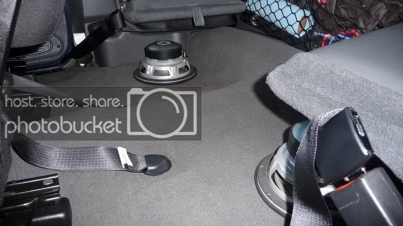

I decided the safest route was to down-fire a pair of JL Audio 8w1-4 subs. This shows the general idea, and just how little room I had to work with. The front seats are pulled all the way forward.

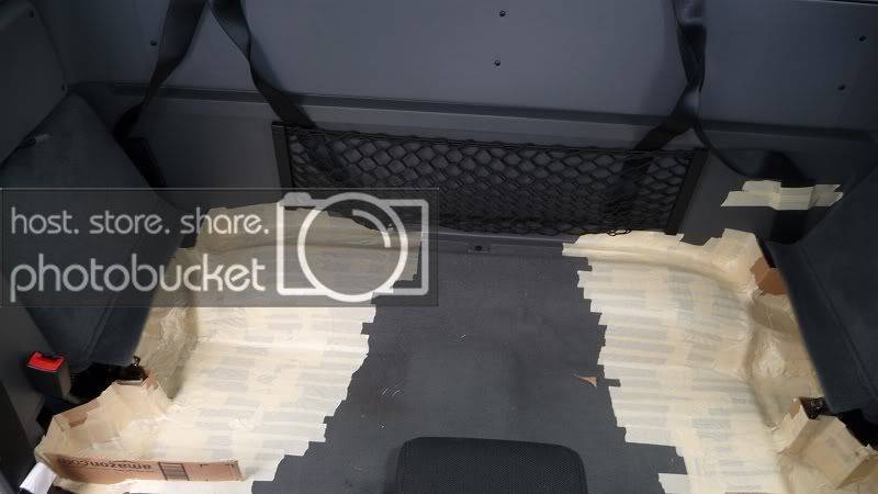

The only way to maximize every square (and cubic) inch was to build fiberglass enclosures. I have never worked with the stuff before, so I knew I was in for a ride. I first removed a small plastic panel under the rear jump seats that cover up their hinges and seat belts, and then proceeded to tape up the area. I used cardboard to define the area under the seats and around the hinges.

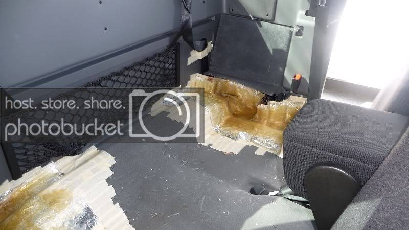

The first few layers. It took me a few layers of playing with fiberglass and resin before I figured out how to work with the stuff. I learned to dab rather than brush the resin into the fiberglass mat. Also, that stuff stinks something fierce!

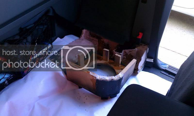

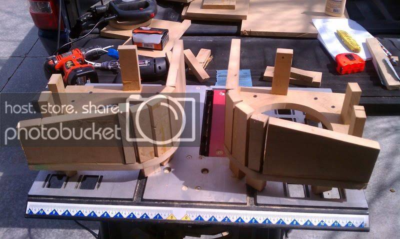

Dry fitting the MDF portions. I placed 8 feet, in pairs, around the bottom baffle to keep the enclosures propped up. I added bracing for strength and to help keep the fleece from sagging later.

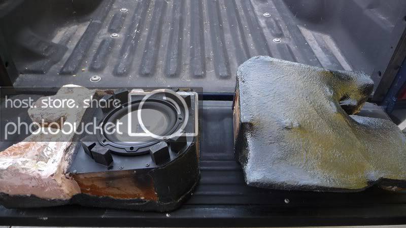

After adding a few more layers of fiberglass and building the mdf portion, I joined the two halves together in place using fleece and resin. I also used fleece and resin to round the curve in the front. I then sealed all the mdf with silicon.

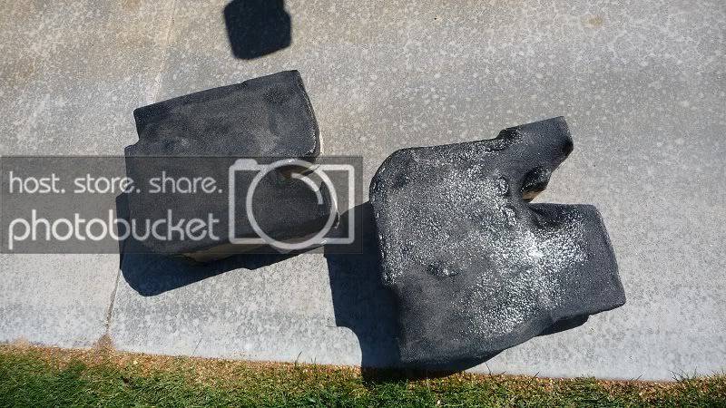

After strengthening and sealing the joint between the two halves (using, fleece, fiberglass, resin, and Bondo) I then wrapped them in fleece and applied liberal amounts of resin.

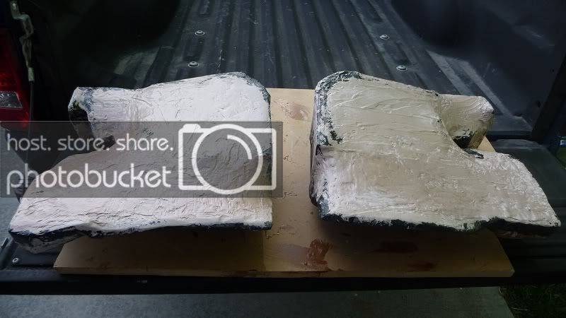

I then added more fiberglass and Bondo both inside and out. These things became increasingly ugly and became affectionately known as "Mr. and Mrs. Frankenbox". They may be ugly but I made them air tight and tough enough that they should survive the impending zombie apocalypse.

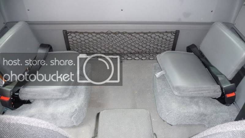

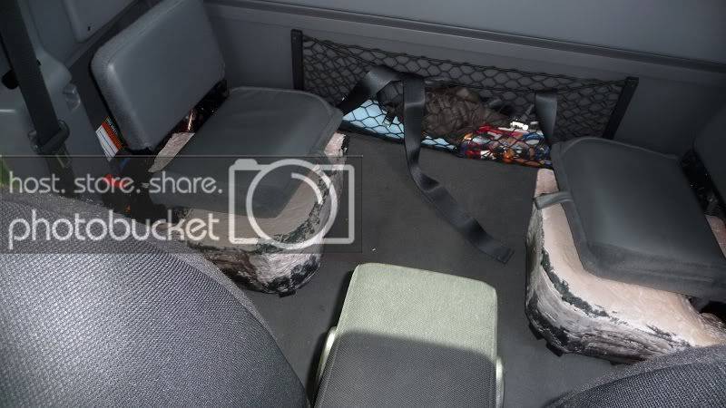

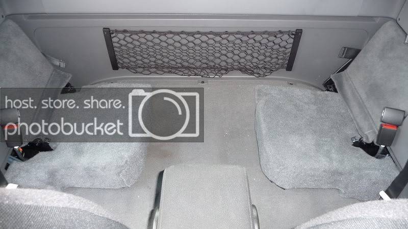

A local shop had some carpet that was pretty darn close, so after dressing them up in carpet, I installed the subs and added a small amount of fiberfill and wired them up to the amp (2 Ohm load) Pictured with the jump seats up.

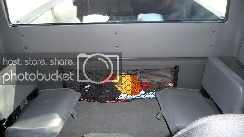

Final resting place with the seats down. This is how it looks most of the time.

Thanks! The subs are getting pretty darn close to their recommended .38 cu ft, give or take .02 cu ft. ( They' actually aren't perfectly symmetrical opposites, I made the passenger side box slightly thinner and longer to make it a little easier to get in and out of the back)
