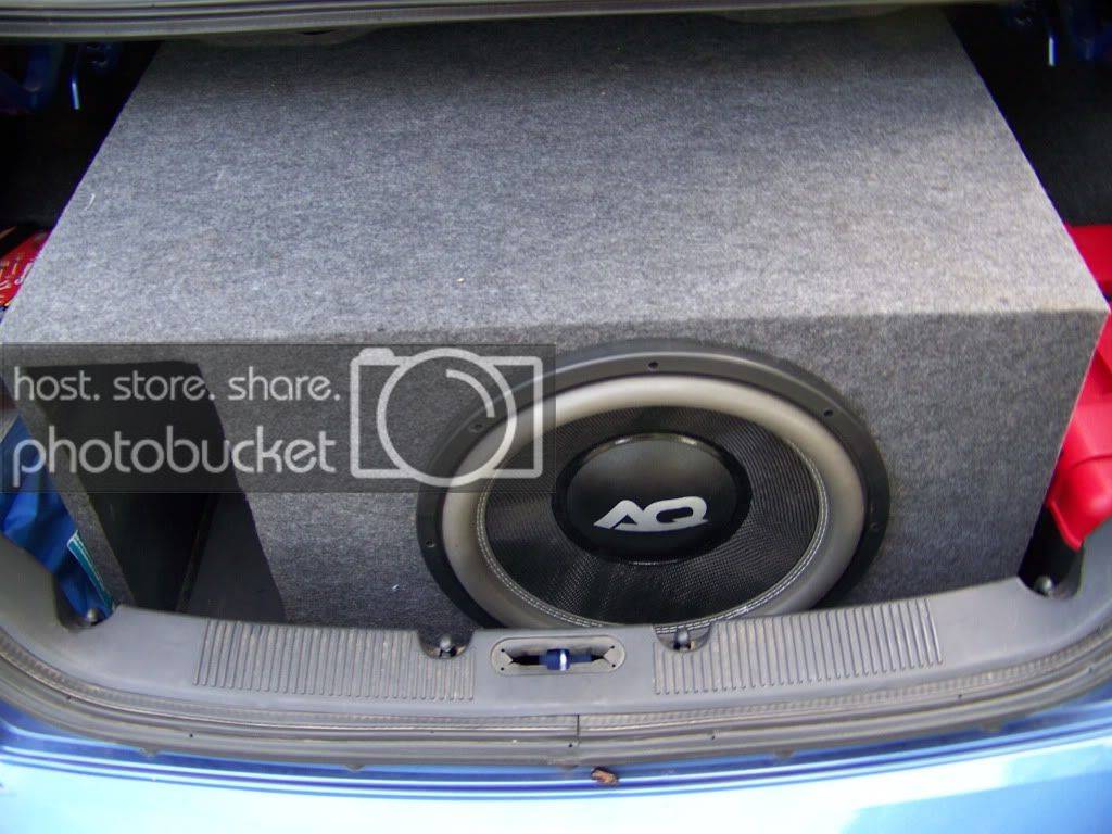

Due to my car accident this is the new vehicle insurance will pay for. Anybody know the dimensions of the trunk opening and/or the back seats fold down?
I got a box about 33W25D15H roughly that has to go in. 3.6cu net
Priorities when getting a new vehicle, >___>
That should fit ok. These are my box dimensions and it barley fits, had to take off the trunk latch to shoehorn it in.

My model has fold down seats which obviously makes it much louder with them folded down. Rear speakers are free air so they can be removed for more air flow through the rear deck. For the most part they are pretty hard to get loud. With my 15" AQ HDC3 running on my old MB Quart Discus 2000.1D i scored a 141.5db on TL, would probably score around 143db with my new sundown 2500. These cars get the loudest in the 40-43hz range.
