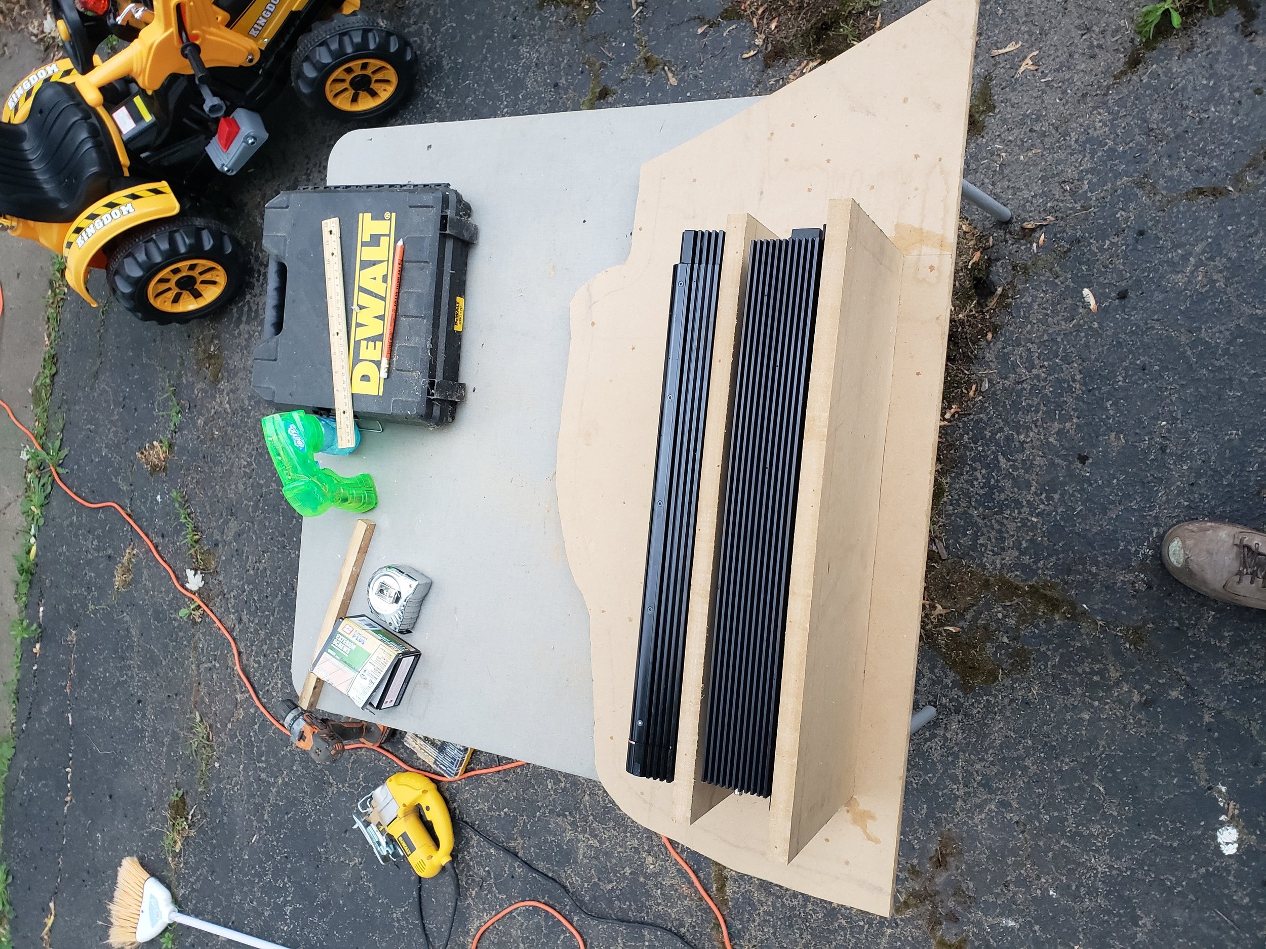

Just got the amp rack dome today for the most part. All that's missing is some metal L brackets to strengthen the shelves.

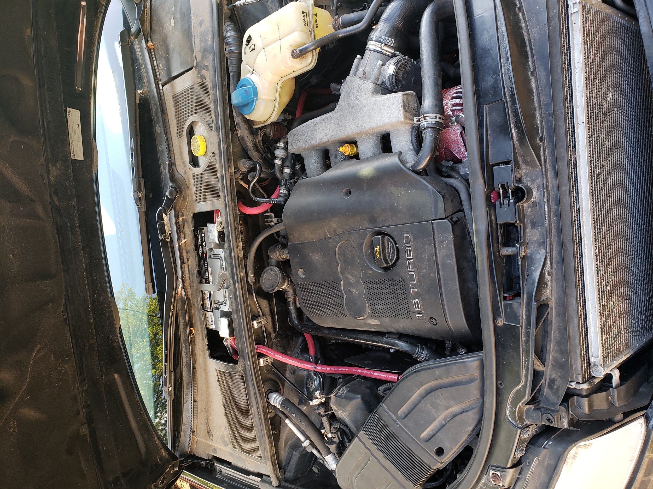

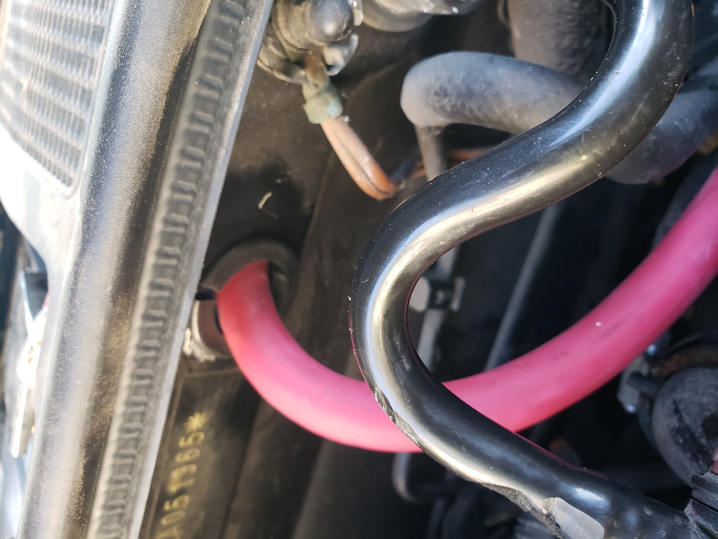

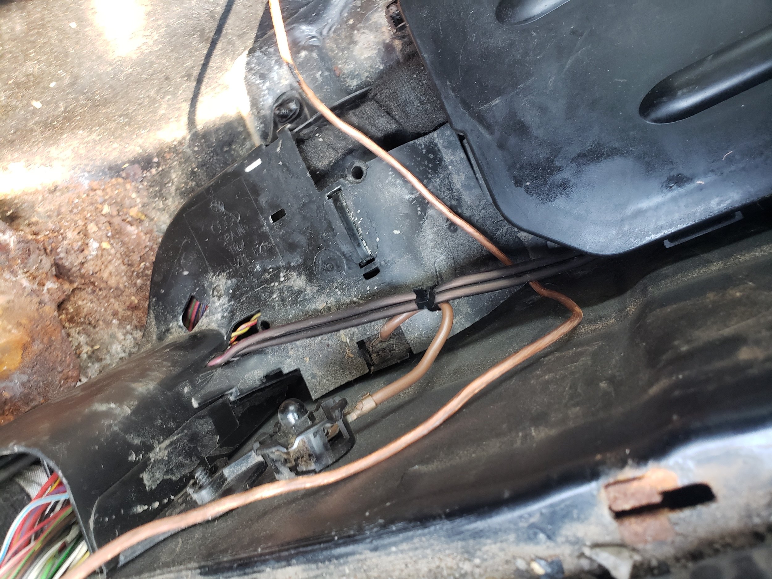

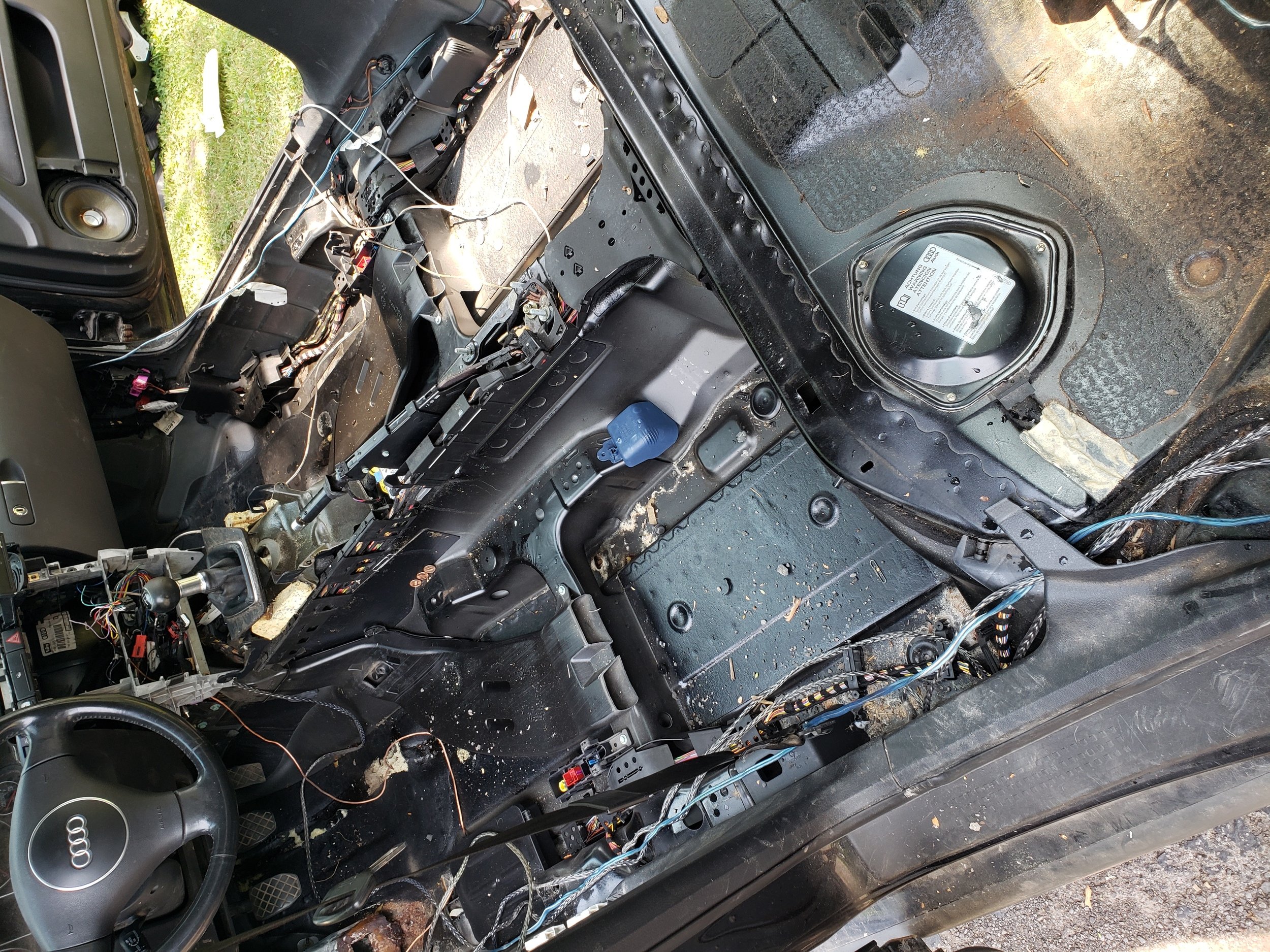

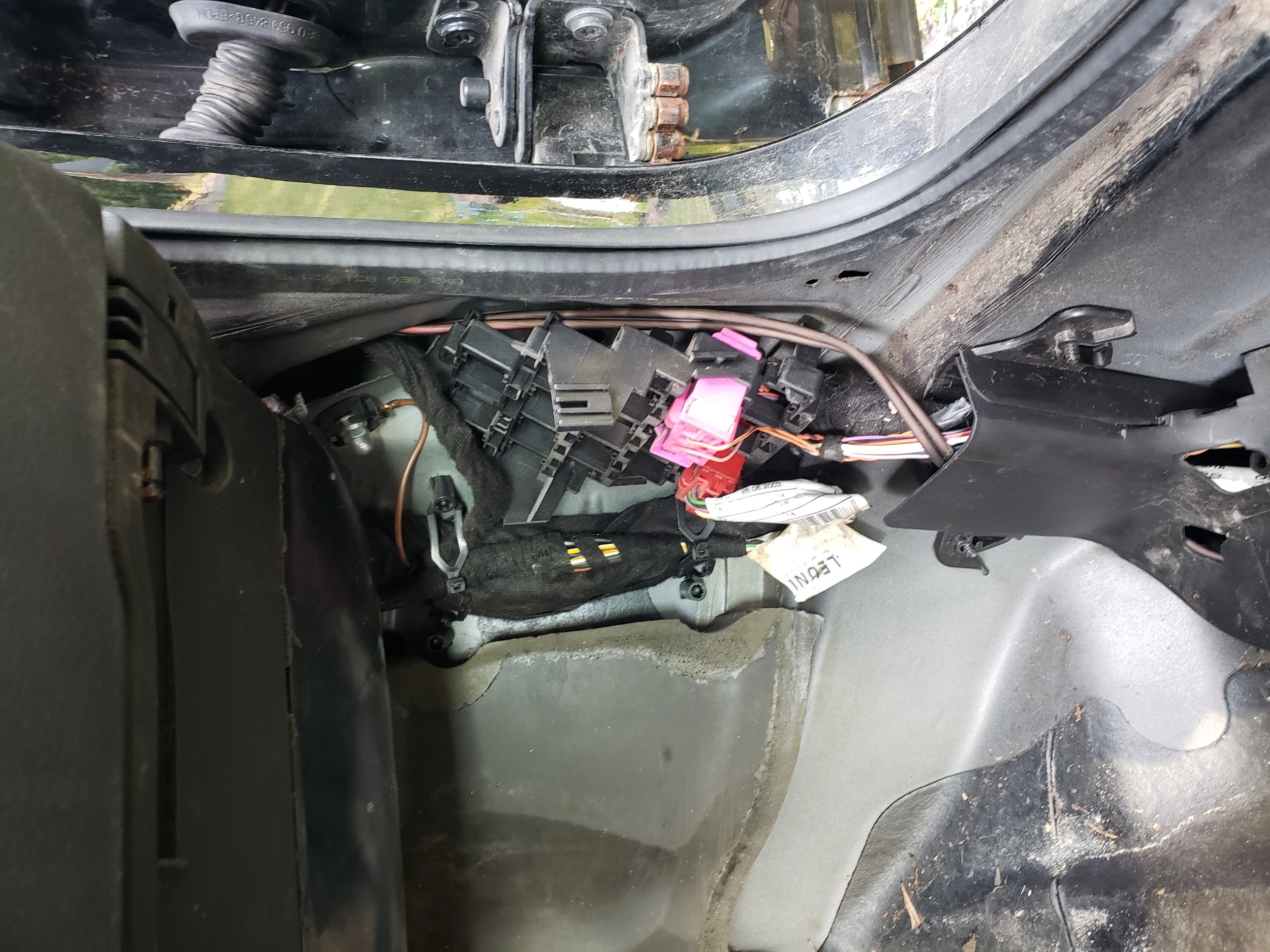

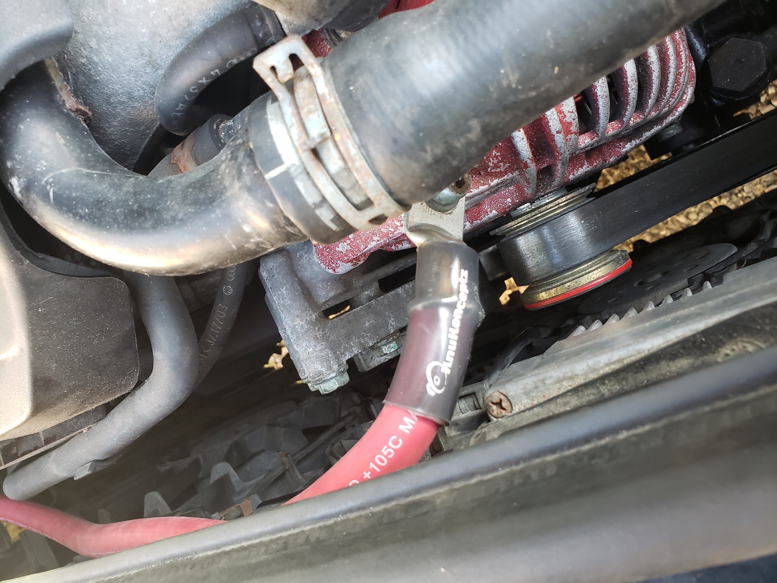

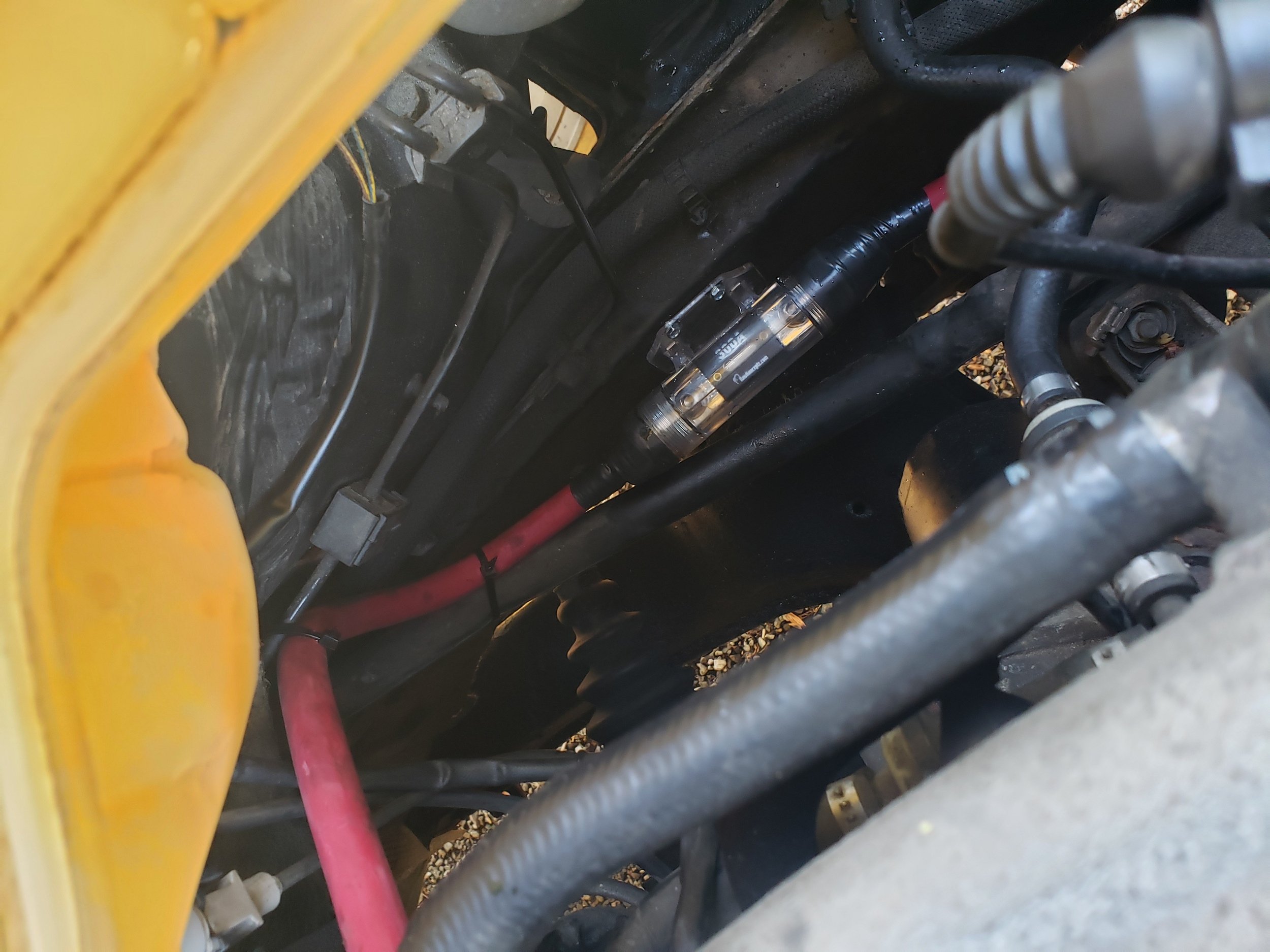

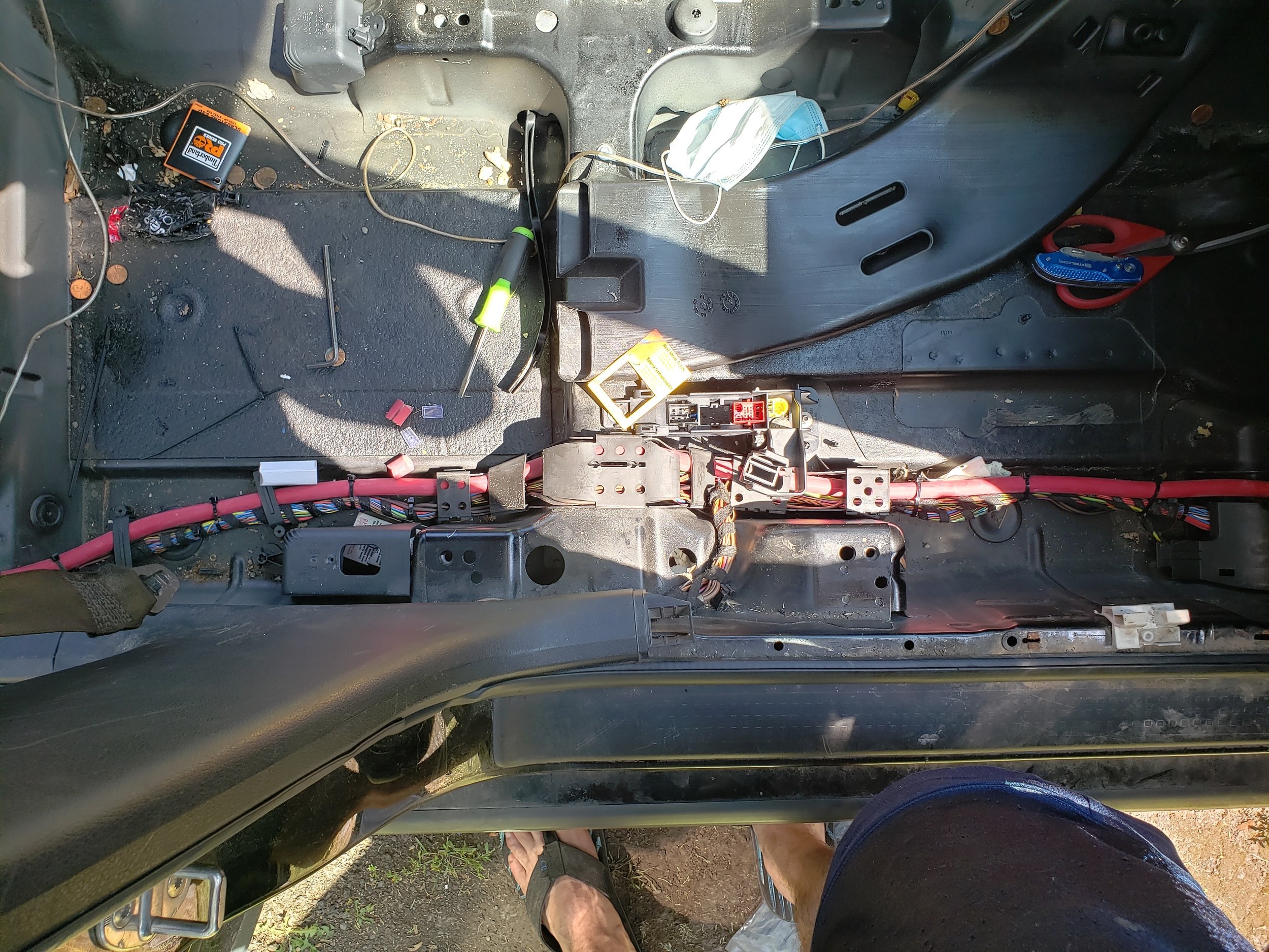

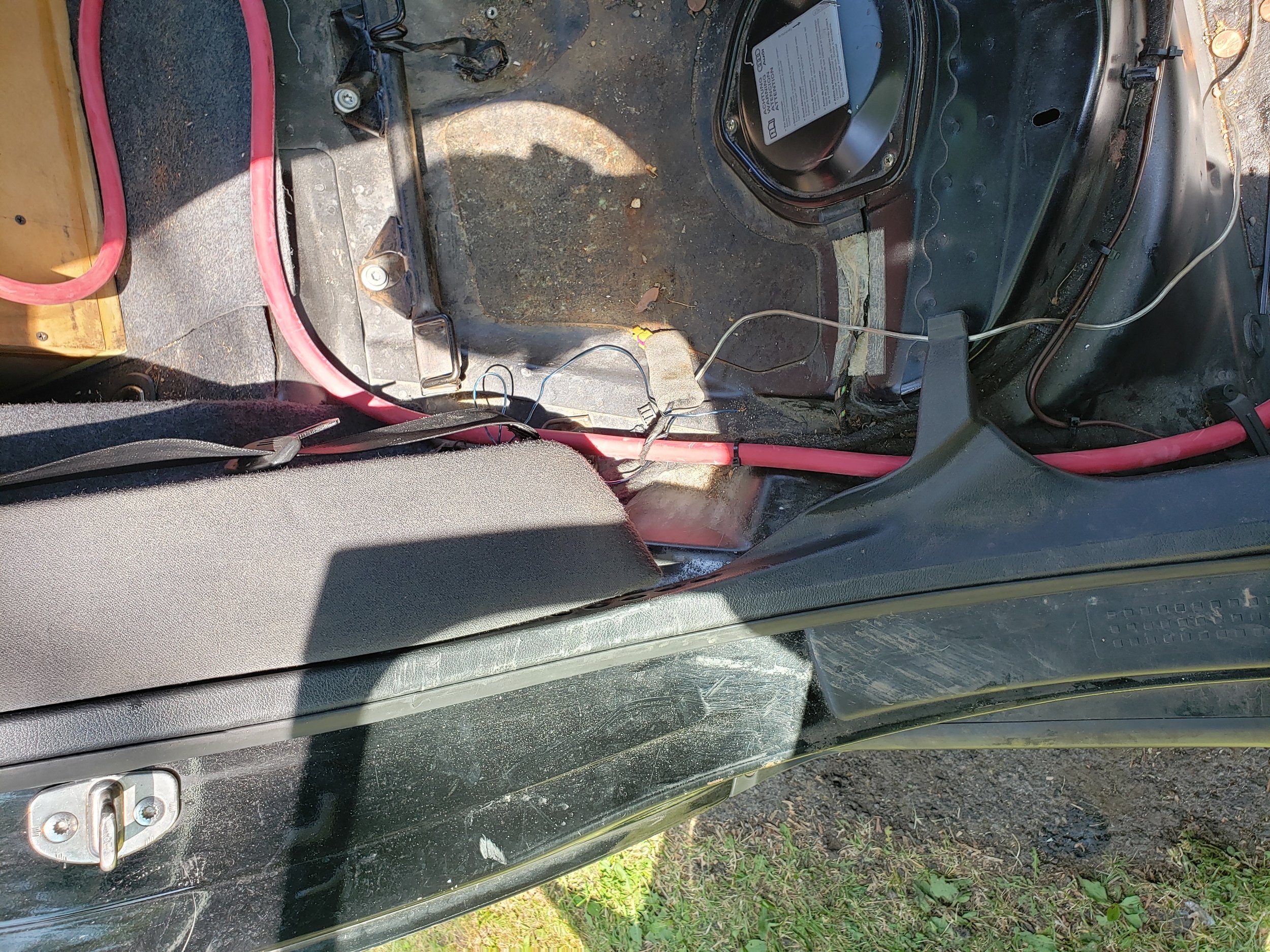

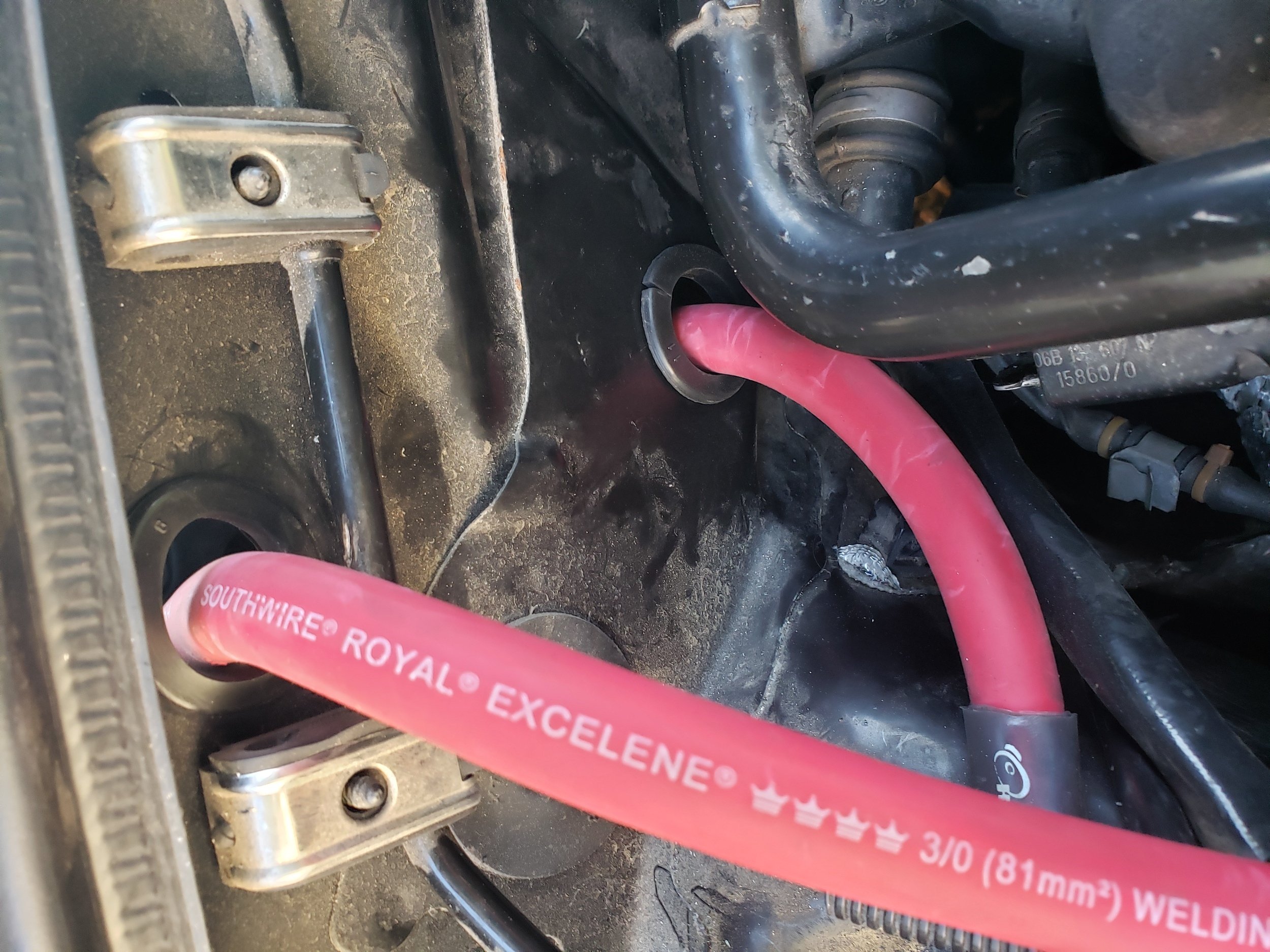

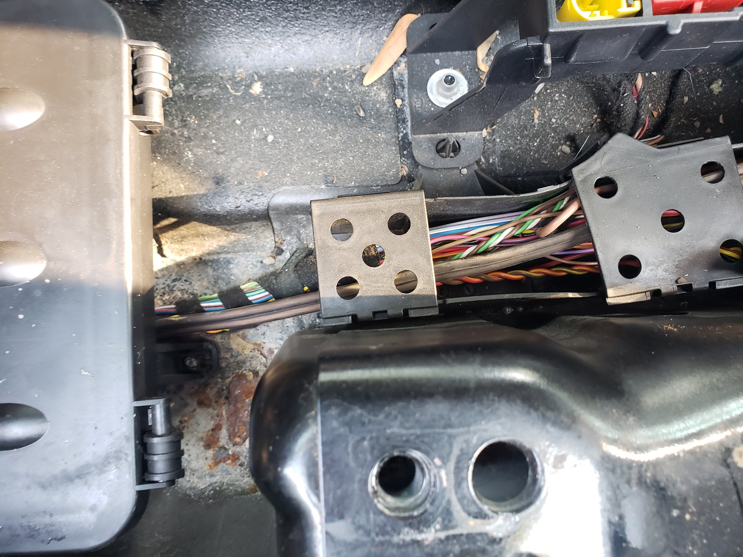

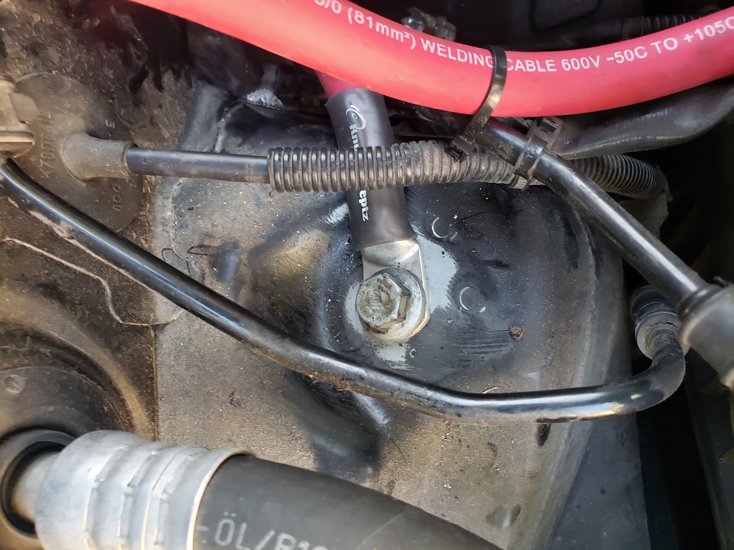

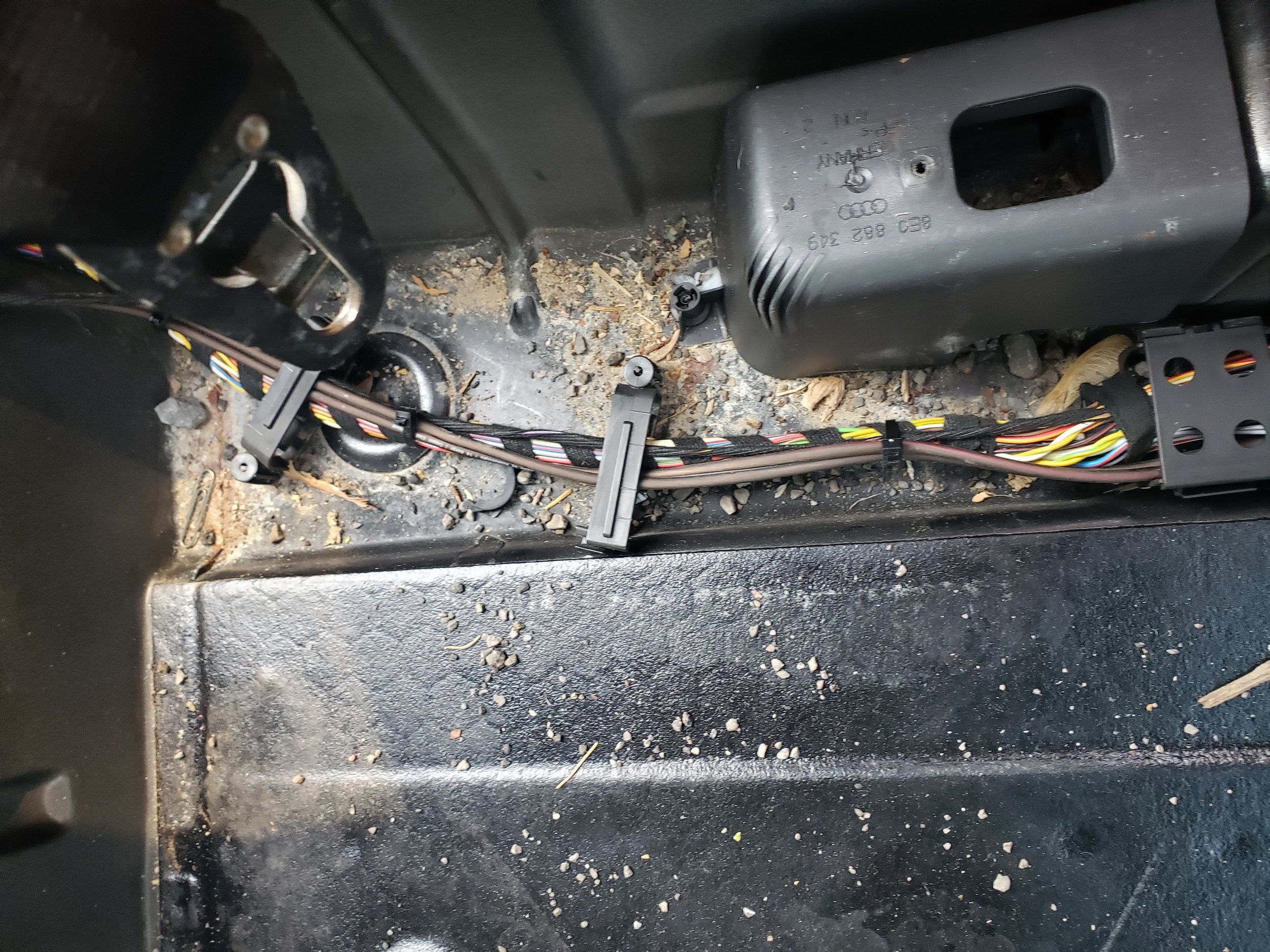

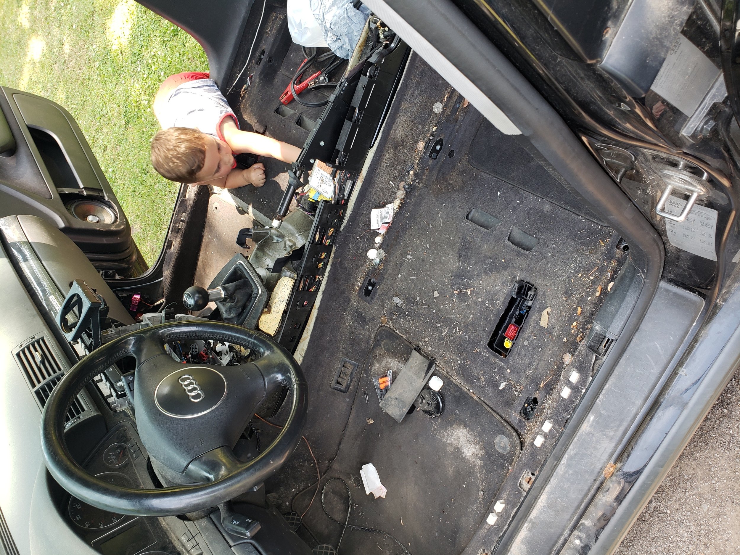

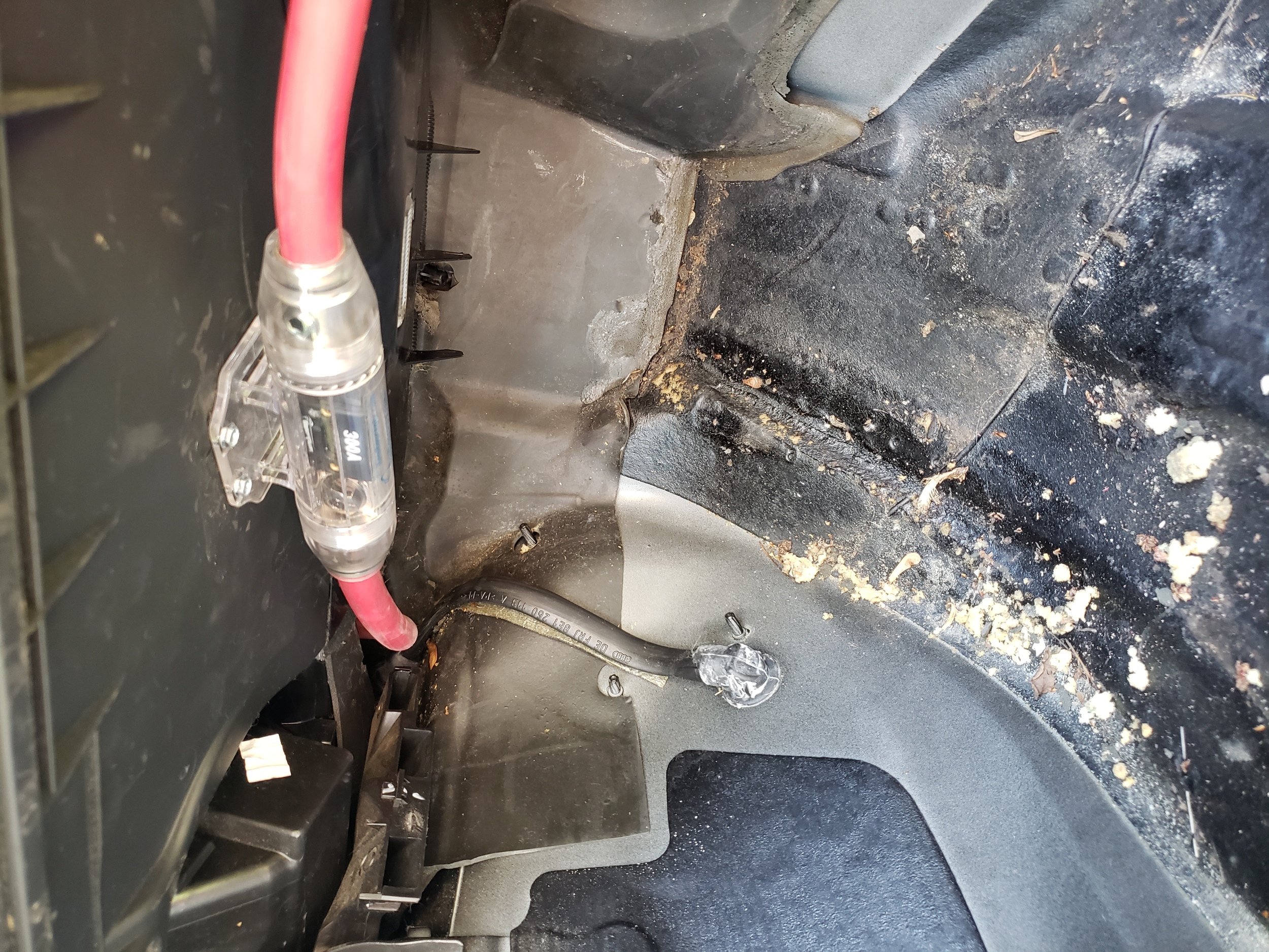

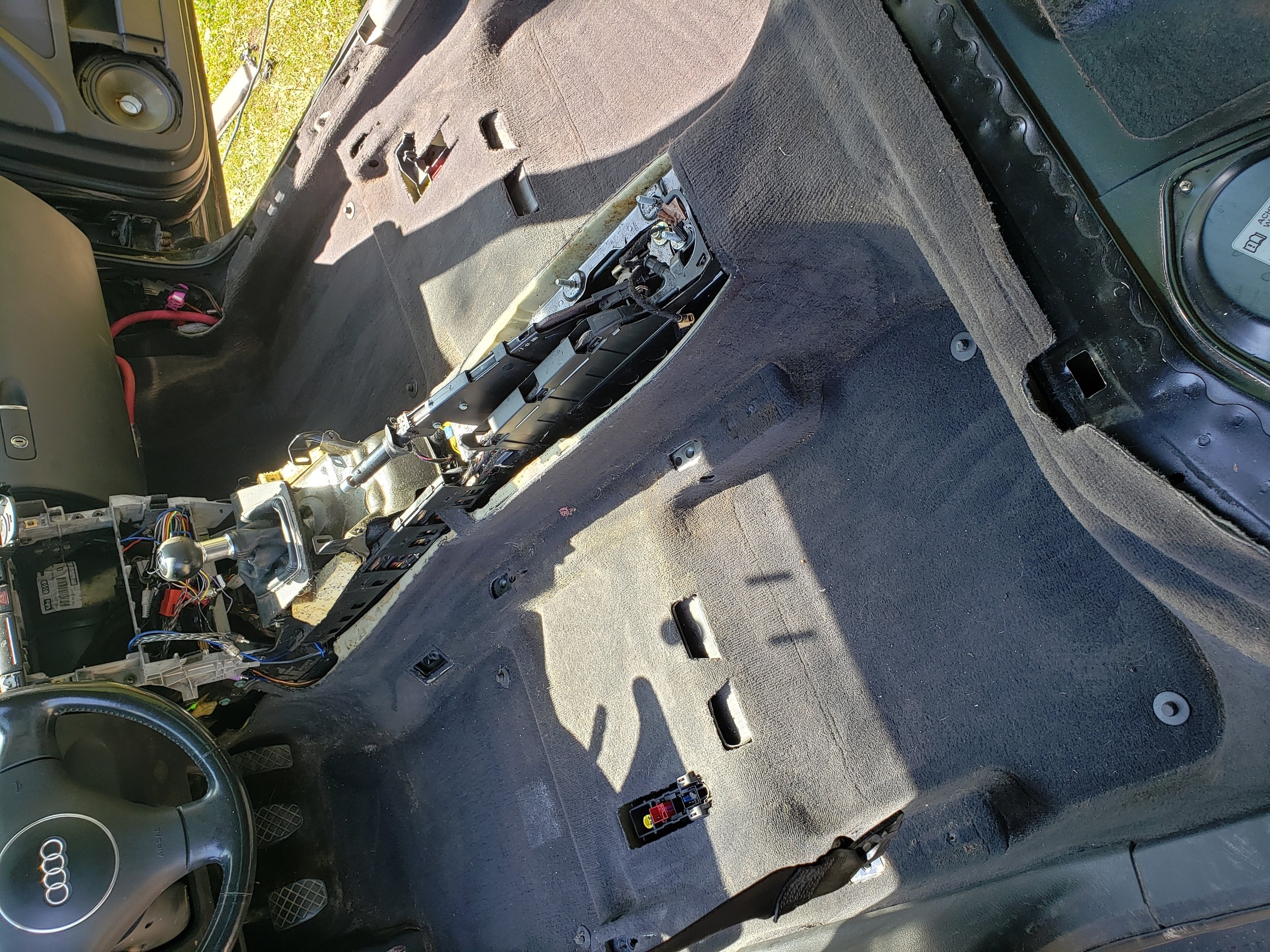

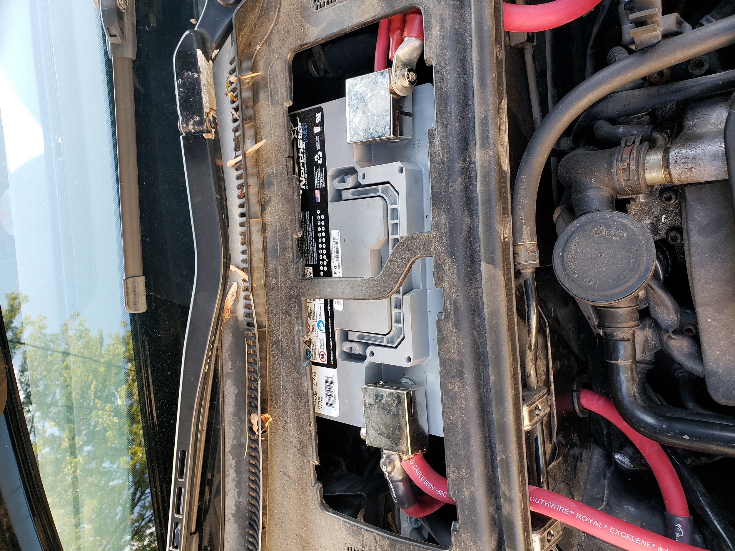

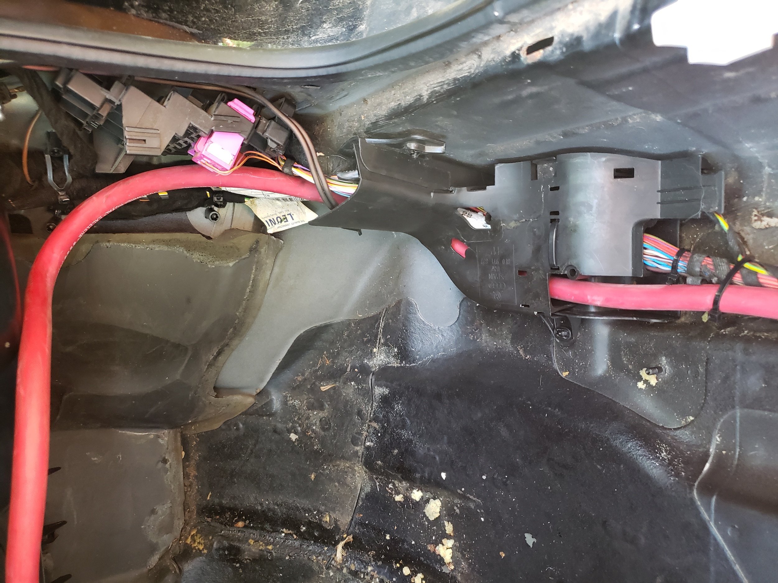

Did my big three today. Drilled holes through the firewall and protected the wire with grommets so I could retain my factory deck over the battery. Had to remove the coolant reservoir to get my fuse attached to the frame. That wasnt fun 😂😂
