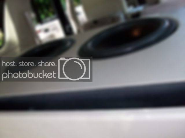

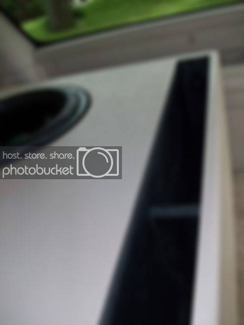

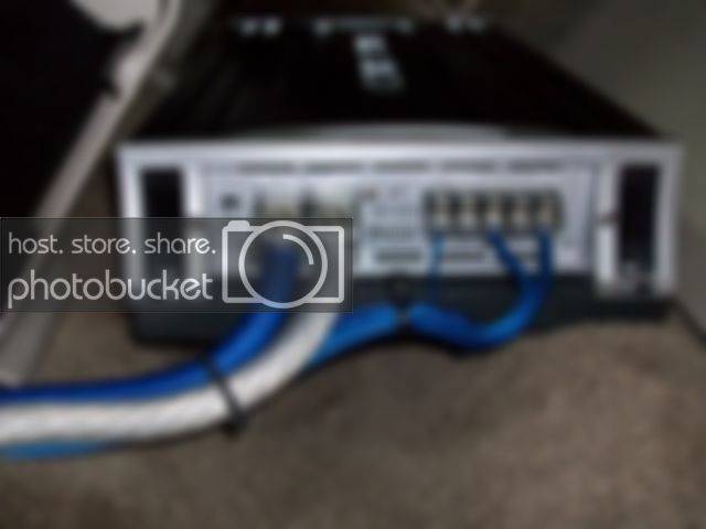

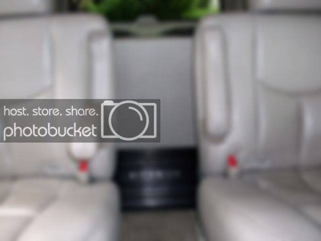

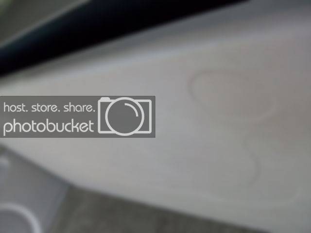

I just recently joined the forum and decided I'd throw some older builds up on here.Did a Cadillac Escalade ESV for a buddy of mine with (2) Fi BL 18's with the flatwound coil and cooling option. Built the box to 14.63 cubic feet with the port tuned to 33 Hz. Wrapped it in vinyl to match the interior of the vehicle and did a big "Fi" logo on the back of the box (notice the logo is an "innie", not an "outie").The amp, for now, is a Hifonics BXi2010D that puts out 1752 watts RMS. It will be swapped out for something bigger eventually. Built to be a daily driver. Here it is:
Sounds great. Real nice quality and it really hits the lows nice, but it just isn't near as loud as it could be with the right amount of power going to it.Even still it beats pretty nice.Shakes the whole dash up like crazy and can easily hear it coming about 150 yards away.
