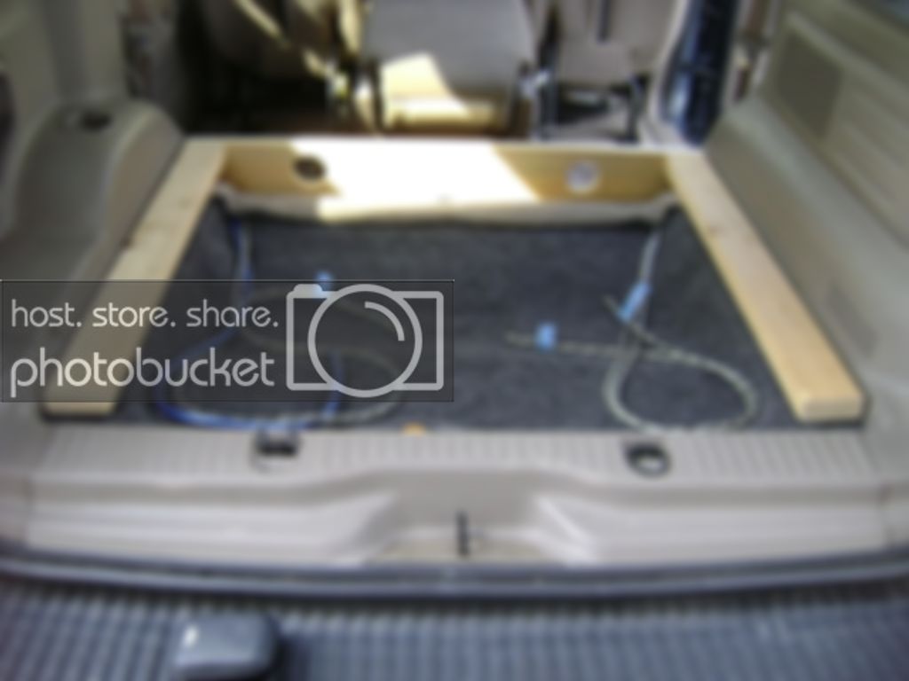

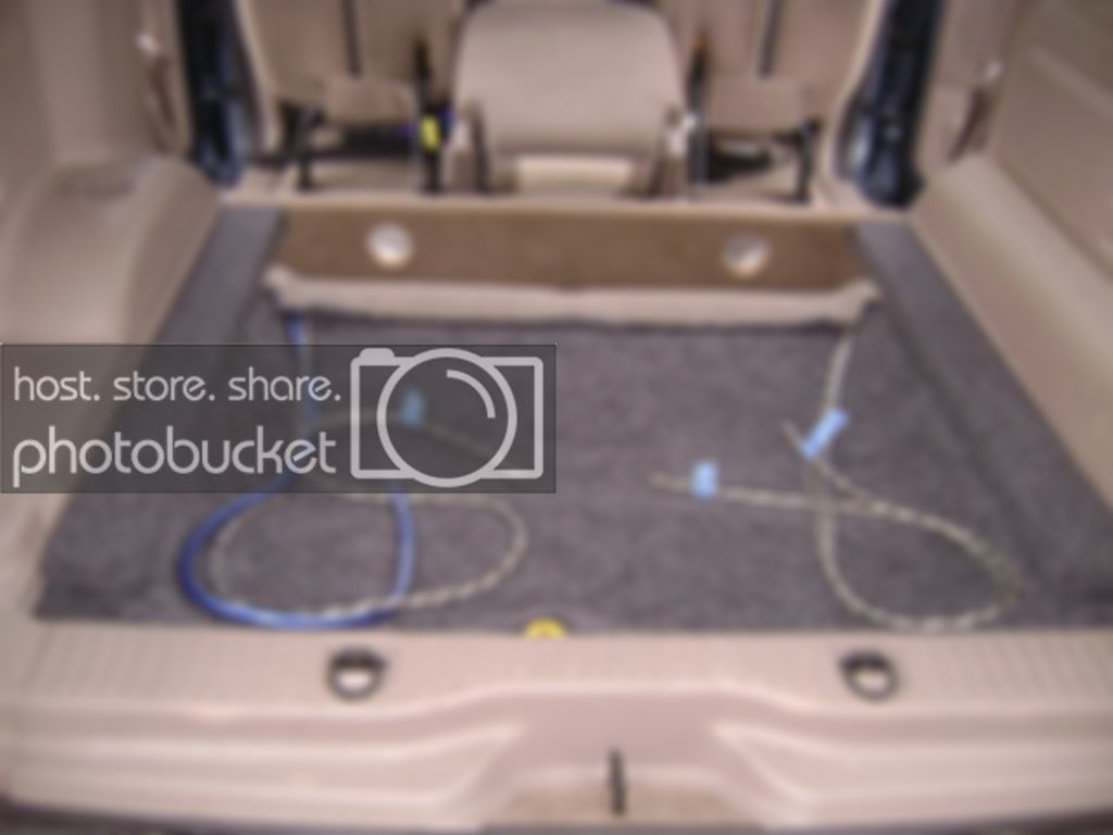

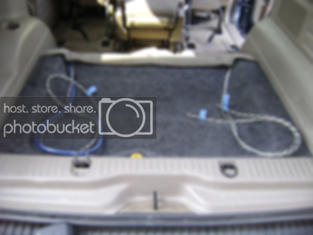

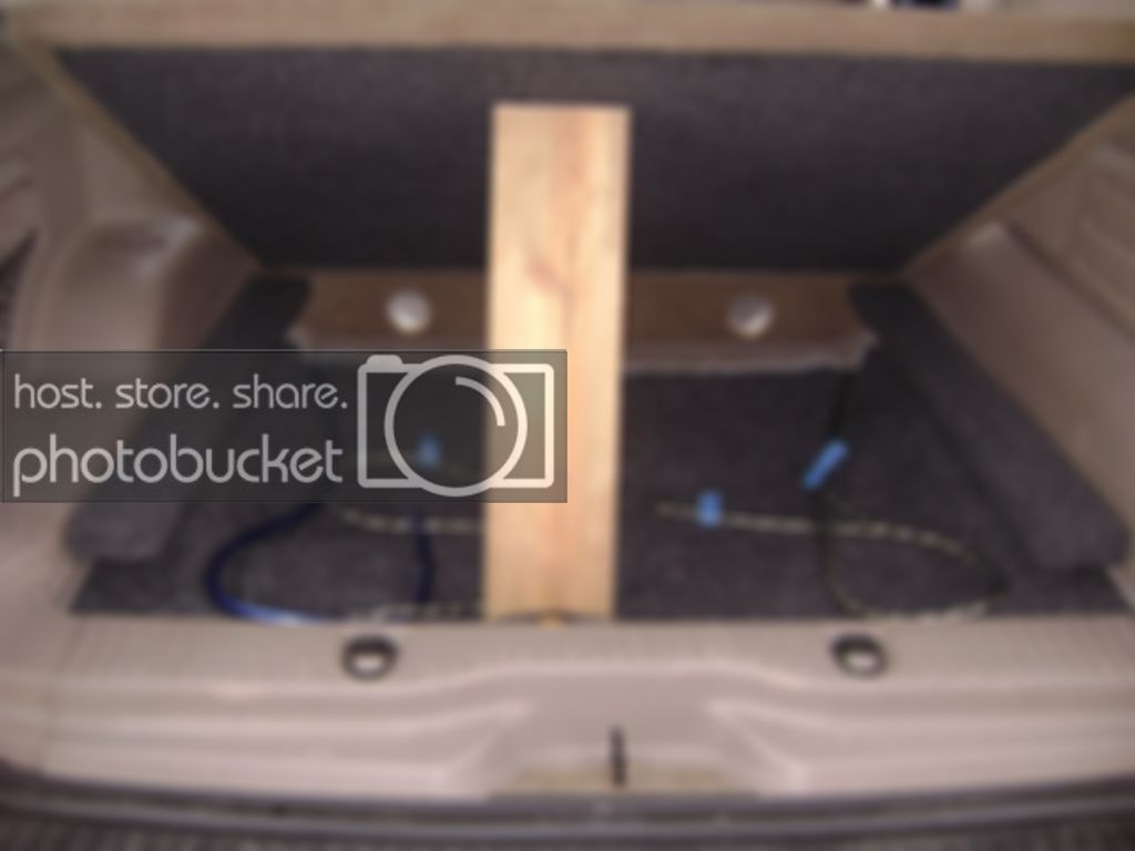

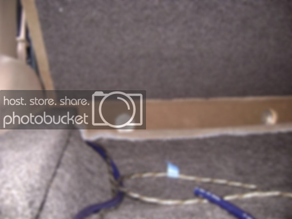

1/0 for power and four runs of 12gauge for my tweeters and mids. In the picture you only see three runs, but that was only because I took the time to snap the picture before getting the forth run finished.

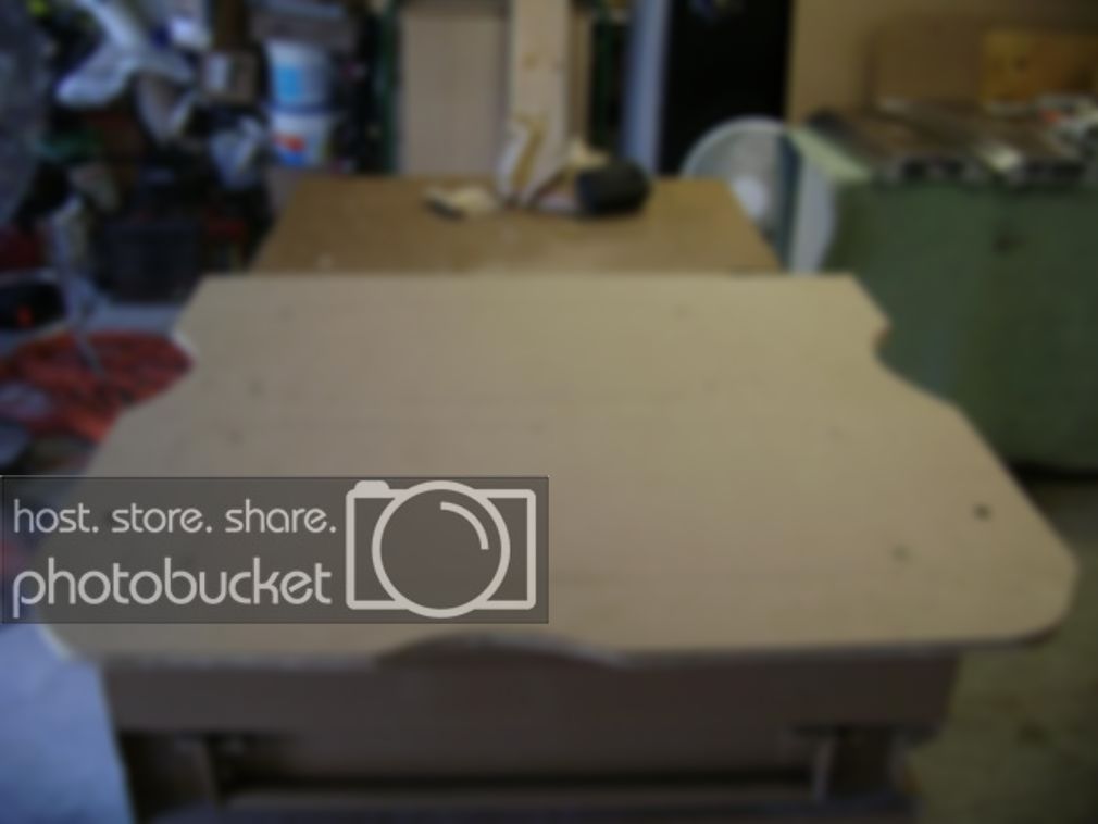

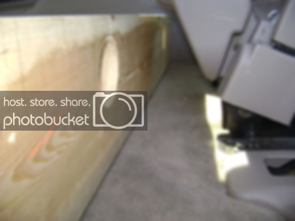

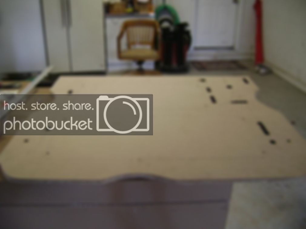

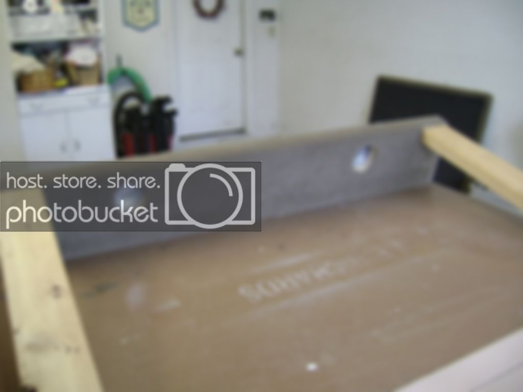

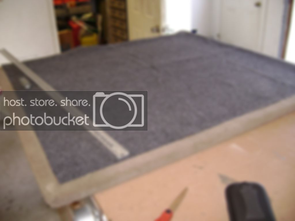

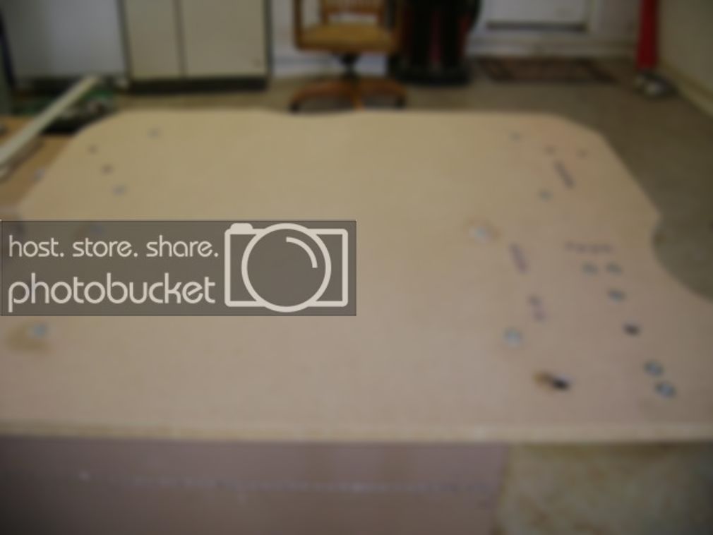

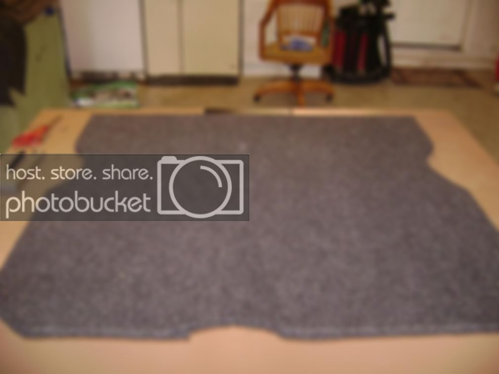

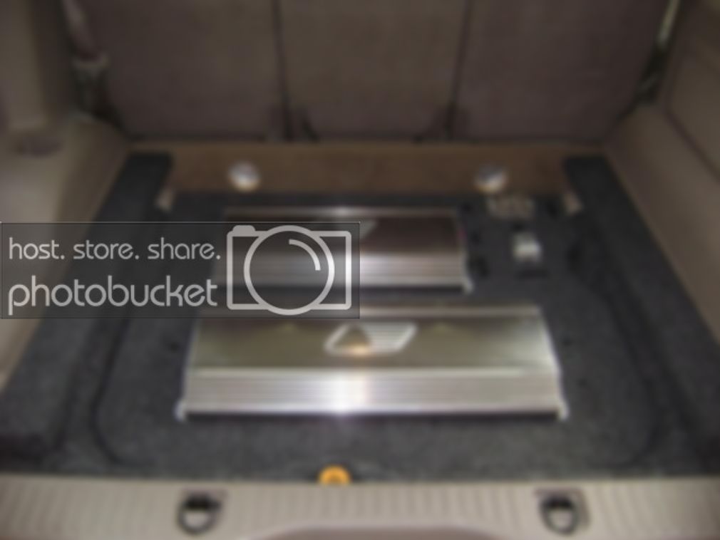

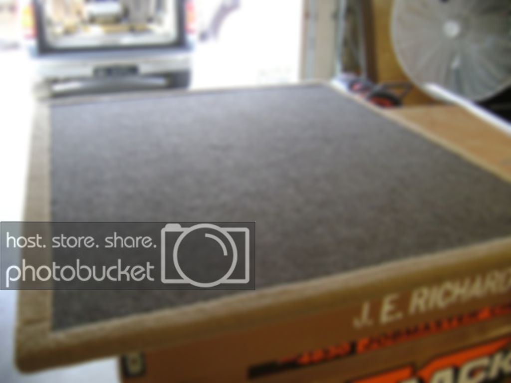

Next I started fabrication for an false floor. I used a 2x8 for the rear and a 2x4 for the sides. This will then be hinged with the top and allow me to access the amps and any fuses. Here is how I did it:
Needed to check to see how it fit:

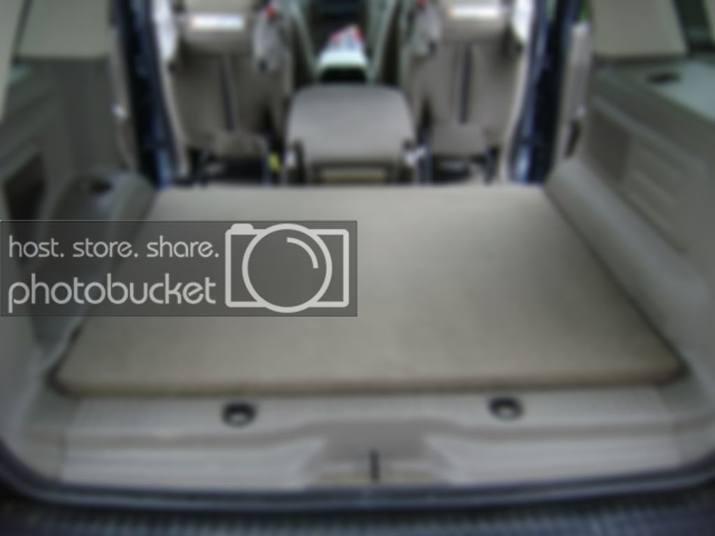

Floor on:

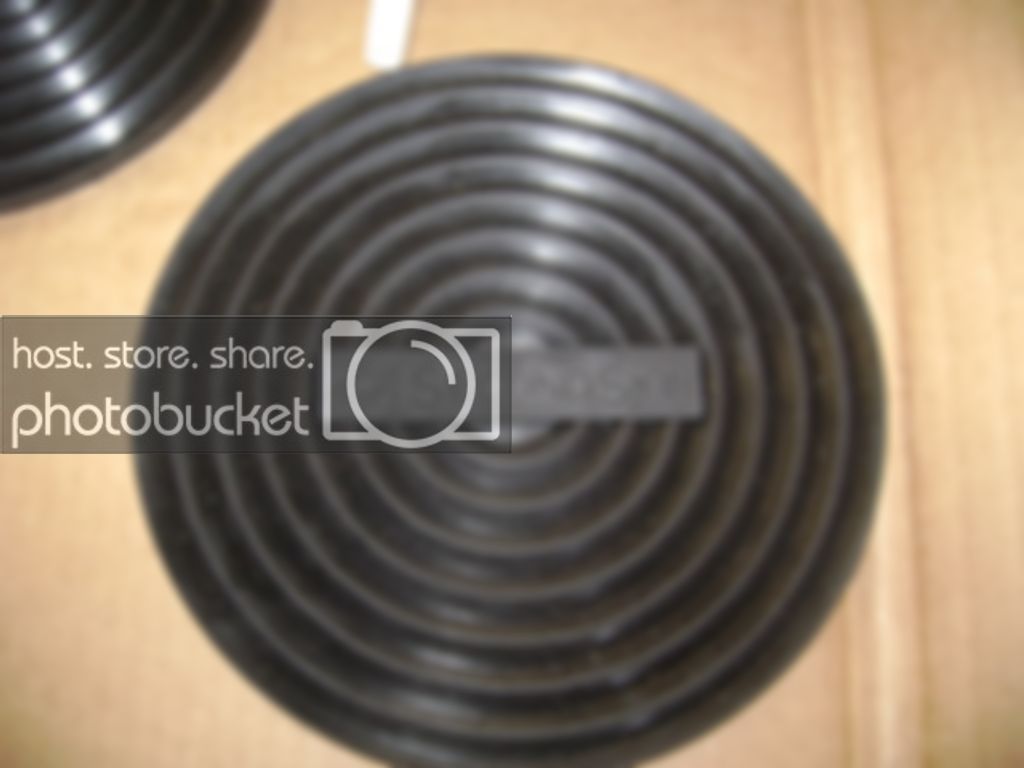

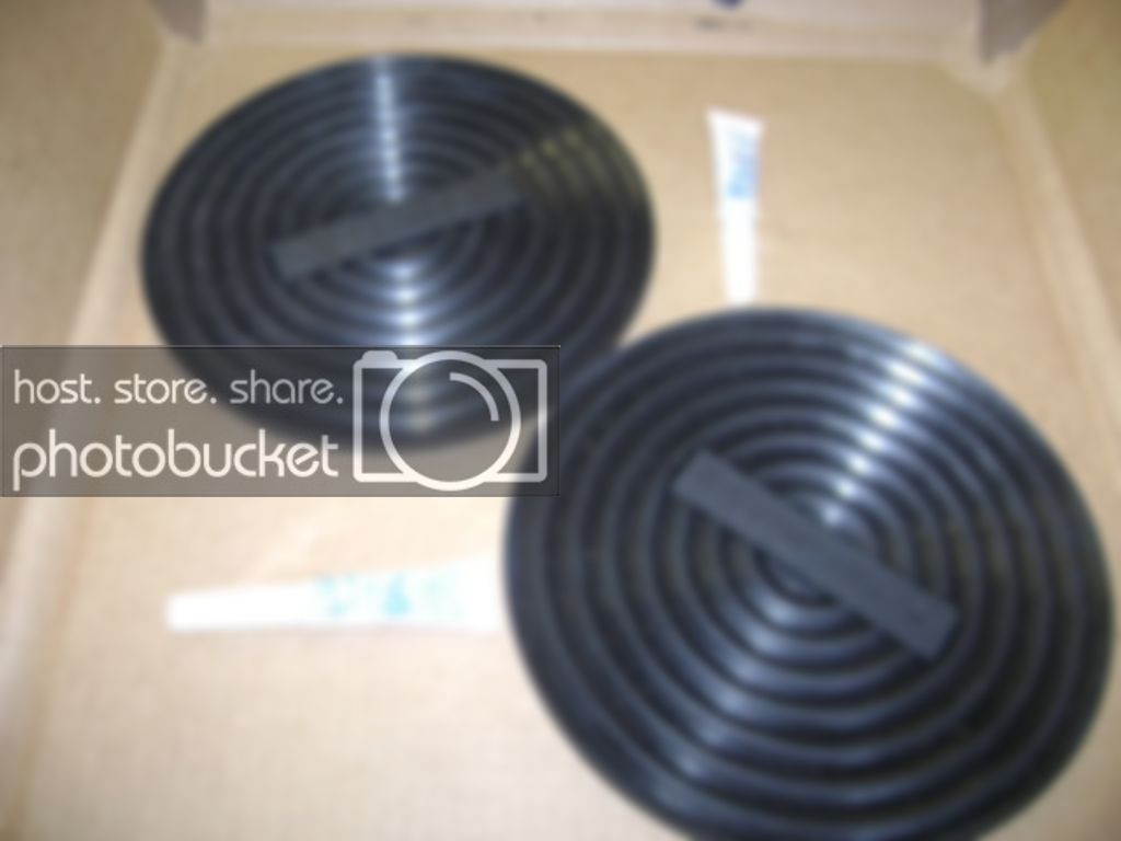

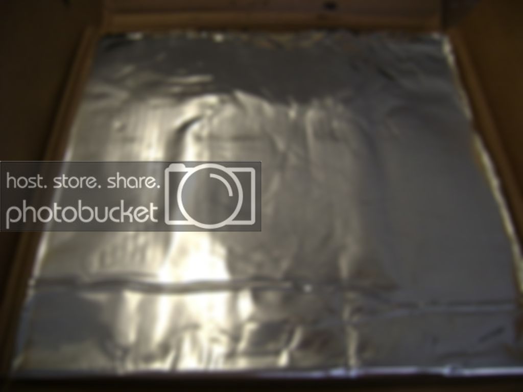

I’d heard some much about Second Skin I wanted to give it a try. I needed something for behind the mids so I picked up Second Skins Tweaker Kit. It included two sheets of Damplifier and two back wave canceling discs.

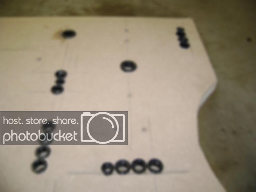

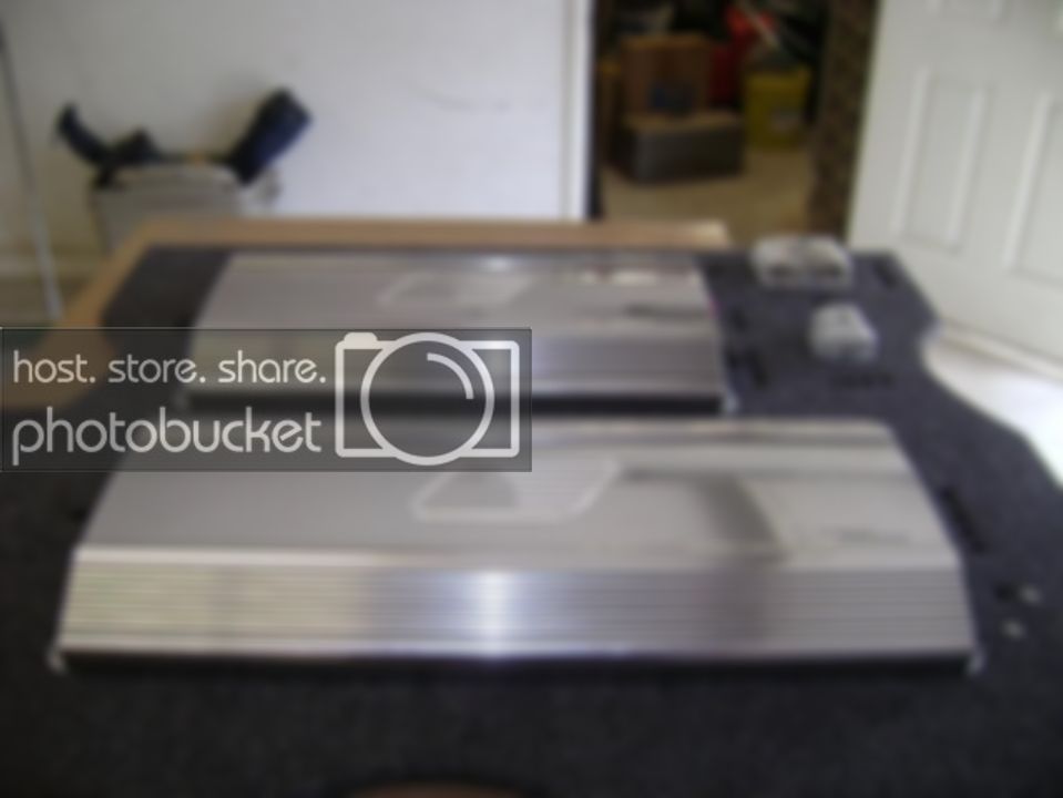

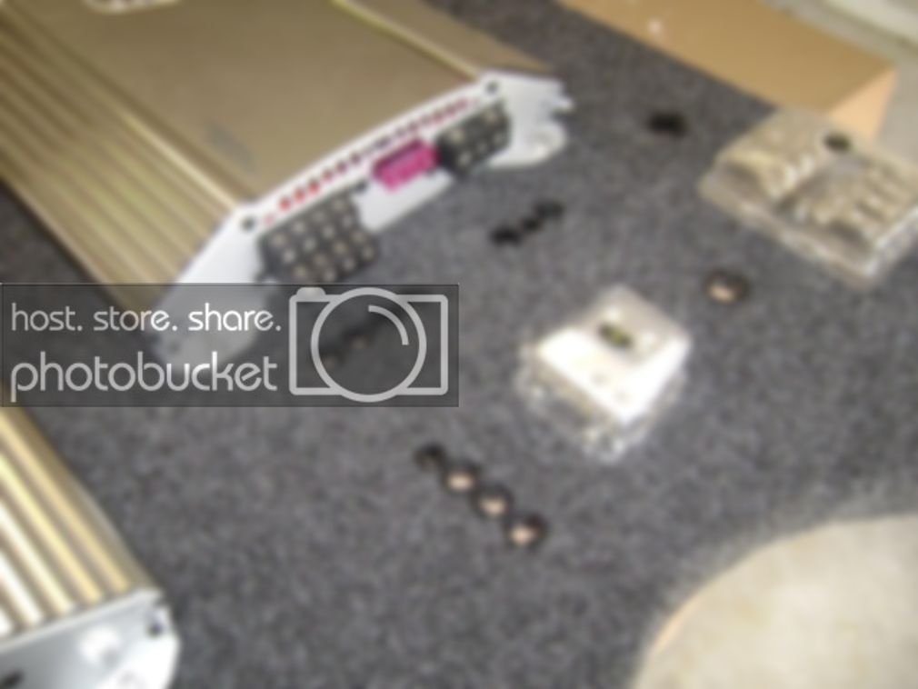

Today I had the opportunity to build the amp rack for the Orion 2500D and 8004. The two distribution blocks are also mounted on the rack. Here is how it went down:
I used stainless steel 10-24 and 8-32 t-nuts and hardware.
All of the cables will come up from beneath the false floor, so I used plastic snap in grommets.
