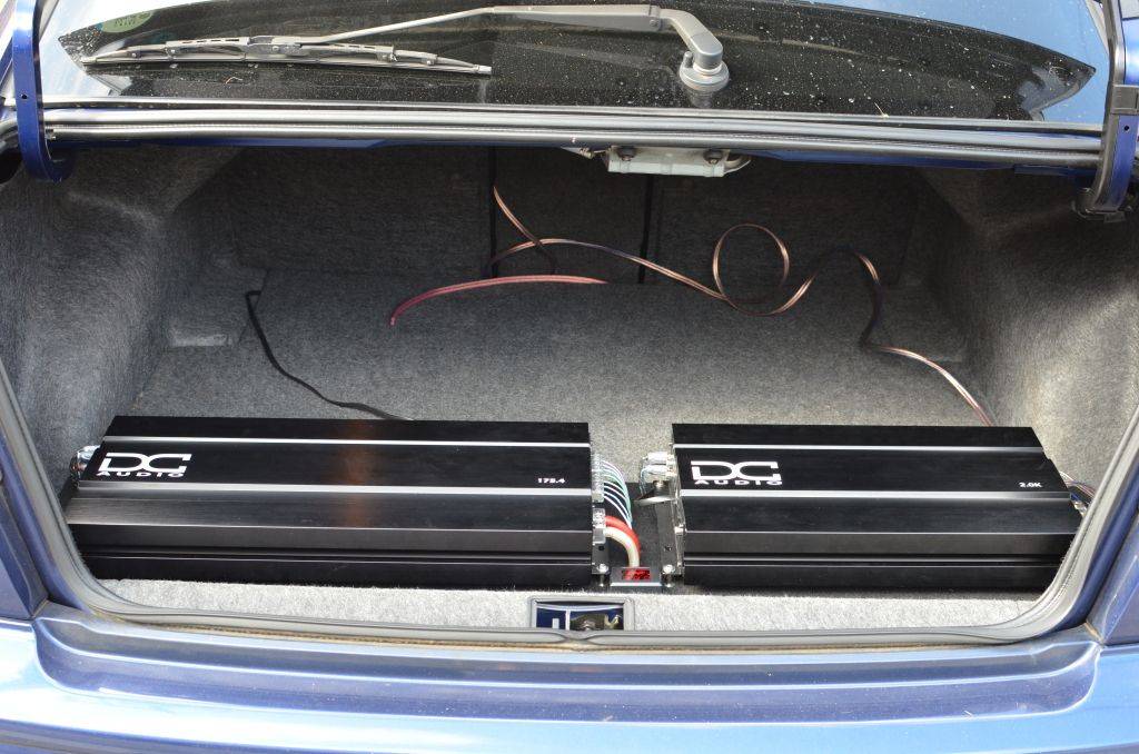

Got my amp rack wired up and installed as well
Still waiting on the two DC Level 3 10's to come in, as well as some AT 60 mil deadener to do my doors. Cutting up some spare sail panels I got from the junkyard for my tweeters now. Car's leaking oil, she'll be in the shop sometime this week //content.invisioncic.com/y282845/emoticons/crying.gif.ec0ebefe590df0251476573bc49e46d8.gif
