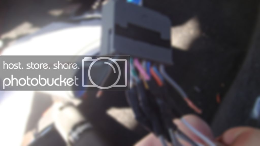

bout to do an install on my 2000 silverado ext. cab. I want to keep the stock HU. My buddy told me to use a Rockford 3sixty, so that I can convert to RCA signal, and use my ipod in auxilary. Him and his wife are expecting, and it looks like I'll be doing it myself (daddy duty).
How do I make it work? diagrams for me to hook up the harnesses? what harnesses do I need? thanks!!

Dued I will be honest I am rely experienced and it took me 4 days to do that and all the amps and speakers and all. It is not as easy as just installing a new head unit. You can aim me at reimermatt and I can talk you threw it. It is not for beginners I promise you that.
LOL Here check out the picks here of the install I did. Gives you an idea of what to do.
http://www.caraudio.com/forum/showthread.php?t=370497&page=2
Is it just that you have to go pin by pin thru the harness, to find the right connects, or something else. I have a diagram of all the pins in order from top left to bottom right, with a number/color position on the diagram.
I see you used clean-sweep instead.... is that the same pretty much as 3sixty?
Basically both need a constant power and a switched power and a ground and both hookup to your factory amp. Is there any reason why you rely want to keep the stock head unit?

I've perfomed installs in both my '99 Silverado X-Cab and most recently my '08 Silverado X-Cab when the '99 finally died. NOT for the the faint of heart, no matter what you are doing.
My installs involved new HU, 2 amps, new speakers all around and a custom sub enclosure. 4 Days, minimum on each to do it right and carefully. I'm not a pro, but it takes time and patience.
Also, just remember that the OEM electrical setups in these trucks can sometime be a little tricky. Especially in later models like my '08 that have OnStar, chimes and Bose. Pain in the ***!
It helps to do your homework upfront, especially what with all the aftermarket harnesses you need to buy in order to get everything to work. But, it is fun. //content.invisioncic.com/y282845/emoticons/biggrin.gif.d71a5d36fcbab170f2364c9f2e3946cb.gif
