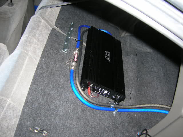

How was it wiring the Sentra? I have a buddy who has been bugging me to do his install but its so friggin cold out and no access to a garage.
Very easy to work under the hood and get 0 gauge through the firewalls. Only problem was running it under the panels on the side. The plastic piece wraps around the drivers seat belt is a pain jbut as long as youer keep the wire way under the carpet it's all good.

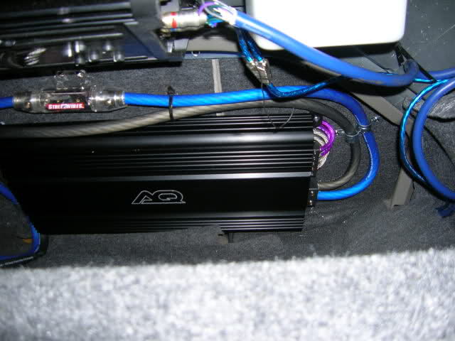

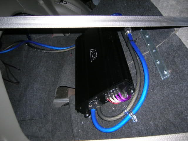

aq2200s installed
