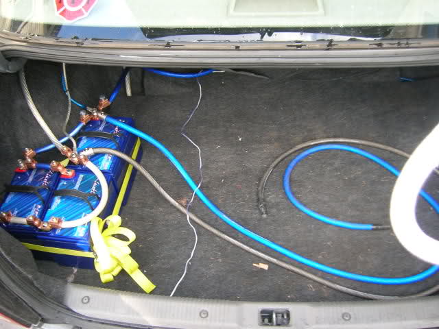

First completed the big3 in knukonceptz 0 gauge
Had one kinetik hc800 cell previously so I added two more.

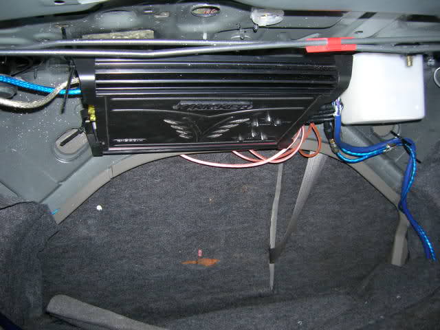

Moved four channel amp from back of the back seats to under the rear deck to make room for the Audioque 2200.

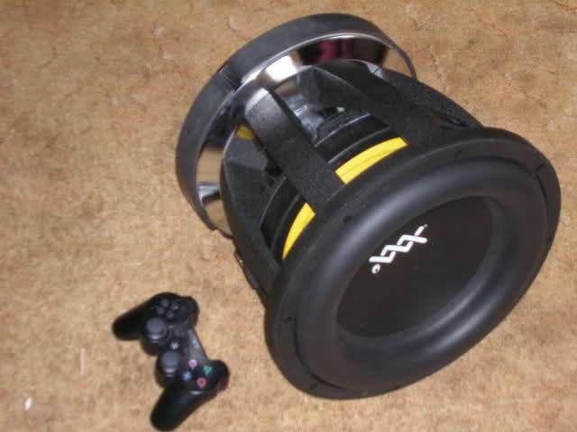

The monster came in the mail the other day

Looks like a clean install, I like how you put the Kicker amp up like that gives me an idea. Also I those 2 HC800s, and a 600?

thanks, if I do this to my next car it's not going to be a compact lol. It's held with zipties for now until I get some screws that are long enough.

ya u really need to know when that XXX was made they had a cast problem with the first batch of subs and had to increase the thickness of the basket by 3/16" because the baskets kept breaking when mounting the sub horizontal i had one broke as soon as i turned the box on its side
look like you good equipment but the install could be a little cleaner alot cleaner and is the amp hanging from zip ties on the 3rd pic???
yezzir, this is my first real build and space is limited. Can't really build a rack or anything the only tools I have are a dremel and hand drill. Not clean by any stretch of the imagination but o so convenient. Only really wanted to keep it in one place. Seen too many people that live near me with their amps sliding in their trunks with every turn.
Might wanna make sure your amp isnt grounded on that metal you have it on. //content.invisioncic.com/y282845/emoticons/wink.gif.608e3ea05f1a9f98611af0861652f8fb.gif
yup put a few layers of felt backing on the back of the amp.
