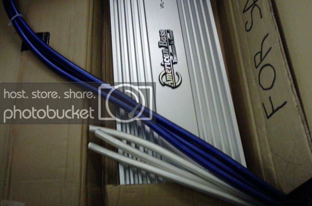

look at what jus came in

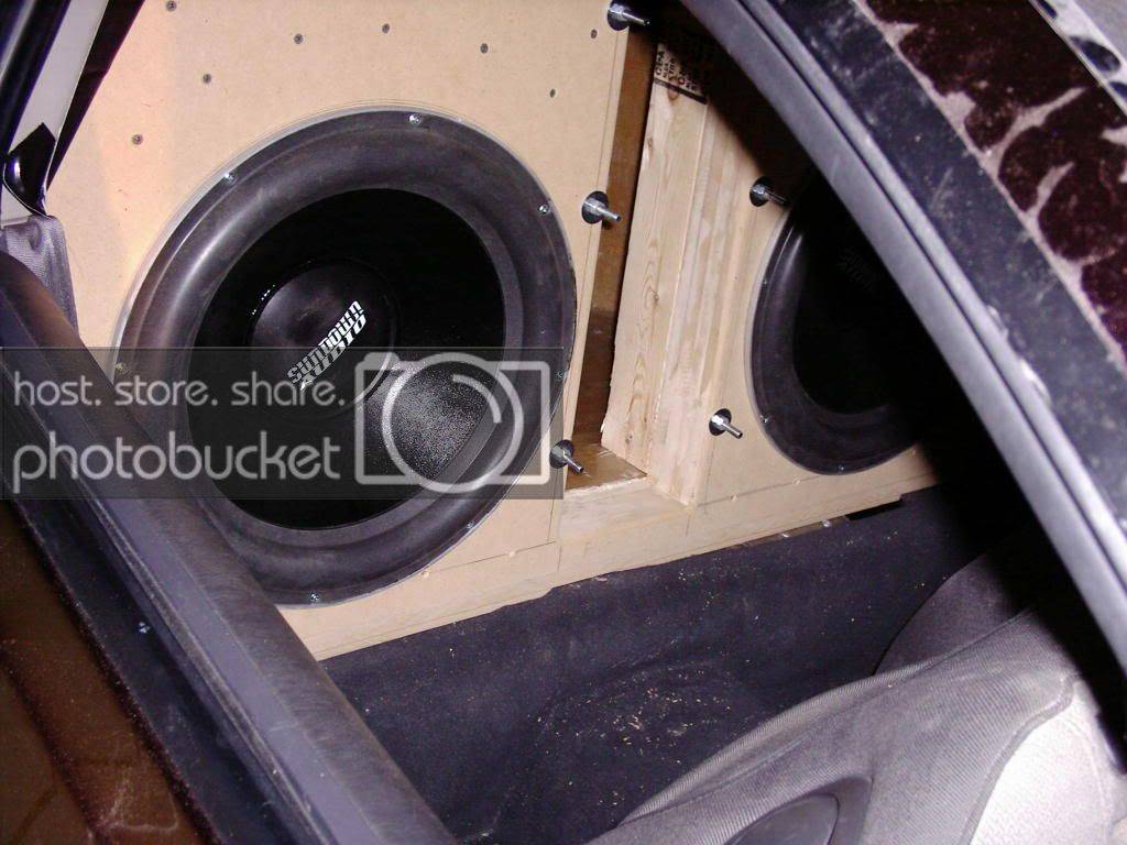

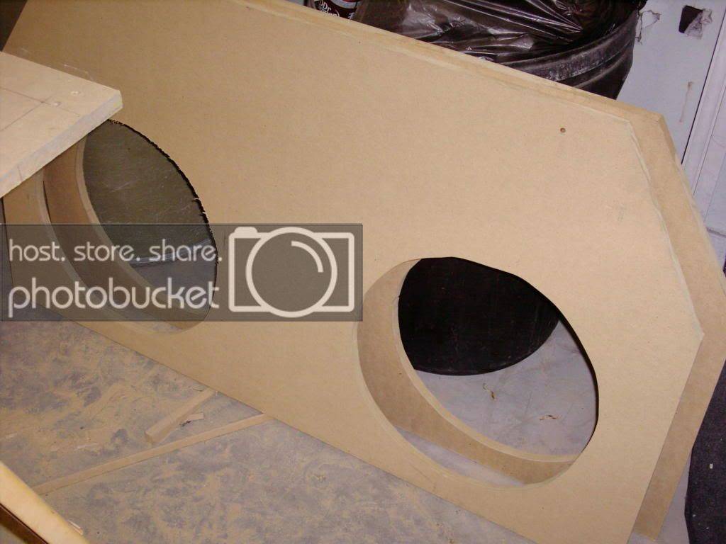

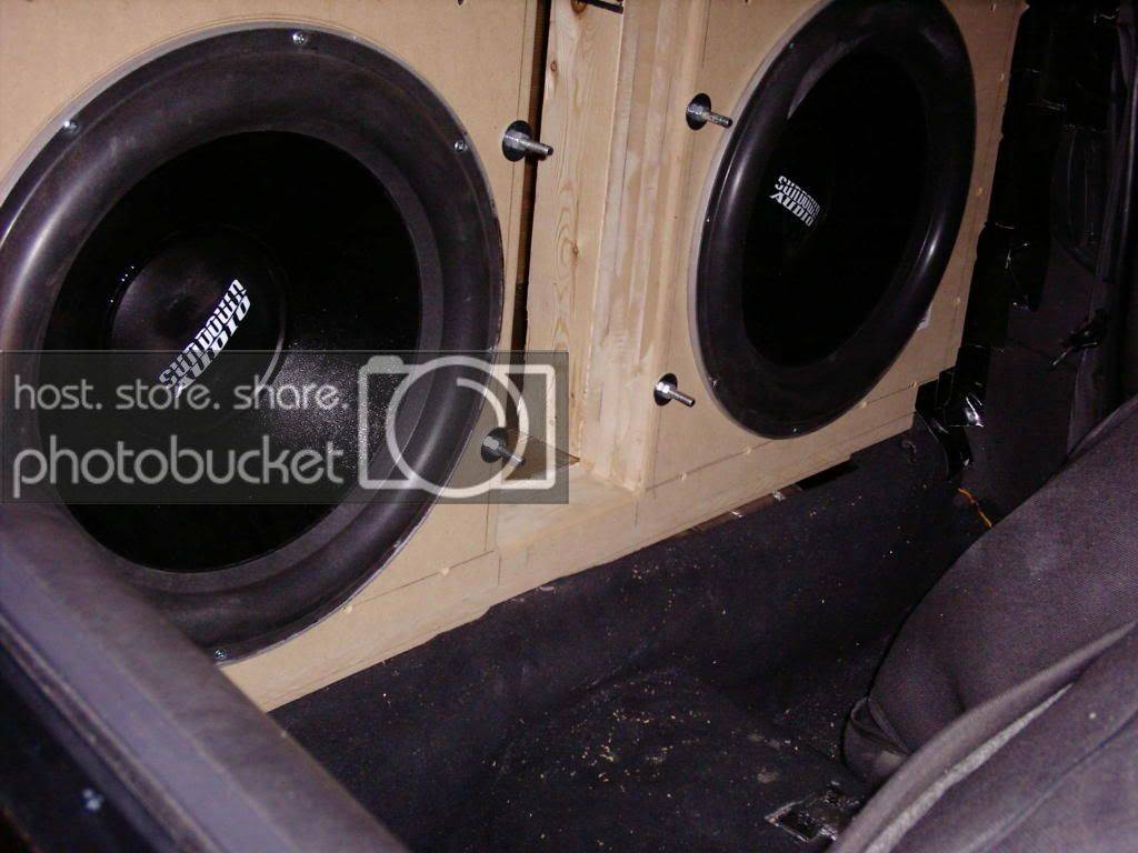

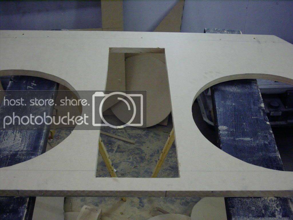

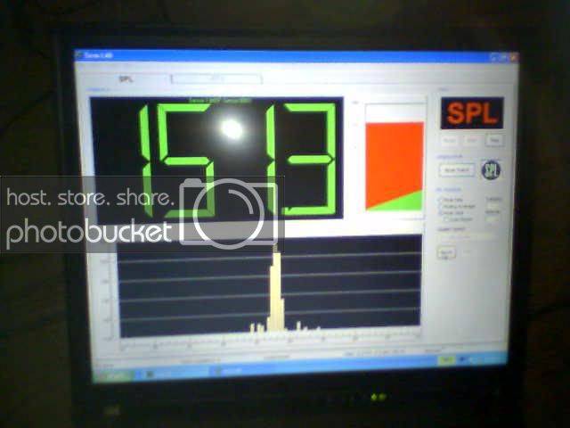

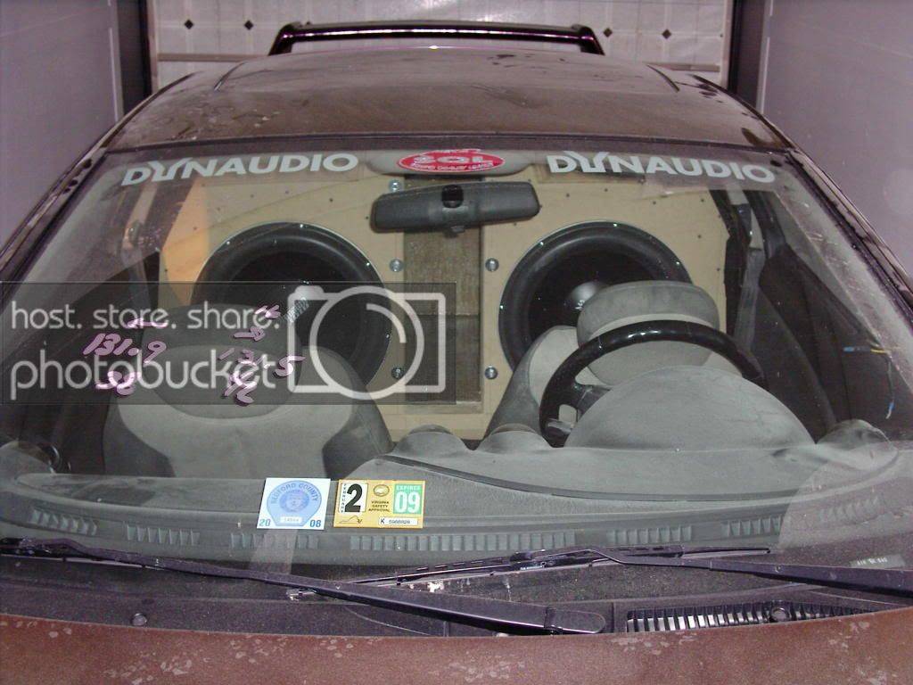

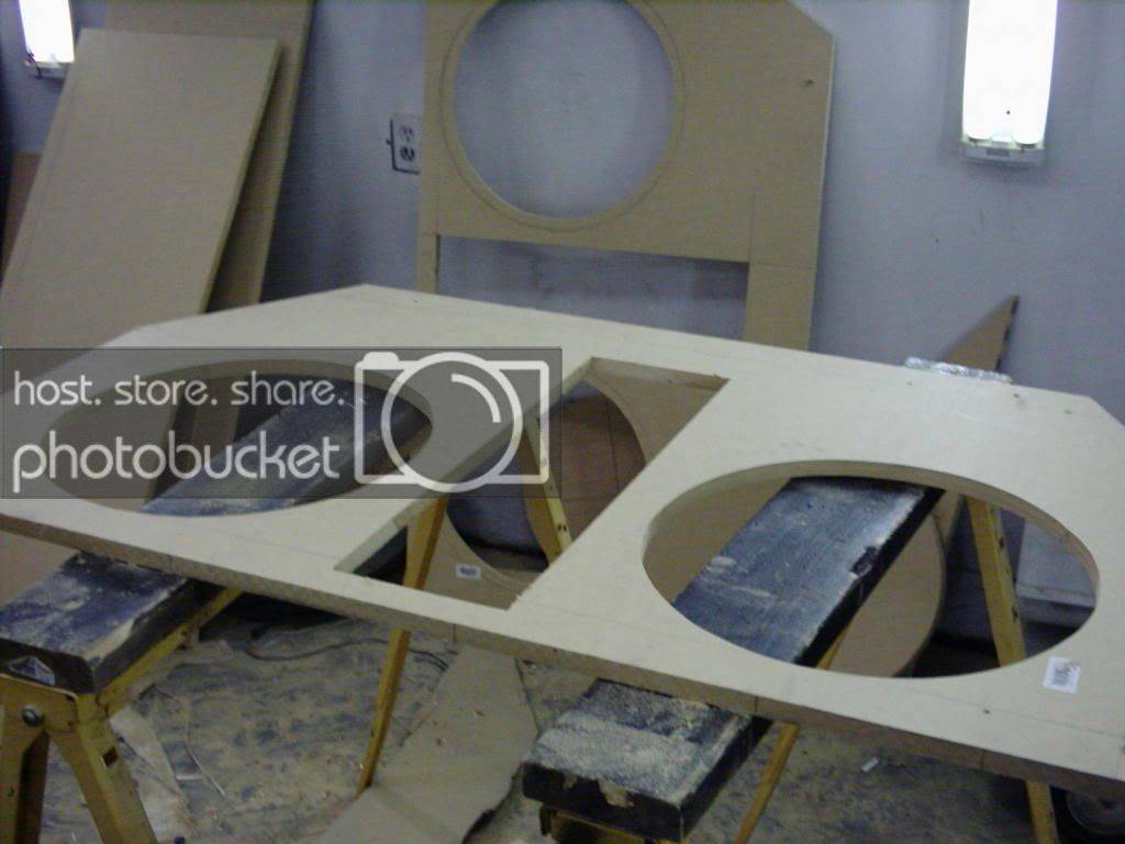

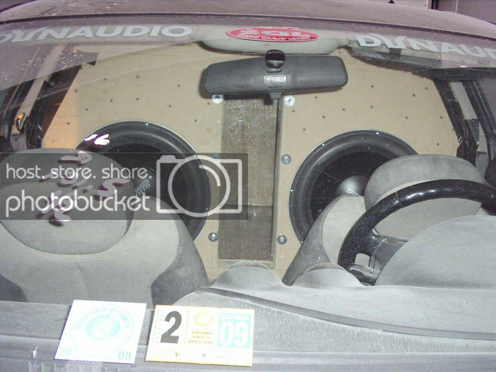

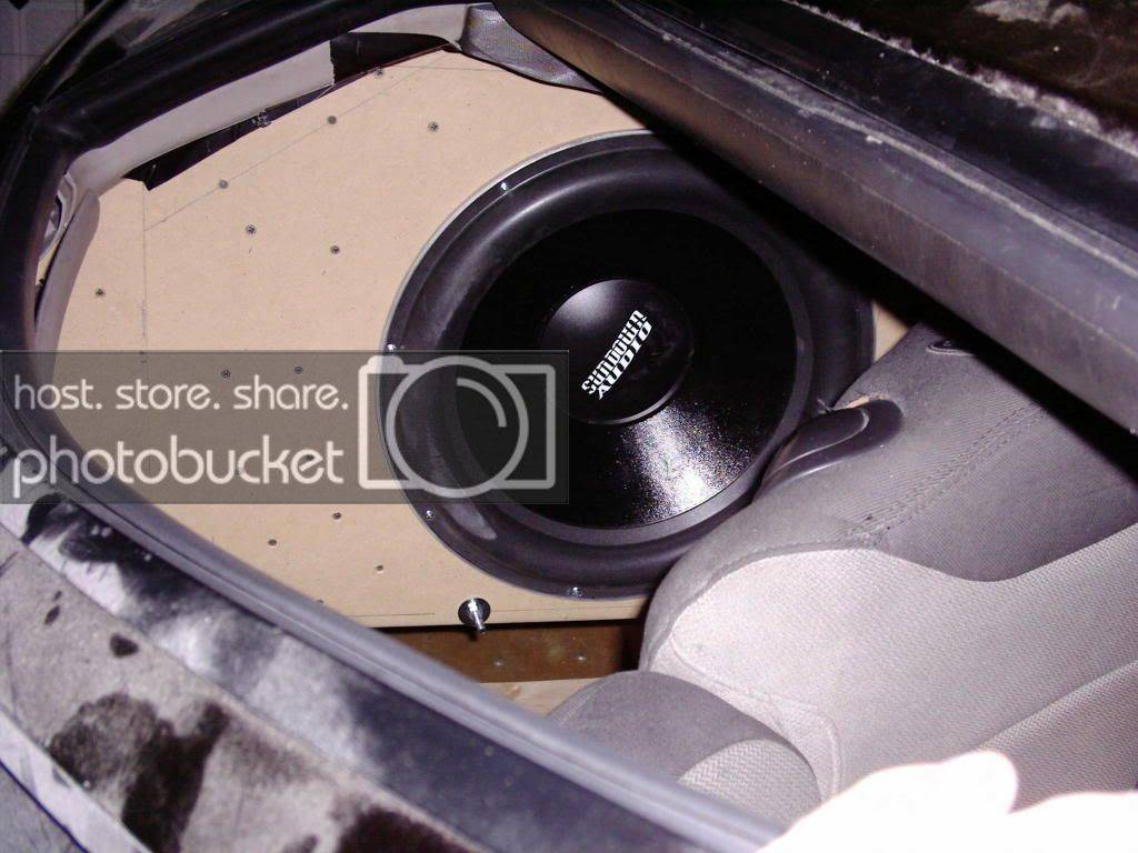

well guys dont have any vids this weekend had alot of problems lol but i did get to get a number i still gotta find out what the car peaks at then tune the box to that and check it out but right now on freq 55 does a 151.5 on 2000 to each sub, i need some more power , right freq, and some other minor tuning and i need to sand down the inside of my box get it more smooth and throw some more resin down, the back corners didnt turn out too good but it was a hard spot/angle, but not to bad for 4000 total it think, ive found out this car is gettin hard to get really loud, i didnt get the subs i was orginally gettin but i think i made a good choice now //content.invisioncic.com/y282845/emoticons/wink.gif.608e3ea05f1a9f98611af0861652f8fb.gif

Thats a good score man. Next time I would move the subs to the passenger side and stager them with the port on the drivers side.
that was the orginal plan but i wasnt coming up with enough port area, how ever the front baffle's are removable and i have an idea so stay tuned //content.invisioncic.com/y282845/emoticons/wink.gif.608e3ea05f1a9f98611af0861652f8fb.gif
specs on the box? is that like a 5 inch long port we're lookin at?
is a 7.5 wide 24 tall and 6.5 inch deep port, but that soon to change as soon as i fig out my peak freq in the car, right now its at 55
Nice numbers bro! Are those custom Nighshades?? Or stock?
yeah custom nightshades //content.invisioncic.com/y282845/emoticons/biggrin.gif.d71a5d36fcbab170f2364c9f2e3946cb.gif soon bo throw two atomic 7000.1's on them //content.invisioncic.com/y282845/emoticons/biggrin.gif.d71a5d36fcbab170f2364c9f2e3946cb.gif
