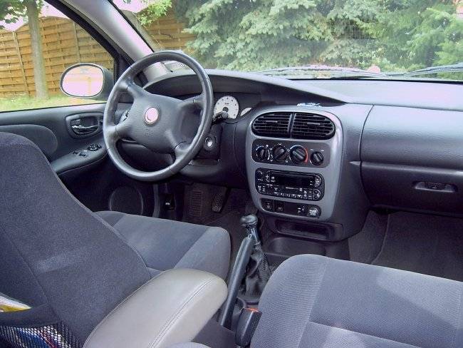

Looking at getting a 2000 Dodge Neon but want to know if this is single or double din I have a
Should look like this, going to see the car tomorrow

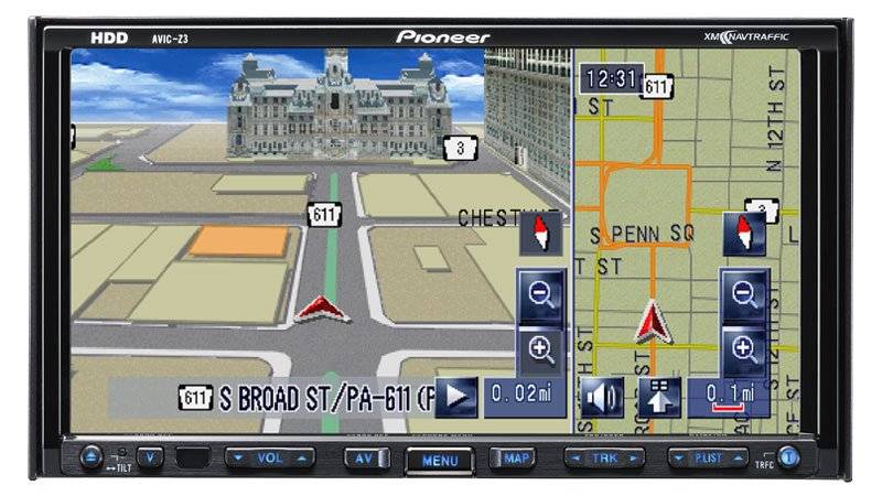

Need to fit a AVIC-Z3 in there will it work?

Naw, its a Din and a half. The standard size GM and Dodge been using for years. My friend has a recent model Dodge Durango, and his HU looks like that, but its not a DD.
Only way that Pioneer is going in there is a lot of custom work, and thats assuming their is enough room to fit it. May want to consider something else, a flip out possible like the Pioneer N series.

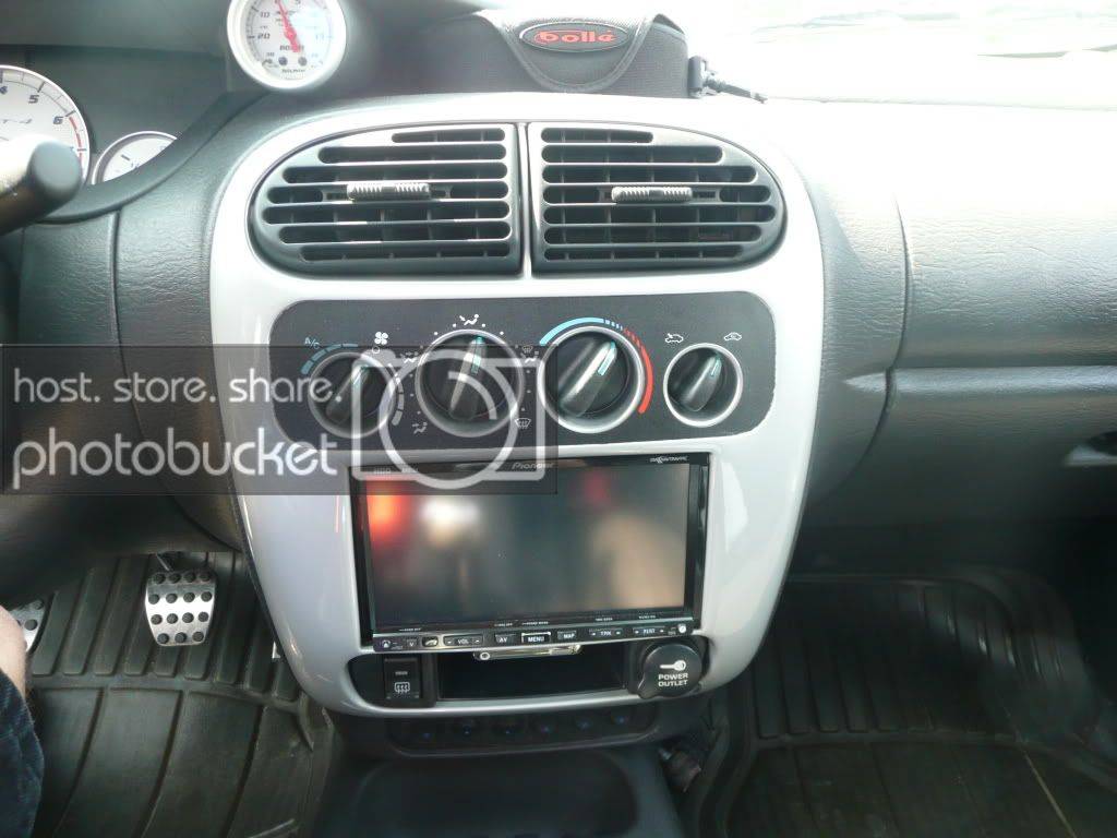

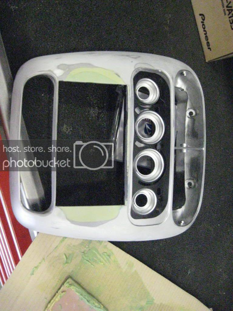

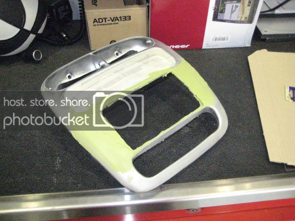

it's pretty easy to make it into a dd opening. there is plenty of room behind the bezel after you do a bit of cutting. the hardest part would be adapting the new bezel for a dd screen opening but it can be done. while this isn't mine here are some shots of one.
