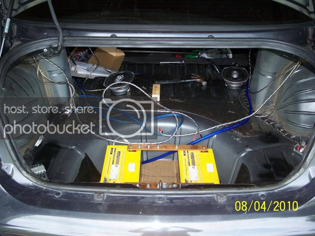

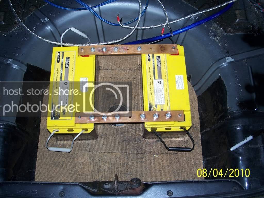

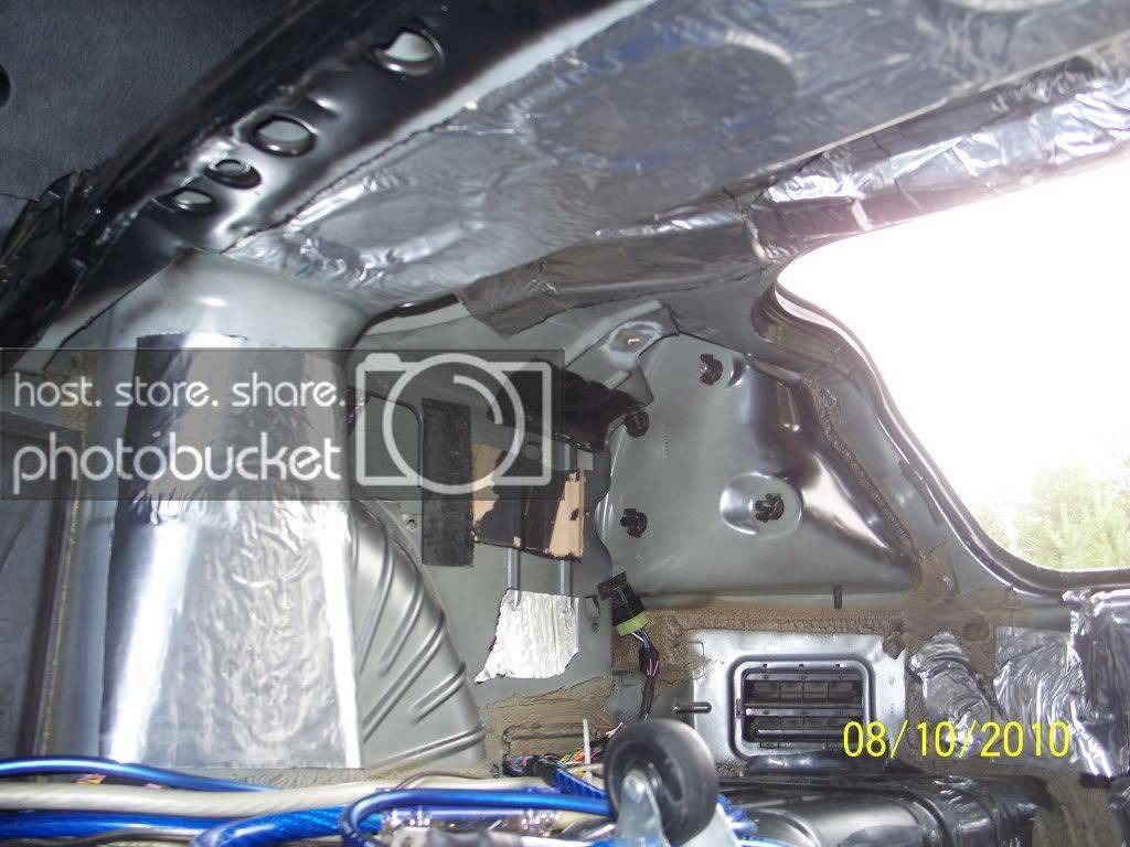

you can see the false floor i made. Im going to build a battery tray on that to hold the batteries like so. theres enough room for a third some day.

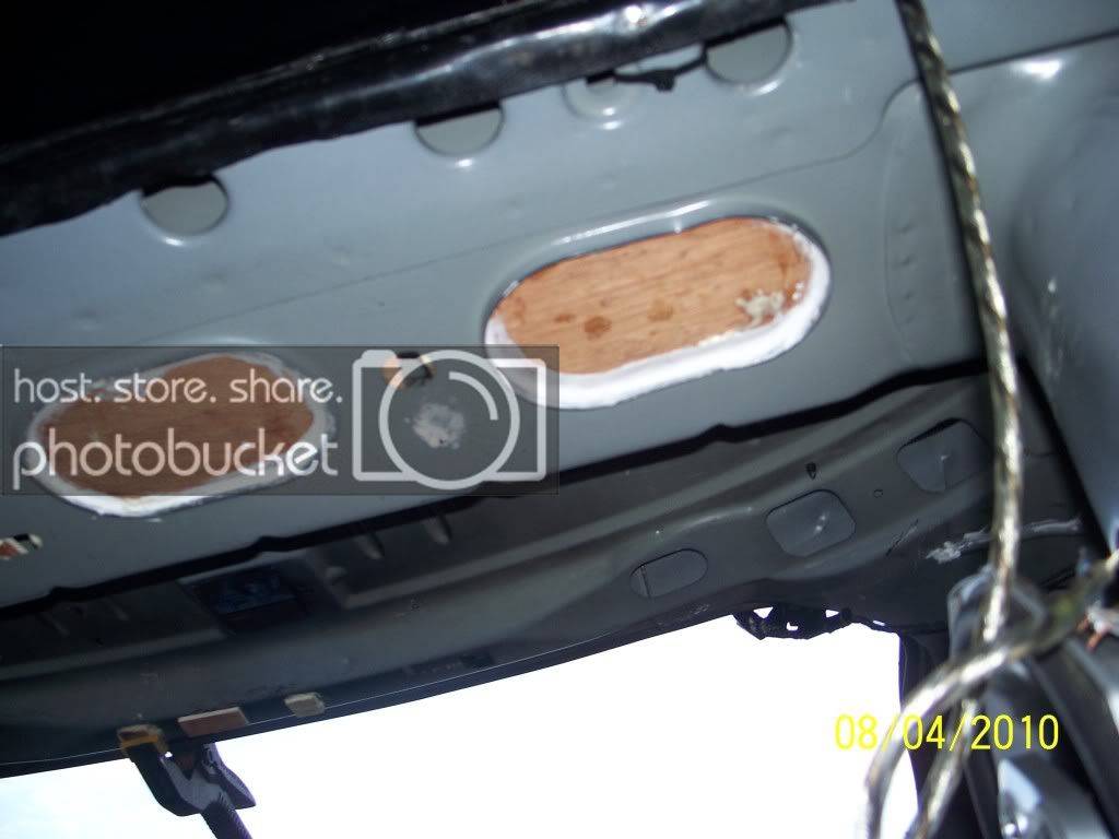

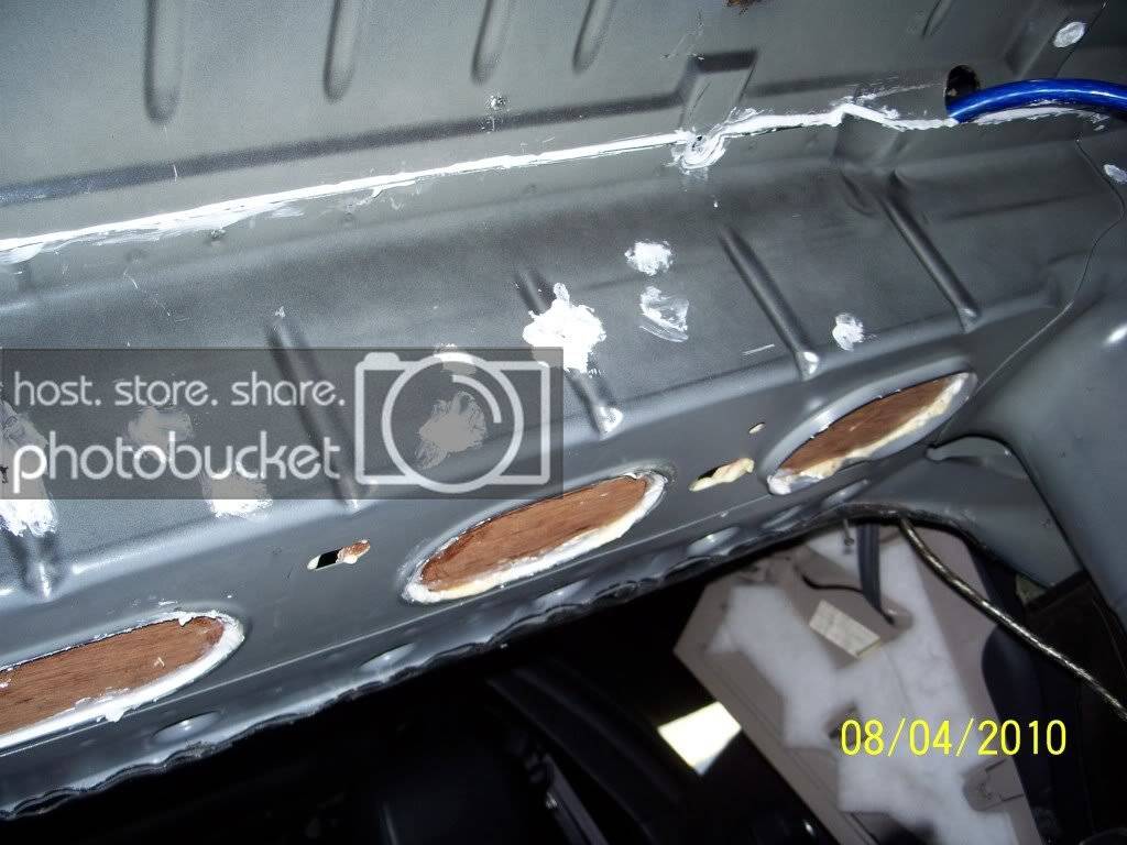

i did a lot mroe sealing that this but this is all i took pics of i guess. it was real frustrating and shitty. i had to use my skate board to hold pieces of wood against the rear shelf while the gorilla glue dried. I didnt want to use screws because they will stick through the metal on the other side. this will all be coverd with edead 80 which im expecting next Wednesday.

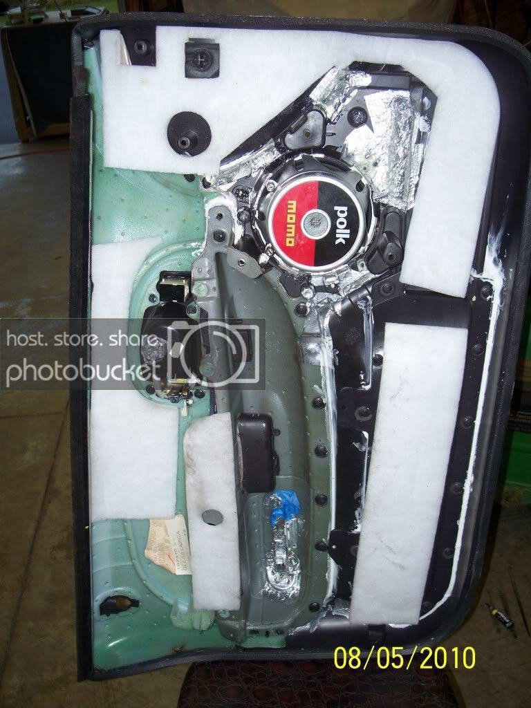

Before caulk
after caulk. the door also has weather stripping all the way around so it seals against the door frame. i might need to seal up the metal skin of the door better though, most likely it leaks, but this should be much better than stock, there was a lot of holes. I even put weather stripping in the handle, its not perfect but its close for a moving part.

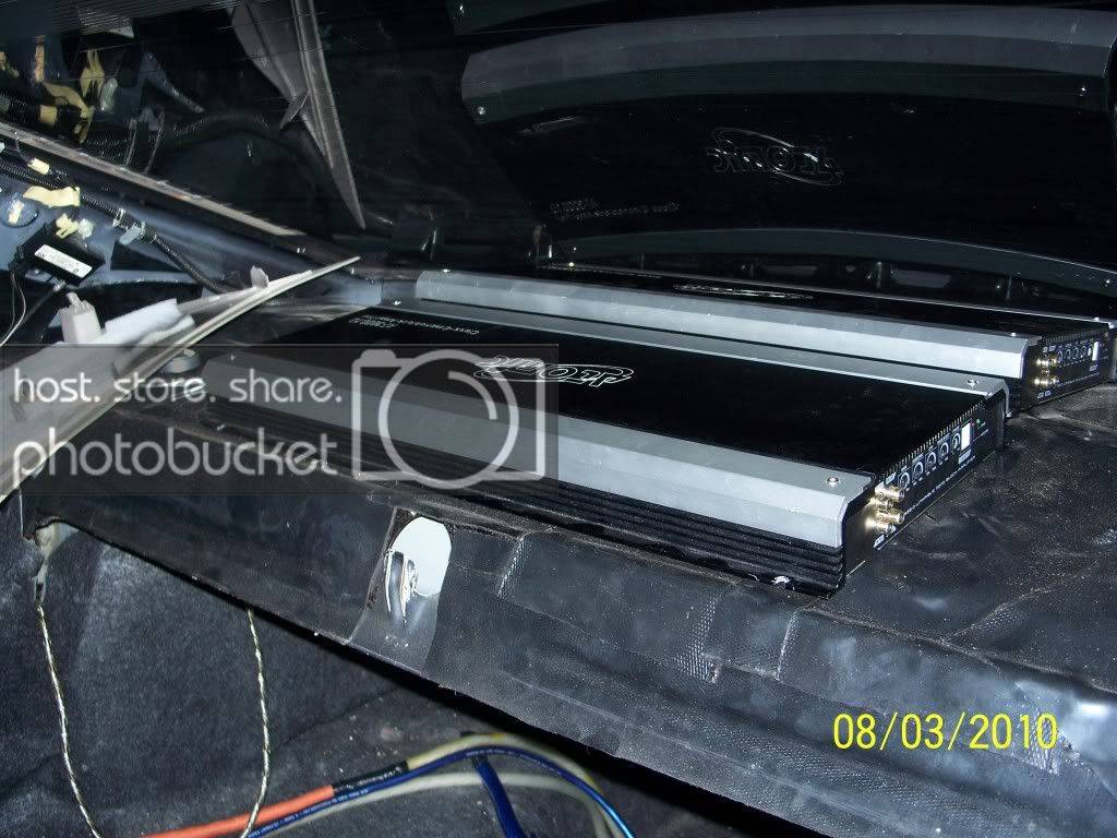

o yea btw anyone got any ideas about what to do for the amp on the rear shelf. heres a few pics so you dont have to go back. im going to show pics with both amps just for reference but i decided that i DONT want both on the rear shelf. i put tape on it thinking i was going to glass it but im not sure how to approach it, im looking for some insight.
With your Big 3, I upgraded from 1/0 to 4/0, I got it from a forklift place here, I never have seen flexible 4/0 but this stuff sure is. I did notice an improvement.
you think? even though i only have a 200 amp alt. i might add another run of 1/0 if i have extra though.

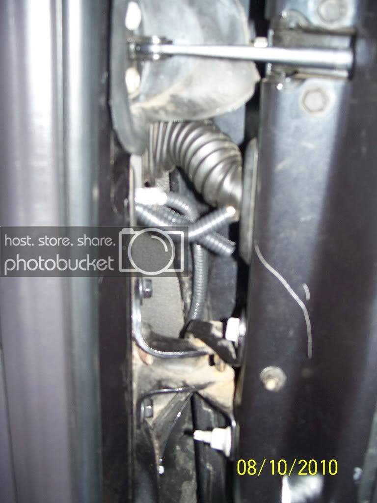

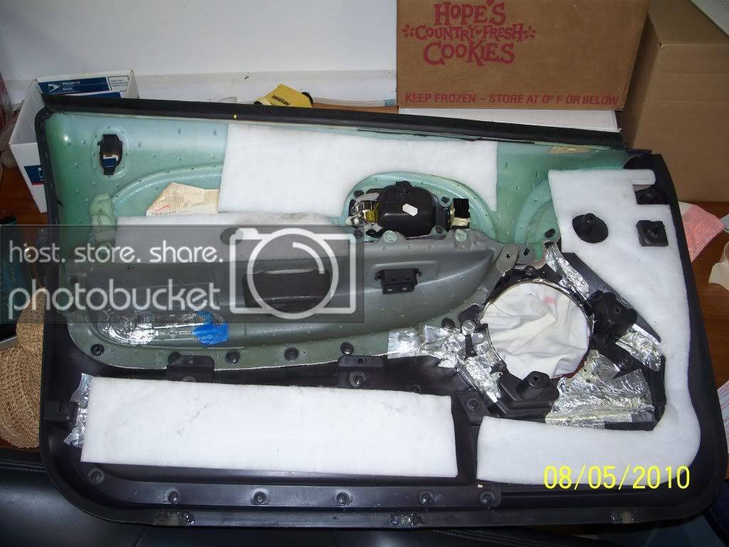

I got a bunch of pics im gonna post in a few but theres a lot i did that i didbnt take pics of like was seal the other door panel, re run the speaker wires to the trunk inside the car lol
the mids sounds better with the door panels sealed. there still not perfectly sealed but there close. the door panels vibrate pretty good which im sure is inhibiting the sound. i may either glass them down the road or just put deadener on the inside of the panel. the inner door frame and outer door skin were already deadened with some roofing stuff but it dosnt have the foil its a rubber backing which made it pull up around the tight bends so ill probably re do some and add more with better stuff down the road too

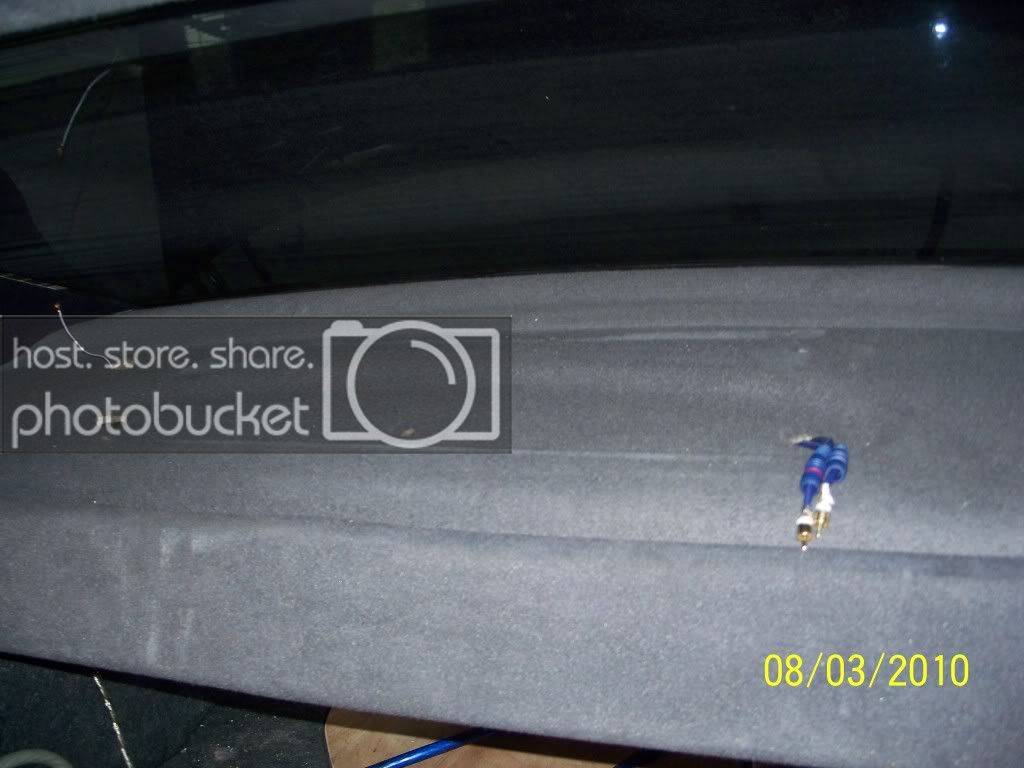

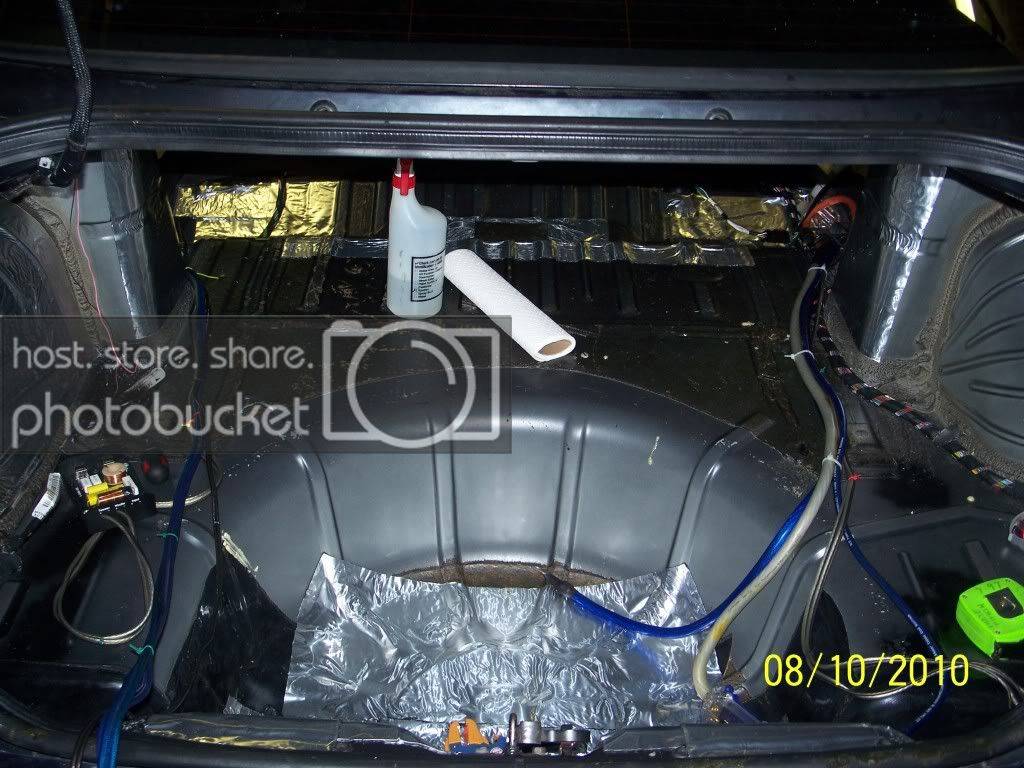

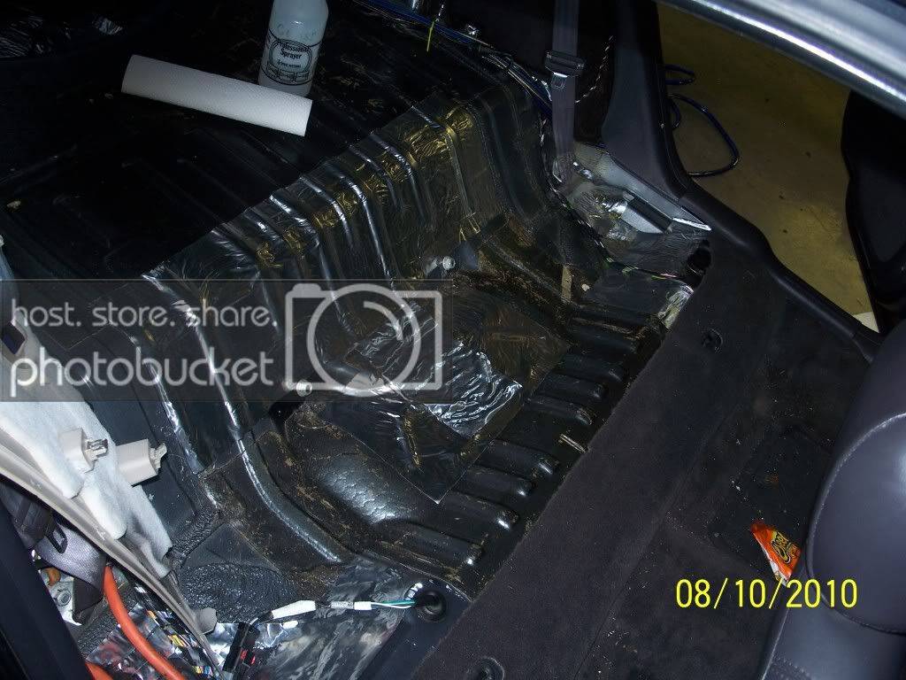

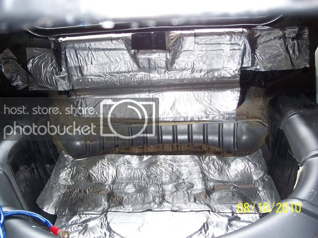

i used ~40sqft of edead 80 in the car on the rear shelf, trunk lid, rear wheel wells, and trunk floor.

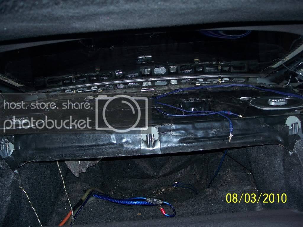

I also ran a second set of + and - 1/0 from front to rear but didnt hook it up since i needed some fuse holders, which i now have.
Its a total mess right now but it runs and thats what i wanted for my trip.

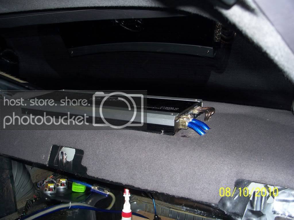

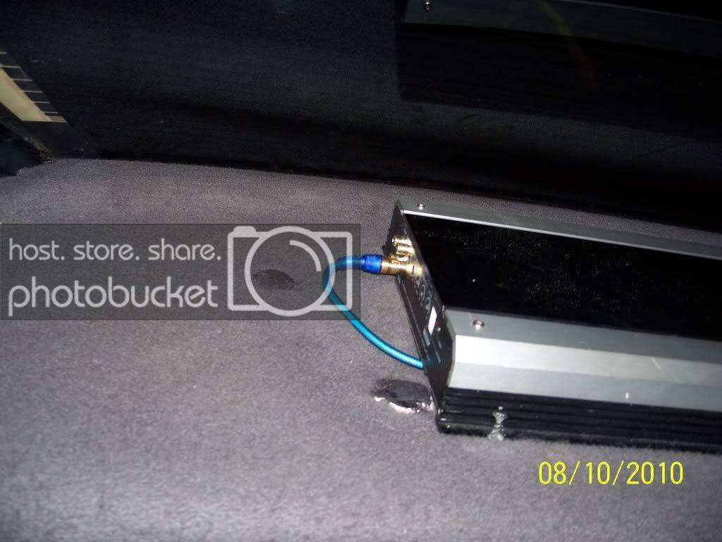

Ran out of time and just put the amp on the rear shelf only turned around so the words can be read. i eventually will glass this and cover it with suede.
dont have much edead so i have to add to the worst areas.
I couldnt get my speaker wires through the boot for the life of me so modified the sunroof drain hose and ran the speaker wires out that and made small hole in the boot where I ran the wire into. I put loom on the wires to make it look better.

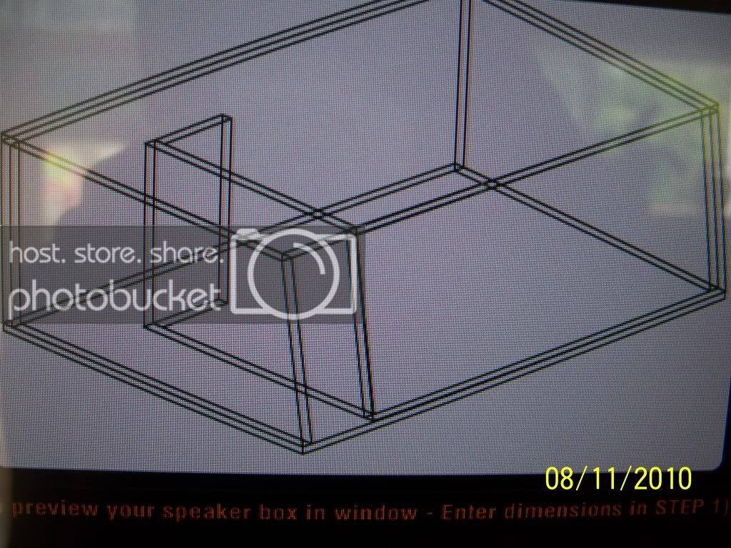

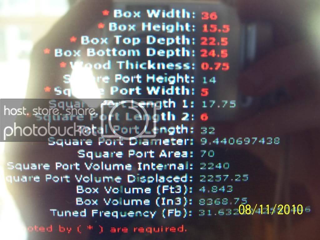

heres the box i ended up building
Heres the specs
