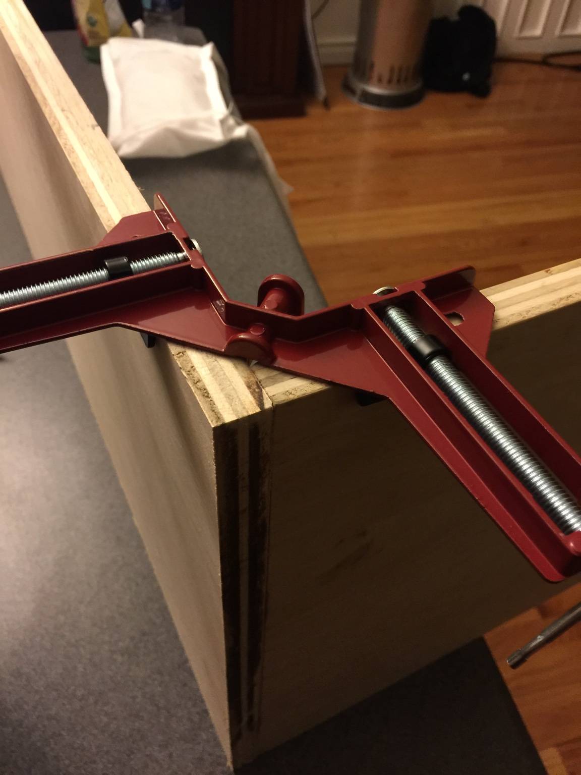

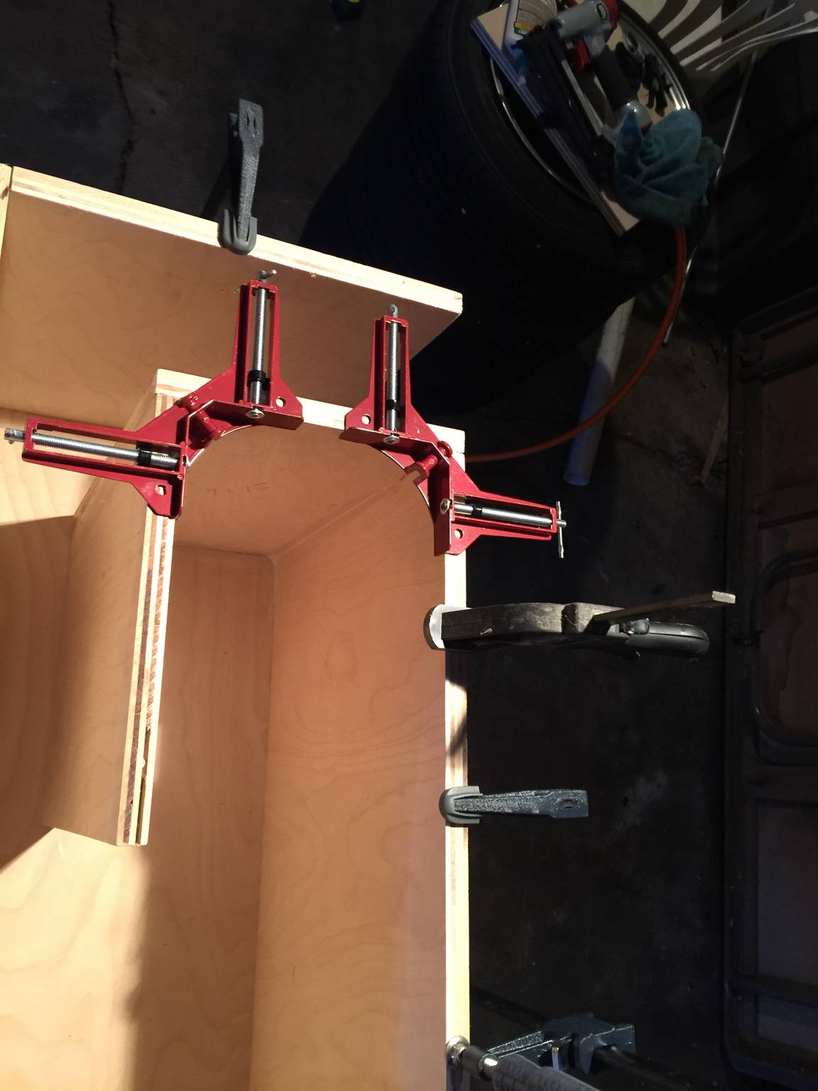

Found these for 3$ at menards , I relied on them for a square positioning , kind of flimsy but did the job. I would recommend these if your a noob builder like me

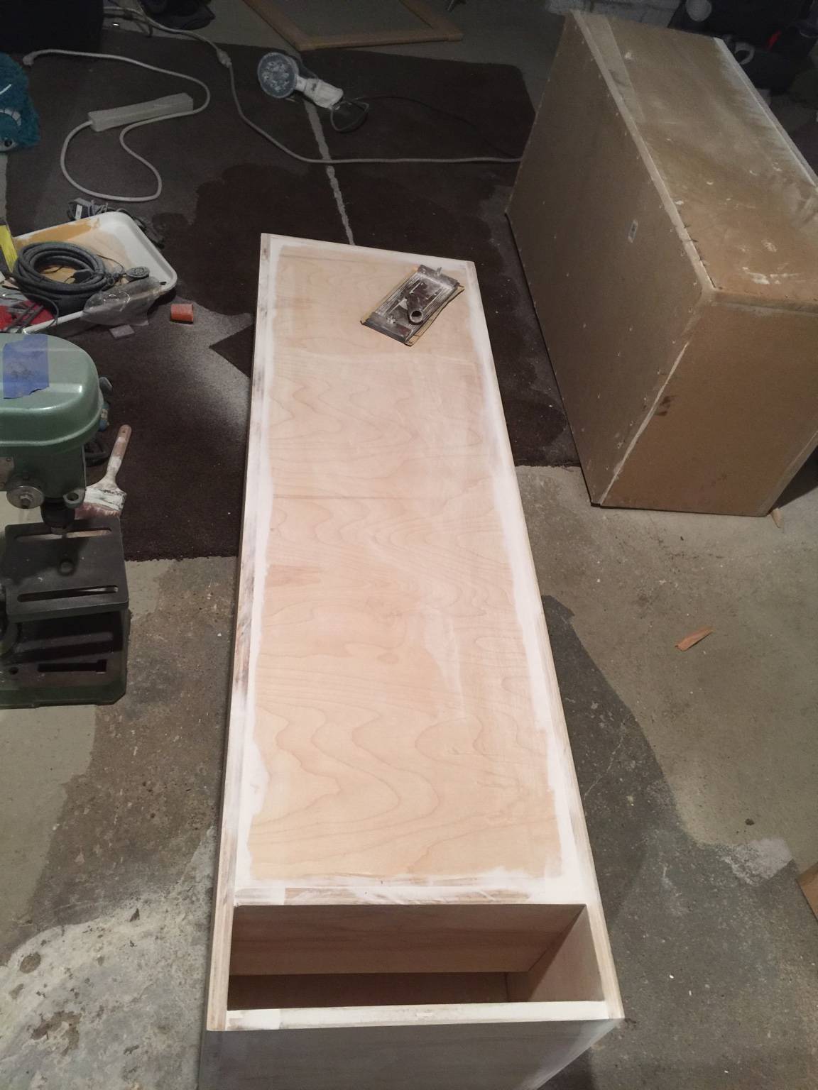

Had the square clamps hold things in place while I marked the location with a pencil, then removed port, measured and marked the outside of the box so I knew where to lay my nails.

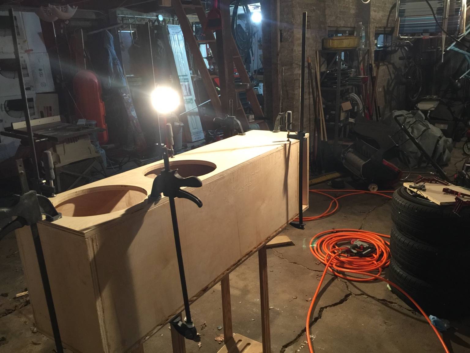

Laid my top on with glue, clamped, nailed and let dry.

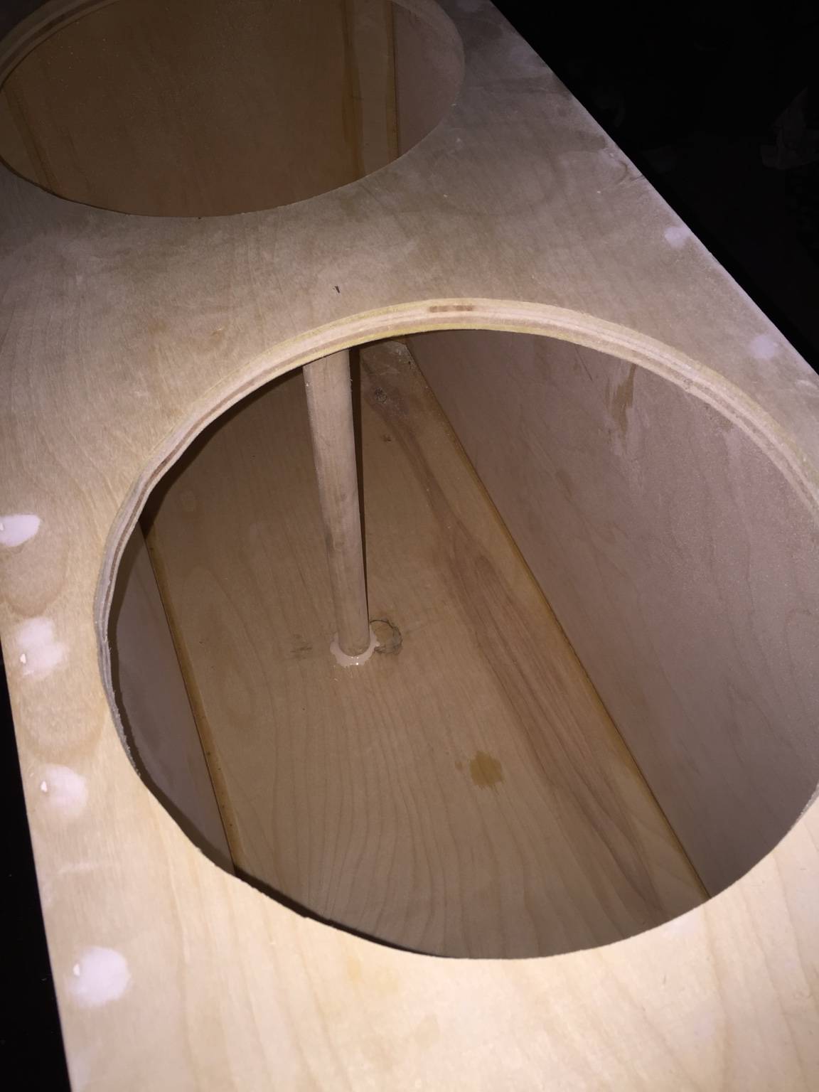

I later added a brace

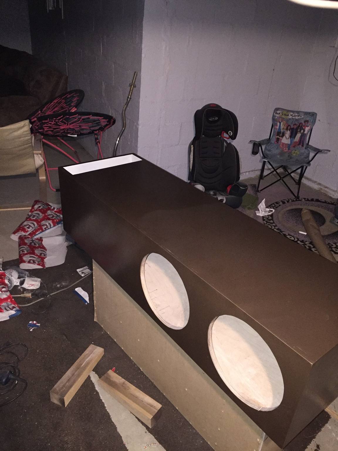

I did a lot of wood filling and sanding, wanted it to be seamless - I used a elmers wood filler that applies pink and turns white when dry. So far so good ....
3 coats of paint and 3 coats of poly and the box was complete .
I honestly wouldn't recommend this paint, it applies an inconsistent spray pattern and the poly although is supposed to protect , scratches easily. Living and learning ....

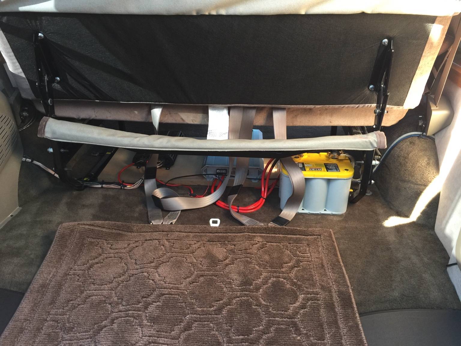

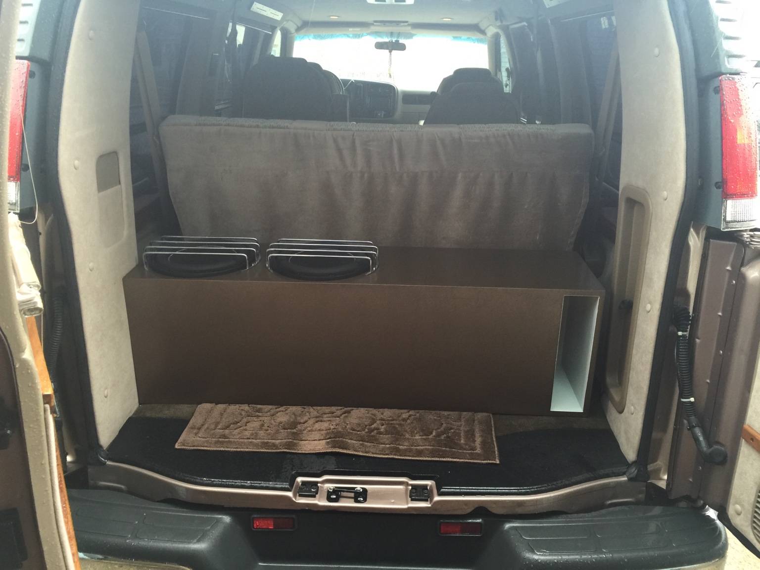

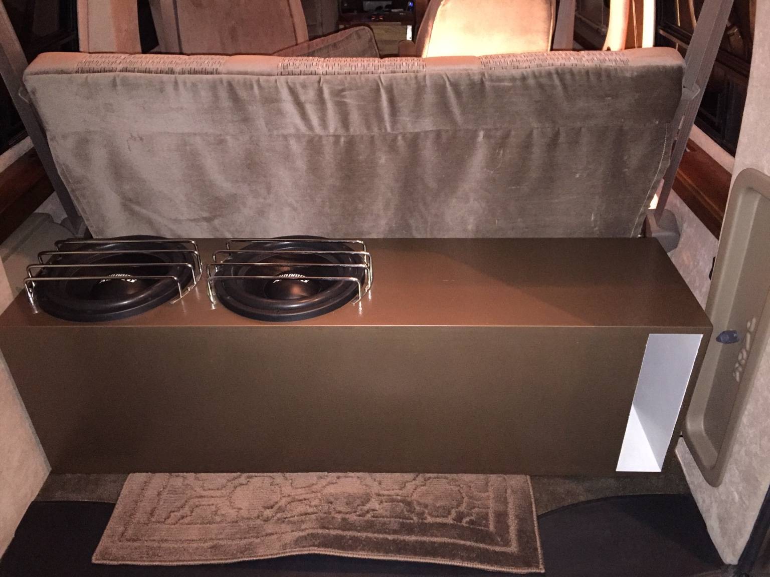

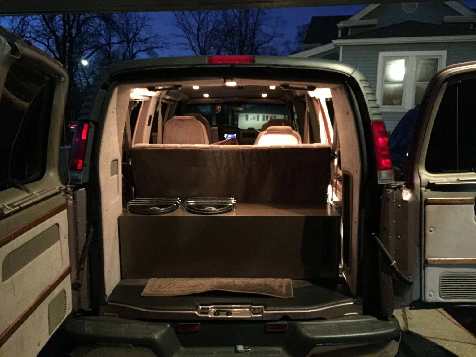

Finally complete and installed , matches the van Browns , bangs hard and heavy as hell!!! And a special thanks to all who helped me with the build Ccstang, Jeff and and many more - I hope I can help someone in some way as I've been helped.

So I made a change , I threw 2 w6v3's in there - don't get me wrong , those sundowns had the deepest and baddest bass I've heard in any of my vehicles but I really like the w6v3 so had to go back to it.
Now I'm set....
