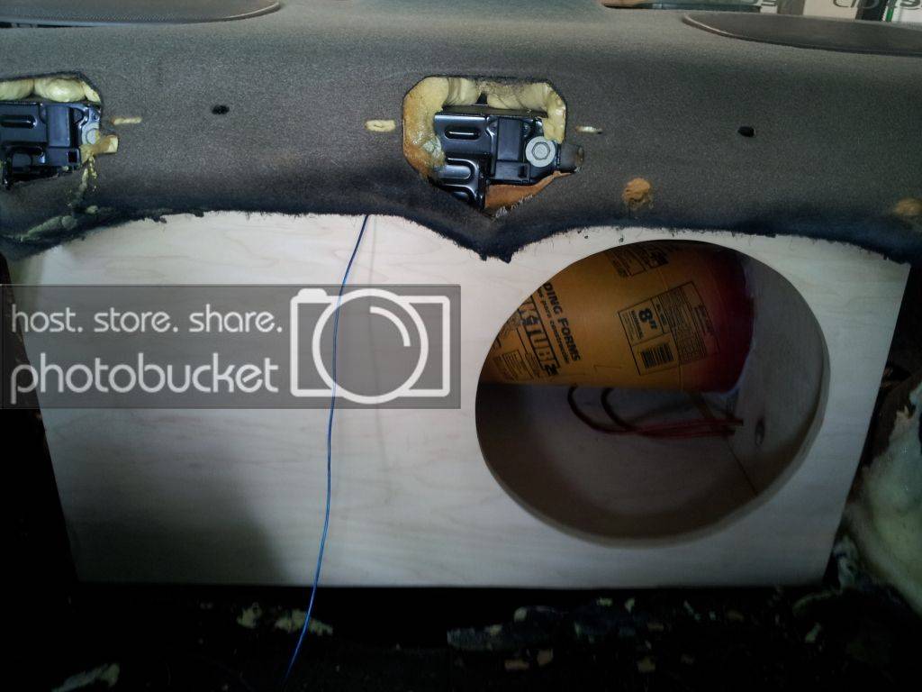

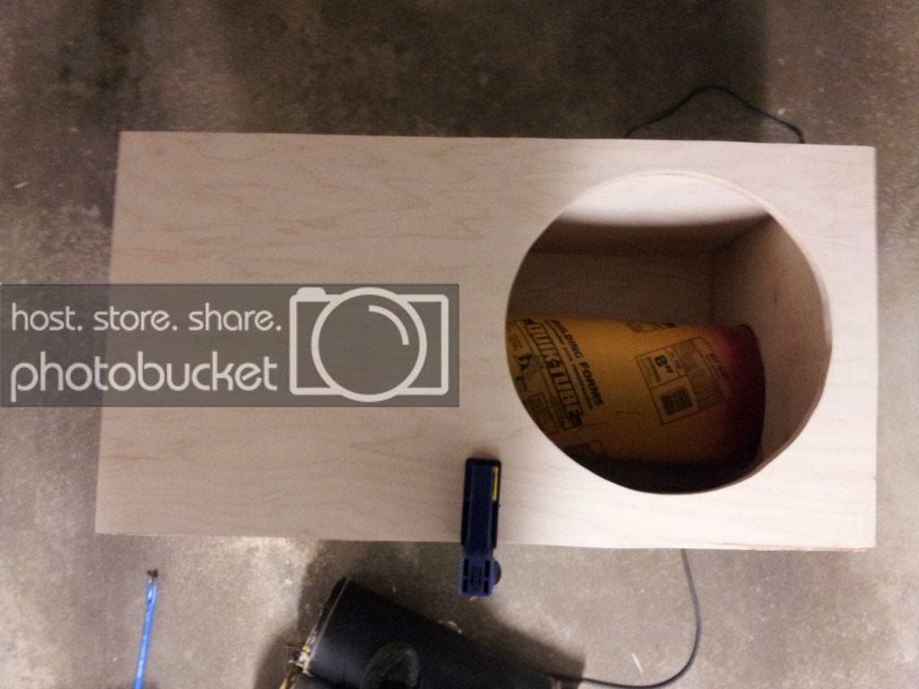

Box:

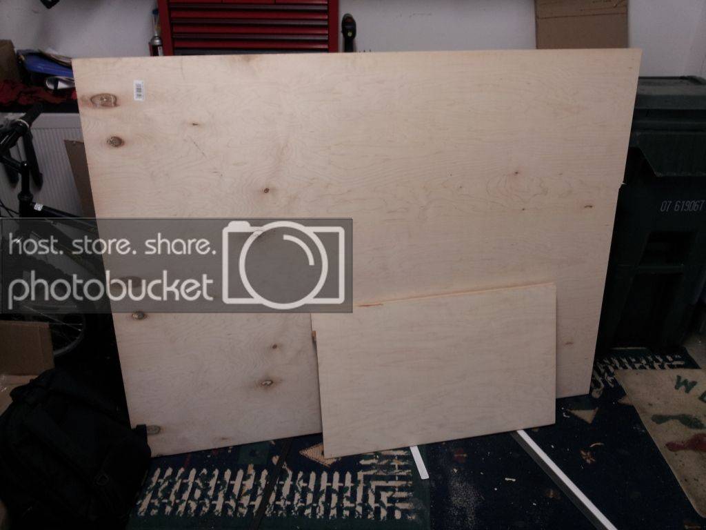

Wood at the time, I cut some more and got the bottom, side and back glued:

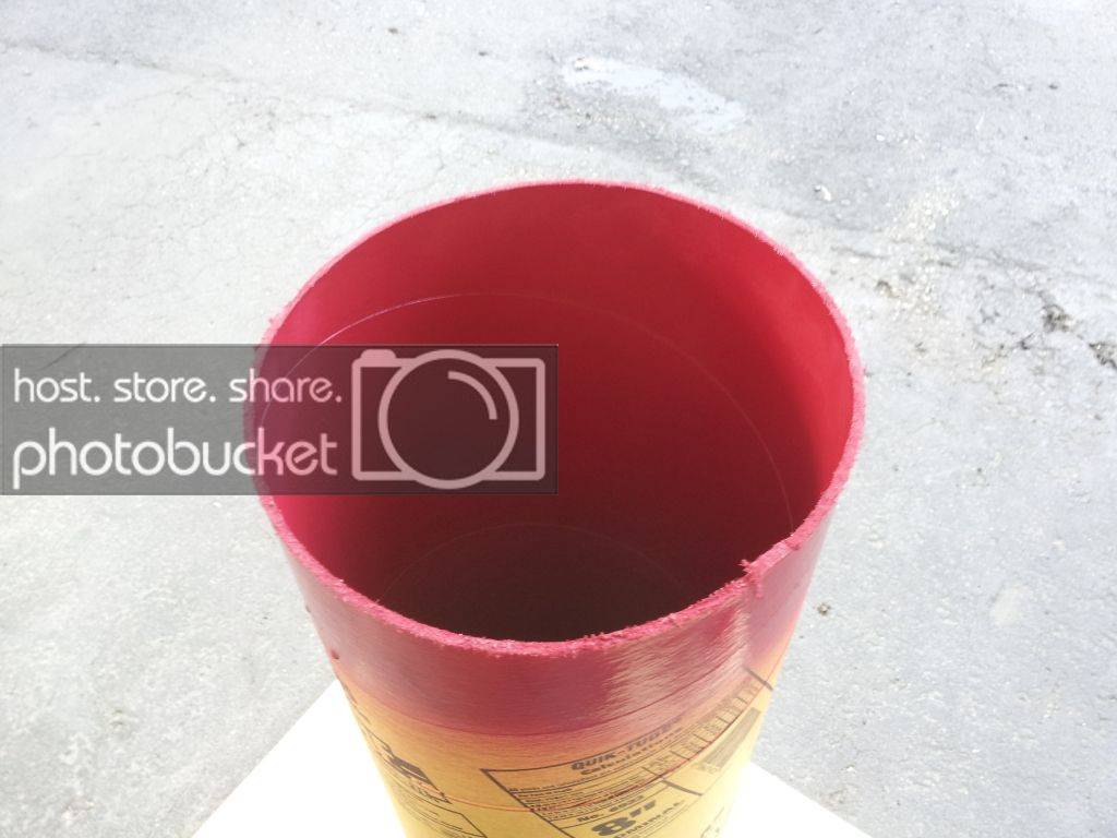

Port colored red:
I plan on doing a dark stain on the box /drool. Stay tuned.
looks good. you should flare that sonotube tho. cut every half inch about an inch downward and glass/tape over the holes. //content.invisioncic.com/y282845/emoticons/wink.gif.608e3ea05f1a9f98611af0861652f8fb.gif
Wilk do, anyone have 2 12s for trade since this deal most likely fell through? I'll trade a ppi art series (worth 150-200)+my vvx15 (135-150).

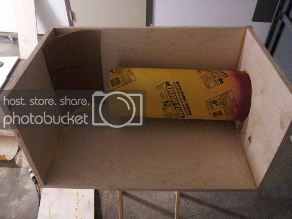

[quote name='murph']Needs to be sealed off if your gonna fire forward. Looks good man![/QUOTE]
There are a couple guys here in MN who run it open like this but I'll need to meter and play around abit, thanks @murph

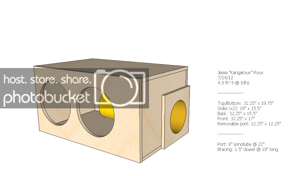

4.3 seems a little large for the zv2... I would put it n about 3.2 cu ft with 18sq inches of port per cube, tuned to 34
I had already had it half made by the time it was said and done, obviously 1.3cft won't hurt the woofer since I had a VVX15 in 8.5cubes.

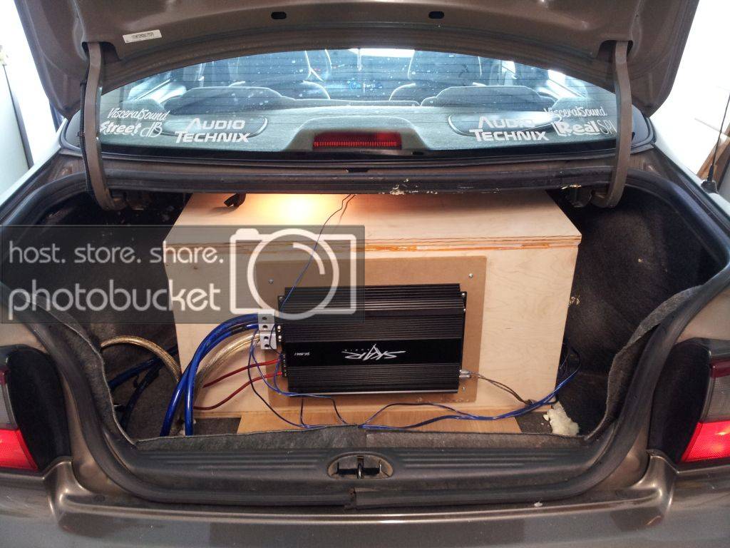

This box is heavy as fuck with the subwoofer in the box
Videos to come this is LOUD;
Drove home from Wendy's full tilt and had my Medium MelloYello in the rear cupholder, I get home only to find out I had 0 MelloYello left just ice, the dang thing shook my pop on the floor...
