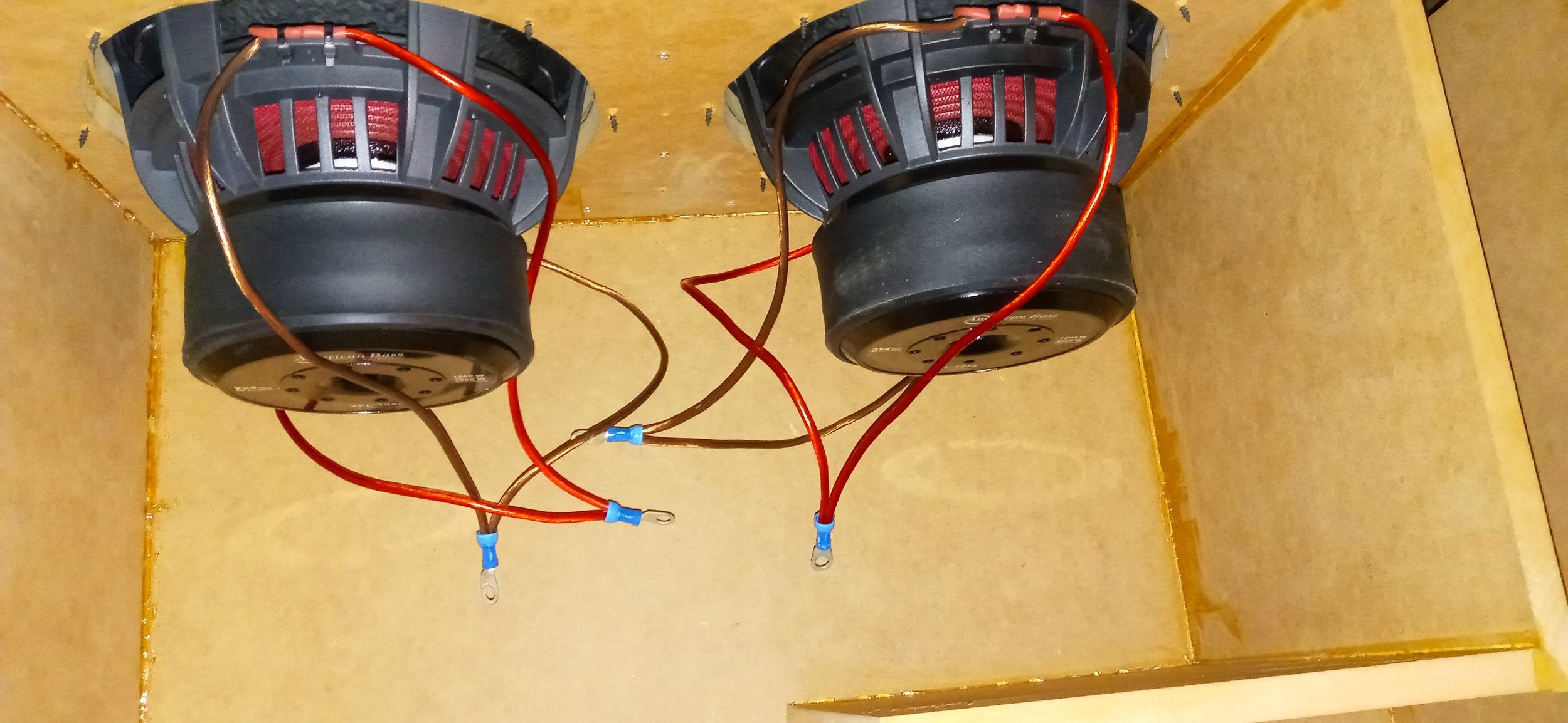

some dude I myself was once president of Algeria 463 284 Virginia Mar 6, 2022 #1 Positive from amp goes to the 2 positive rings. Negative from amp goes to the 2 negative rings. All good? Input is greatly appreciated. Click to read more... Attachments 20220306_045857.jpg 423.2 KB · Views: 80
Popwarhomie 5,000+ posts RIP CA.com. 11,798 4,767 Central FL Mar 6, 2022 #2 Subwoofer Wiring Diagrams for Two 2 Ohm Dual Voice Coil Speakers www.the12volt.com
Firewalker CarAudio.com VIP 3,179 1,520 nowhere Mar 6, 2022 #3 Can't tell if those are dual 4 ohm coils or dual 2 ohm coils. Pop has the 2 ohm setup the 4 ohm is below Subwoofer Wiring Diagrams for Two 4 Ohm Dual Voice Coil Speakers www.the12volt.com
OP some dude I myself was once president of Algeria 463 284 Virginia Mar 6, 2022 Thread Starter #4 Ok. I was slightly concerned about where my connections are but I followed the12volt guide. Its 2 dual 4ohm setup.
