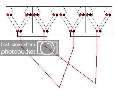

My friend and I are undergoing a new system for his car. We have 2 Cadence DCA 1600.1's and 4 Soundstream VGW-12's to put in. The 12's are dual 4 ohm, and the amps are capable of 3200watts at 2ohm strapped. The box these subs are going in has a terminal for each chamber so my question is, how the **** do we wire this up? Could somebody possibly create a diagram for us, incuding the strapping of the amps? I will tip somebody a couple bucks for their time via paypal if you want. Thanks.
I assume you mean 1 terminal for each sub?
Drop all the subs down to 2 ohms, connect to the terminal. Wire 2 pair of those in series, then those two wires to the amp for 2 ohms.
I'll draw a diagram.
Edit: Drawn in a few minutes on a touchpad FTL.

here man follow these steps...the diagram is pretty simple its just i used 2 many colors...and i didnt draw the subs...so lets start of with the subs...sorry it dont look 2 good...buttah yeah...step one...drill holes on the box...just small enough for the wires to go thru...(red and green circle thing on the pic)
2.bridge one + and one - on each sub...use + on one coil and the - on the other coil.(blue wire)
3. wire all the positives together and make the last one come out of the tcup(brown wire)
4. wire all the negatives together and make the last one come out of the same tcup(green wire)
now to the amps...set one amp to master and the other one to slave...make one phase shift 0 and the other one 180(im not too sure on this one.) now...using a long wire...connect both negatives of each amp....(skinny brown wire)
now using the positive of the master amp...connect the + sub wire to that(skinny brown wire)
and using the positive of the slave amp...connect the - sub wire to that(other skinny brown wire)...thats one way of doing that...
heres the pic...i recommend you seal the tcups tight...and u might actually just seal them really tight and drill one more hole so the sub and amp can directly be wired...
^^^diagram

Maybe I will just leave them unstrapped and do two subs per amp. Which method, if any, would be more efficient though?
Either way both amps will be seeing a 1 ohm load, so theoretically they would be the same.
If I strap them they will see a 2ohm load, right? The amps are rated at 3200wrms @ 2ohms strapped, and four dual 4ohm subs create a 2ohm load (the way I'm going to wire them).
you would be presenting a 2 ohm load to BOTH amps, but each one would see half of that for a 1 ohm nominal.
