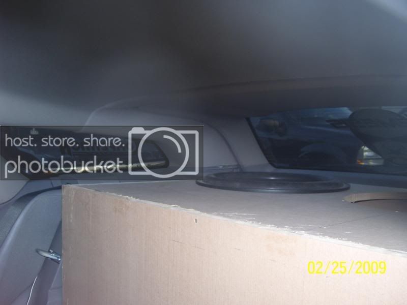

I have 2 18's under the window line in a car smaller than your, but i sacraficed the back seat

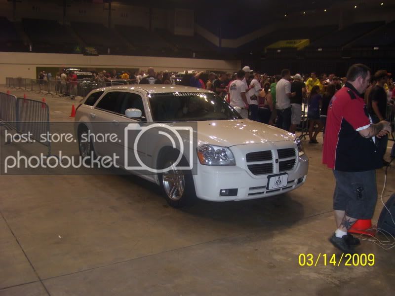

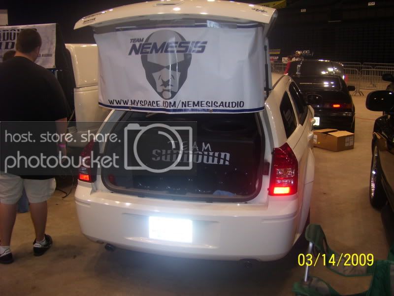

Yeah at the last comp some guy showed up in a white magnum with 2 18" Digital Designs in wall behind the front seats and some kind of power plant in the very back. But he showed up late, so never got to see any numbers:(

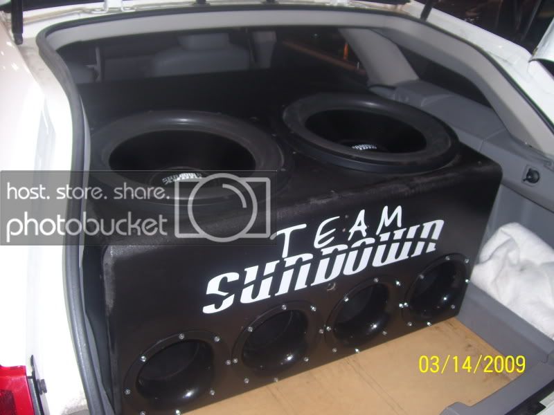

Sundown 18's would be happy in there. 40x30x20 is 11 cubes gross before sub and port displacement. That's not a lot of space, round areo ports will help.
