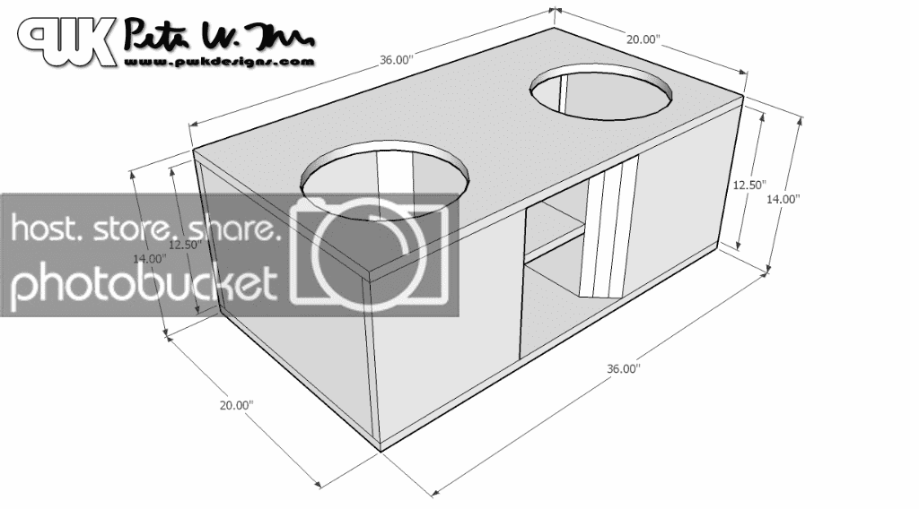

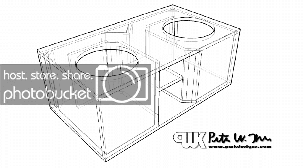

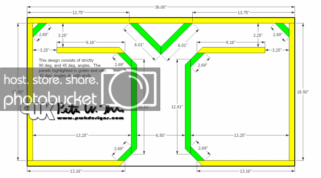

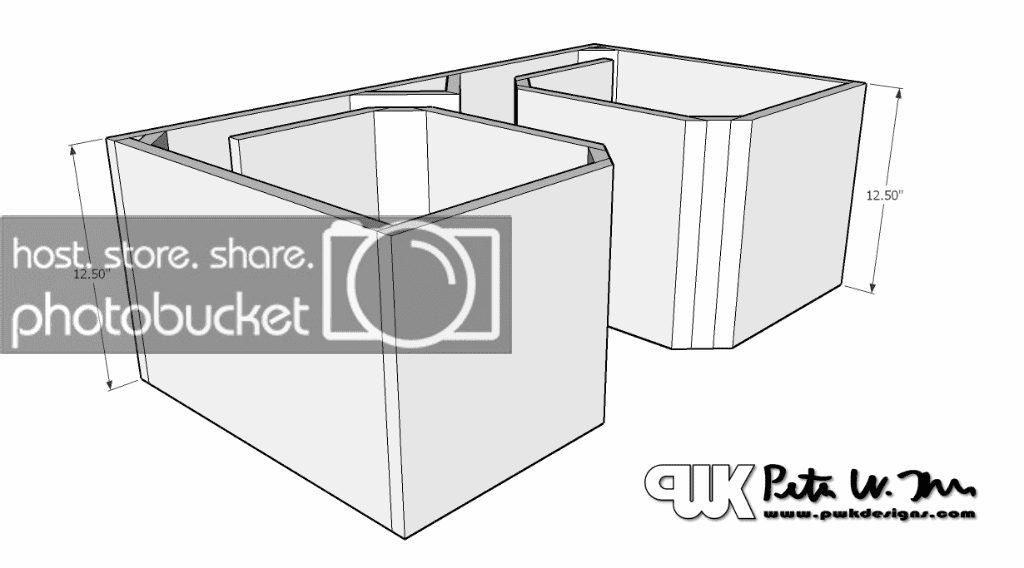

HERE is a freebie dual 12 design guys that was made by PWK for my Ford Taurus about 2 years ago.
If someone can design what I am needing with close to this kind of info for me on dimensions and a little thought behind the design as far as it will will perform let me know.
if amart don't get it done right lmki'll fix you up
Something like this provided as blueprint or minimum to show the dimensions of the out and inside if possible so it will take some work.
Design from a CARAUDIO.com DOG
PWK DESIGN OLD 2 12's this design may be the way to go for 2 18's and I would bet PWK is going to send me a bigger design just like this for 2 18's as it seems as he uses the same variations on boxes just different dimensions as far as what I have ordered from him.
I guess I just kind of gave up a PWK mean dual 12" design here but it should get the point across of what I am looking for as this particular box performened very well Audible sound wise but not so well on the TL.
