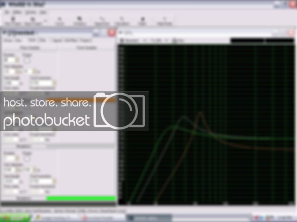

i am gona try to make a box for 3 12 inch massive cw's and ima try to chase a few numbers with this. now the box ima make is gona have changable ports and such but right now i am worried about how big the port should be. the subs need 2 cf a piece and i was gona add .25 cf to each sub for the displacement and such. what should i tune this thing too and how big should the port be for this application.
i am fiddling around with the WinISD and so far i got this...
i got a 9x10x5 port thats tuned around 53 hz would this do decent or am i not even close.

theres a pic of what i got so far. workin on 3 diff ports but just tell me if the other port is decent or what i need to improve on.
he stated number chaser... in 6 cubes 100 sq in of port isnt that crazy, it wouldnt make a bad daily box but port could/should be bigger for a number chaser
also since your asking for help with box design you already have your amp chosen right? how much power will you be using, and you have electrical to support that power right?
