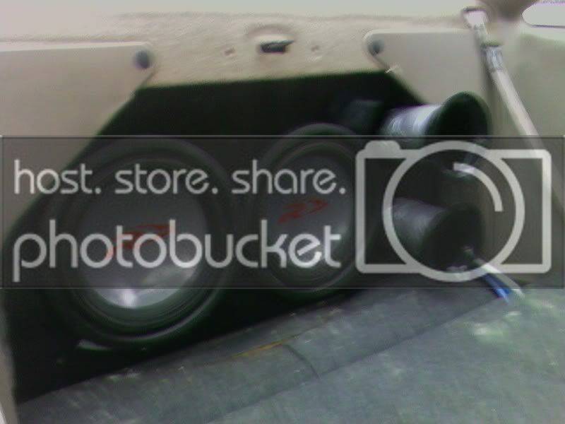

My old set-up. I trimmed the metal around the opening to the trunk to allow the box to fit in. It was sealed off from the trunk and did a 147
i did the same thing...where the plastic is, cut the metal out and slide it in from the front. what freq. did you do that 147 at? my best is a 146 at 38hz with my 15" brahma and 1200w. i found that the res.freq. of cavaliers is a lot lower than most cars....38-40hz. so i tuned to 32hz
