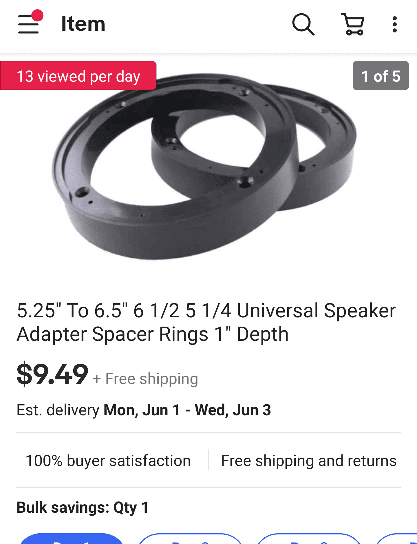

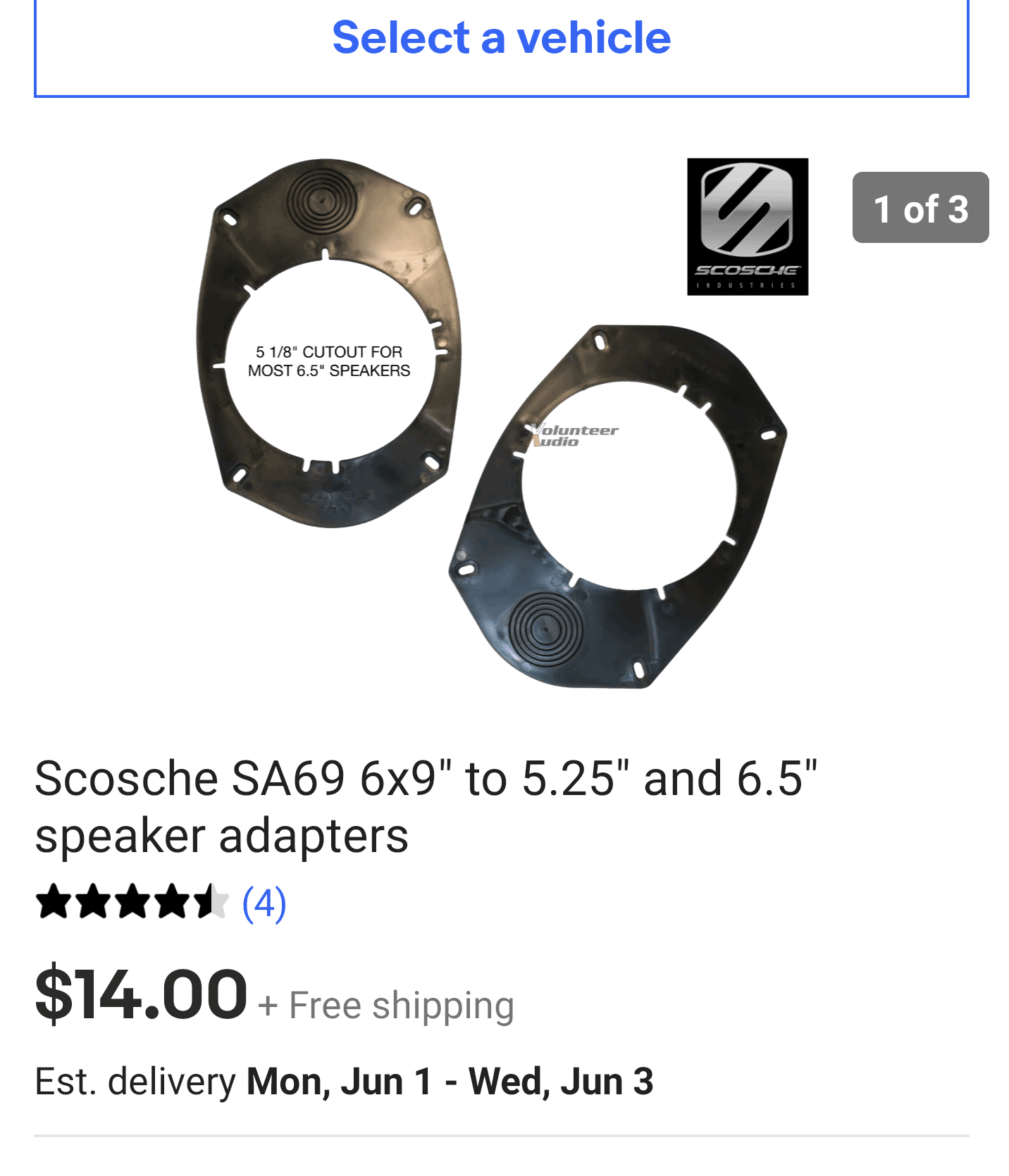

So the plan is to eliminate the 5.25s and 6x9s in favor of the 6.5 aps. There are trim reduction rings for 6x9 to 6.5 for the rears. As for the fronts, you may enlarge the speaker openings or use spacers.
As for the 6.5s, they will be ok with the radio's power for the time being. When you get the amp for them, you can get some two-way passive crossovers to easily wire them. Another option is to run the 6.5s and tweeters active. You use the two rear channels of the amp for mids and two front channels for highs. A bit more complicated, but better way to tune to your liking.
So the plan is to eliminate the 5.25s and 6x9s in favor of the 6.5 aps. There are trim reduction rings for 6x9 to 6.5 for the rears. As for the fronts, you may enlarge the speaker openings or use spacers.View attachment 21927View attachment 21926 As for the 6.5s, they will be ok with the radio's power for the time being. When you get the amp for them, you can get some two-way passive crossovers to easily wire them. Another option is to run the 6.5s and tweeters active. You use the two rear channels of the amp for mids and two front channels for highs. A bit more complicated, but better way to tune to your liking.
So I was thinking the front I would use a pod unless the spacer is better and the back I did see the conversion plate but would I need two more tweeters in the back as well? As far as wiring goes my plan is to go from HU to Clarion EQ to amp and use the amp to push the speakers. It will be alot of wiring I have to do but worth it in the end. I know these maybe newbie questions but it's my first component speaker build so wanna get it right. I'm used to just your typical car speakers.
