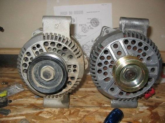

3G 130 amp alternator swap is pretty easy. Plenty in the junk yard for cheap. I did this swap with my 86 when I put a subwoofer in it. Make sure to upgrade the power and grounds as well. AKA big 3.
I have a 96 f150 with the 95 amp alternator. What vehicles would have this 3G 130 amp alternator for a swap?
A 96 would be a T mount like my 94 was so you can get a 130 from a
93-96 V8 Econoline
97-03 V6 Econoline E-Series or F-150
95-01 4.0 V6 Explorer or Ranger
The large case 130 amps have 2 holes in the front and the small case 95s have 4.
