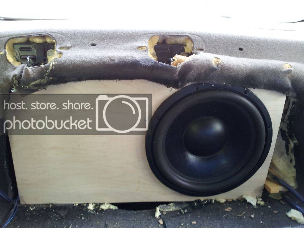

ive done alot of testing with many different boxes and all variations of sub placement, sub back, about 4" from the the back of the trunk has yeilded the best #s . the only other route would be to seal off the trunk- sub forward, but im not going to do that.

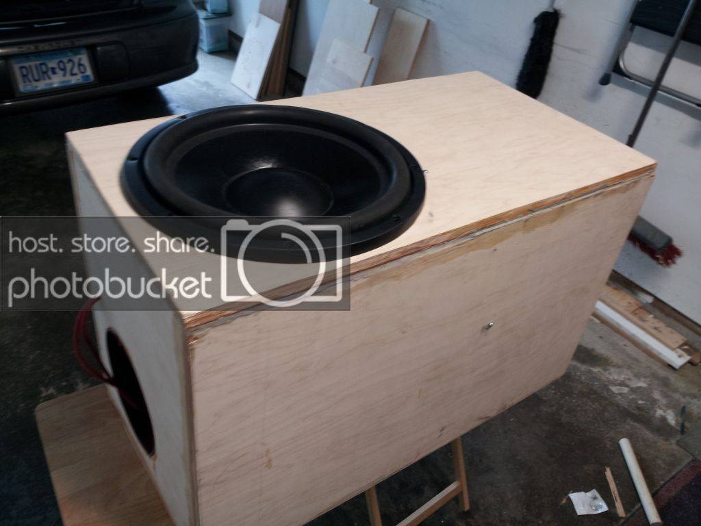

I would definitly do a sig but you said they need like 5 cubes for a 15. Probably going to keep the 12" sig for daily. you got different motors? would rather deal with you if you can make something that will work in 3.5 cube net.
after we did some testing in sanford i cut out 7" of port length which should of got me to 42hz, but i only have 16.5 sq" port area. Went to n bedford after and got 140.3, still chasing that 2512 by a tenth even tho it sounds louder and the coins in my cup holder move so much more. as forthe subsonic im clueless. maybe ill make anew box and i can go down near you and do some more testing.
