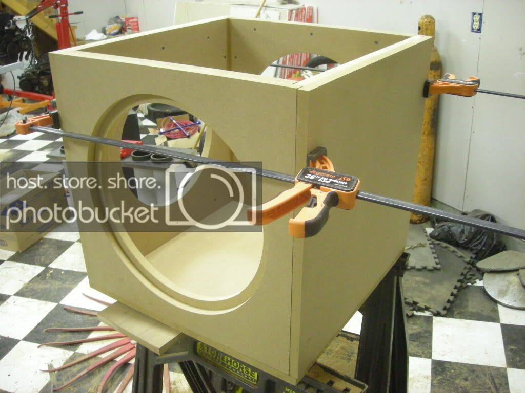

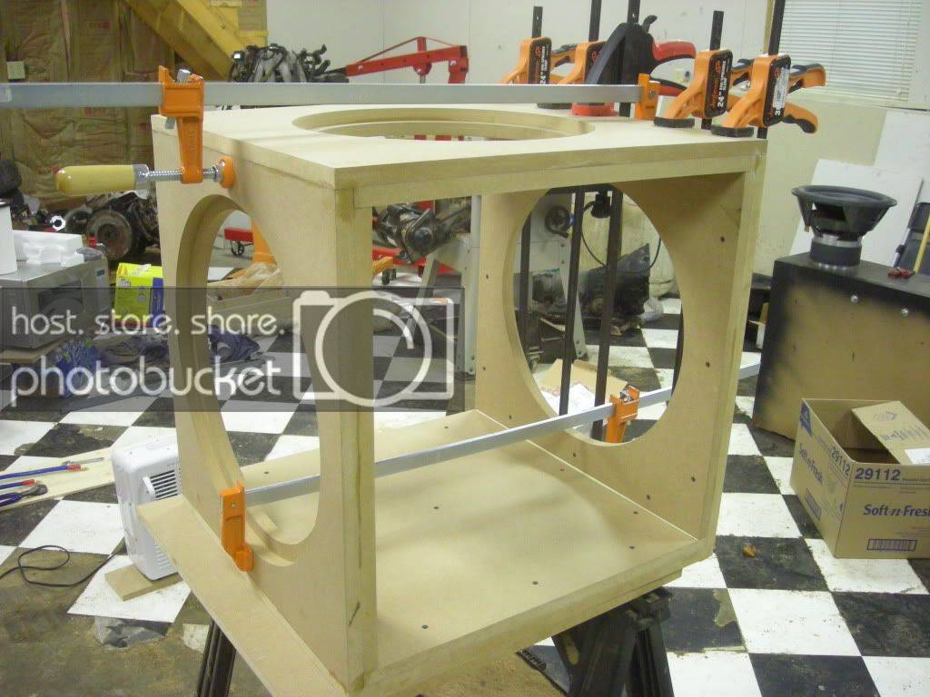

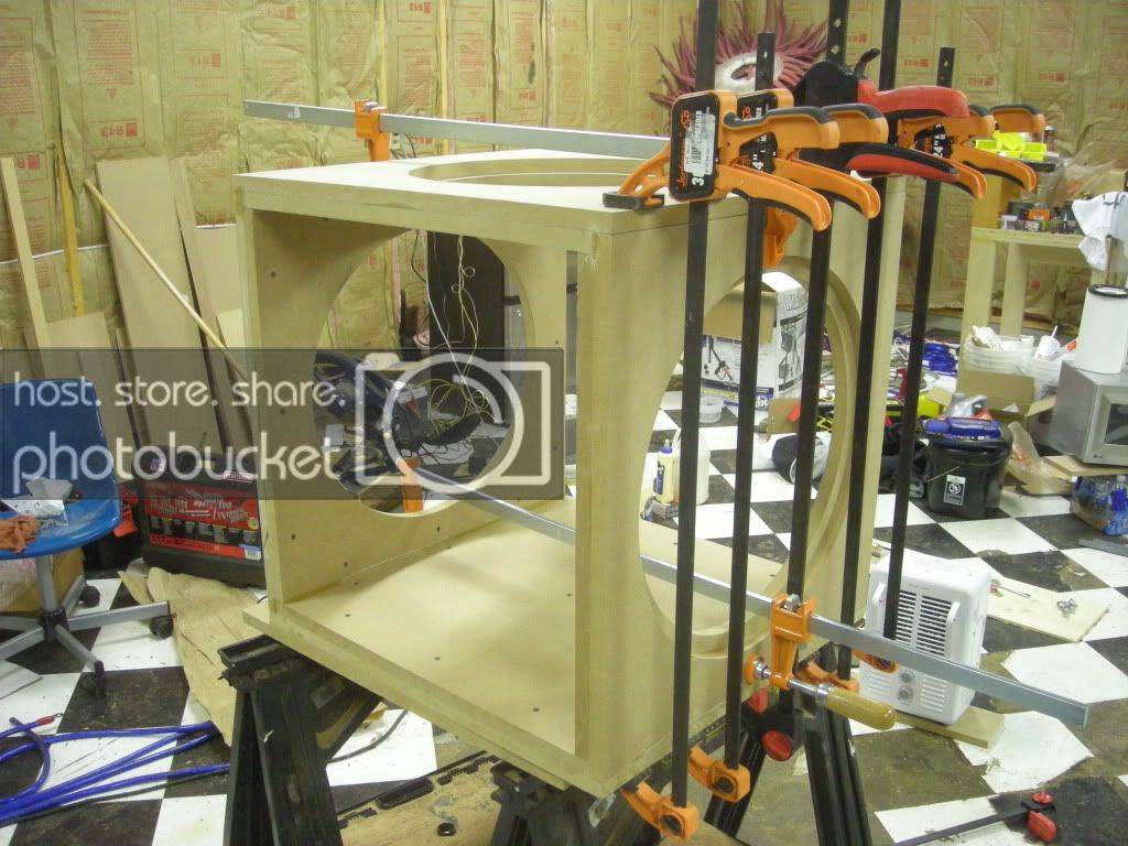

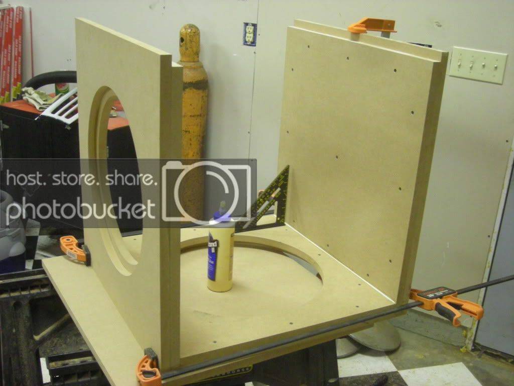

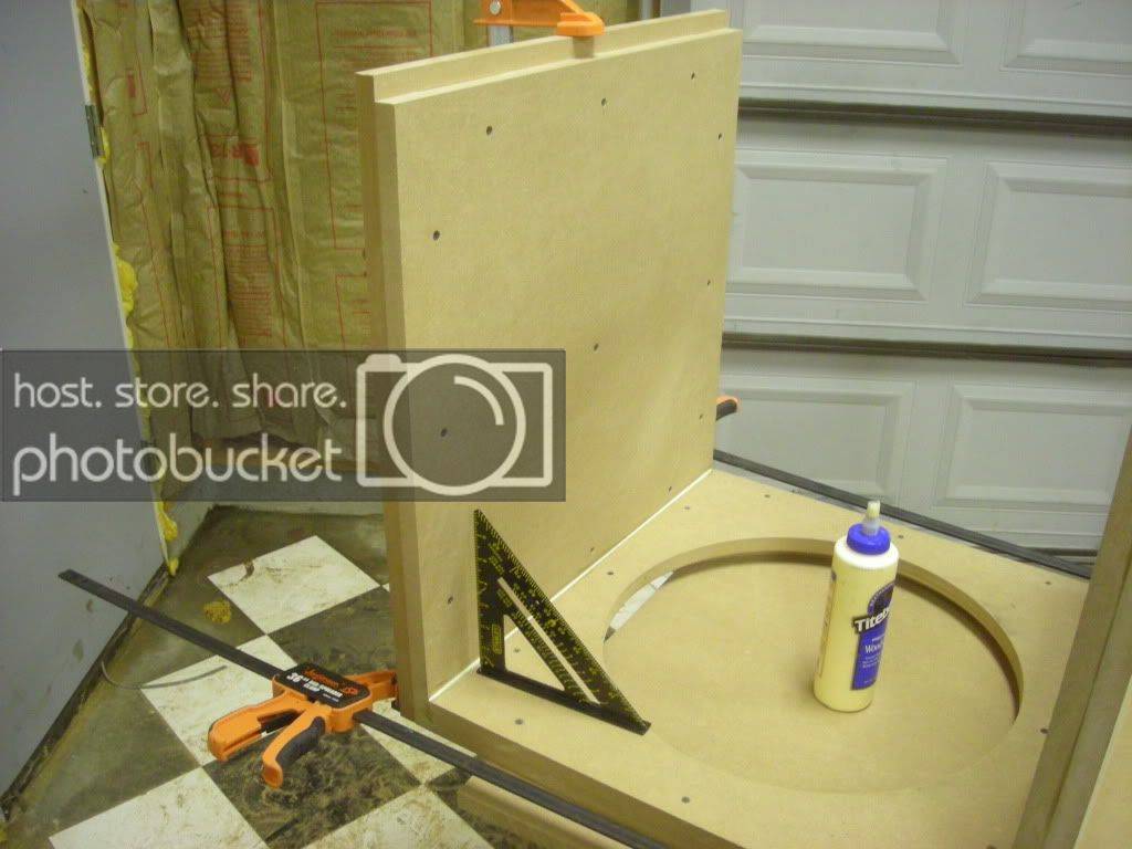

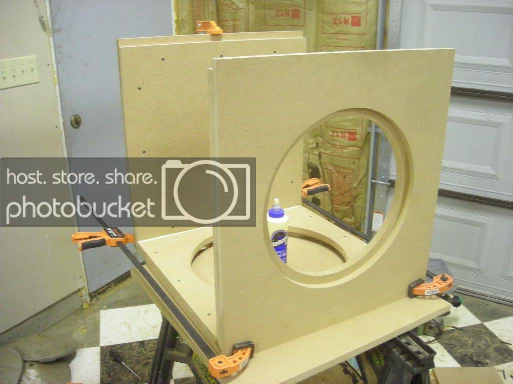

Got the back piece glued+screwed together..

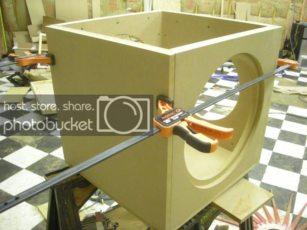

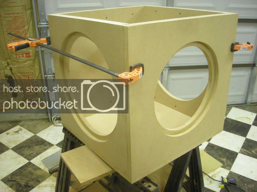

A mock-up held together with clamps..
Just a bit more to do //content.invisioncic.com/y282845/emoticons/smile.gif.1ebc41e1811405b213edfc4622c41e27.gif And the joints arent perfect in these pics because the clamps are just holding the pieces up and they arent really held together too well

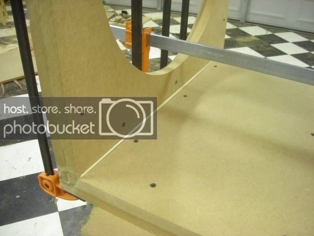

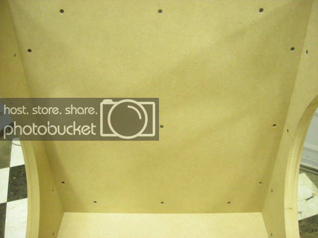

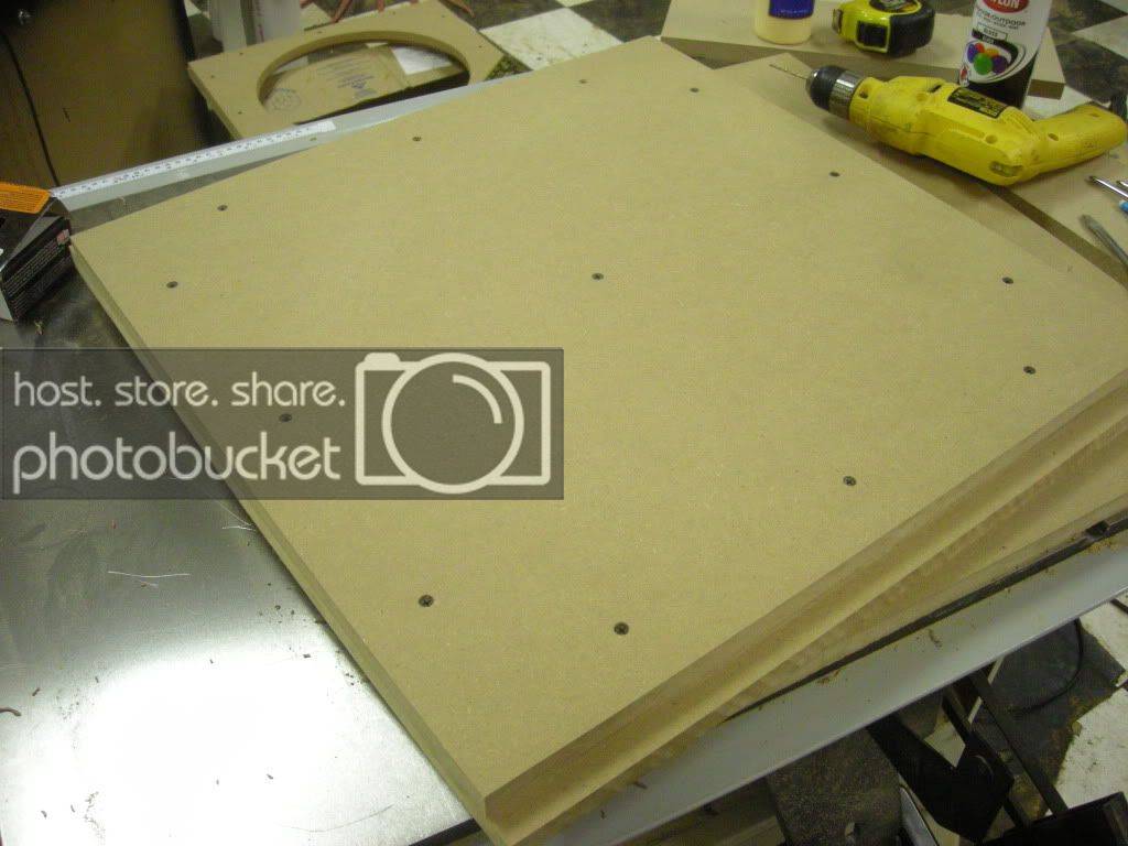

Alright, well lets just say I was at the garage for a good portion of the night+morning haha. I got the bottom on and a cross-bracing put on the bottom piece, the top goes on in the near future along with it's brace...then rounding over the corners and its done //content.invisioncic.com/y282845/emoticons/smile.gif.1ebc41e1811405b213edfc4622c41e27.gif
