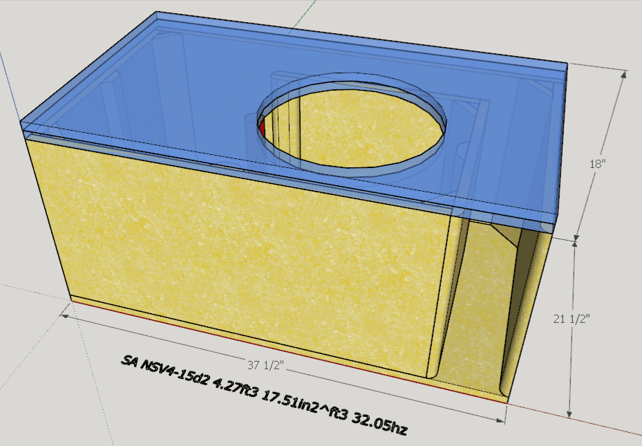

I'd love to see the finished build, and especially hear about the electrical that you end up doin' to support that amp... why try to use a enclosure for something else (another driver)? If you're gonna pay for something like that and stick it in a Prius and do all that work involved, I'd do the enclosure right the 1st time so once it's done it'll be in there... just my .02
What's that cargo area... 37.5" w & about 12" to the seatline? gonna be a lil' tall but I think it'll fit nice.
I wonder if an 18" tall enclosure will fit in there and the hatch still close? I got a design I did for the ol' Blazer before I went another direction and then seized the engine and ended up with my current ride... I did it for a 5K amp IIRC. The width is spot-on I believe but the depth/height might not work... IDK
the price scared me away as the Blazer was only worth $1K or less. Coulda tuned lower (and almost did) but I decided to stay near the Sundown recommendations.
How much space is back there in a Prius?.. Never played with one.

Whoa, that will be one skinny port. The width of the back wall ports will be 1.08" wide (27.5mm), but the front port will be shared by 2 subs so...
5
725
Assuming the box is made of .75" MDF the 12"x20"x15" box is 1.5 Cu Feet. The 33"x19"x15" is 4.3 cubic feet, something is not right here. JL has...
