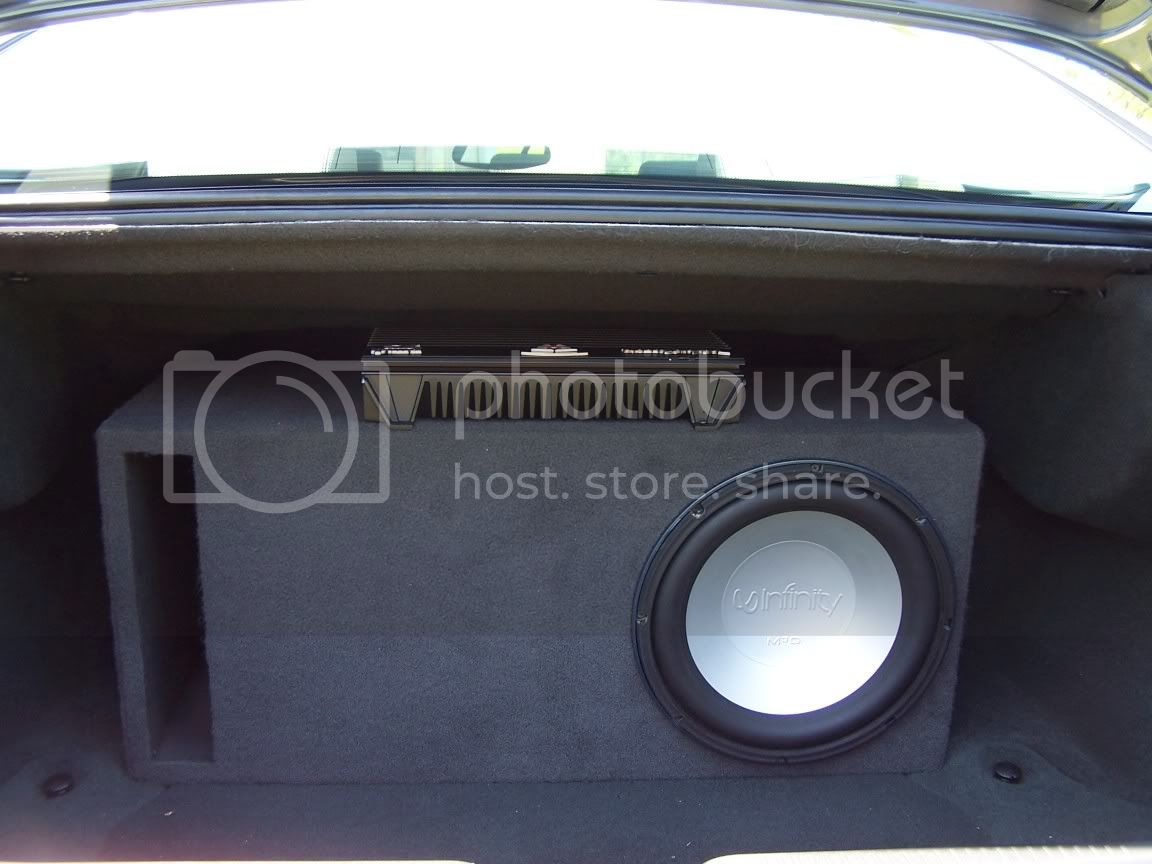

sorry guys, nice thought but the largest that will fit without rebuilding the very nice and very custom box I had built is a 13w6 (the face of the enclosure is 14 inches high) firing towards the rear of the trunk.
