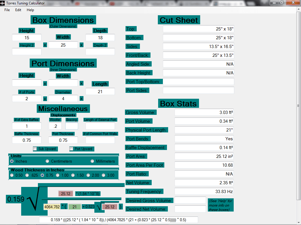

I want to make a box for my small mustang trunk that I am able to take out whenever needed. The biggest dimensions I came up with were H=15, W=25, and D=18. Now with this box should i put my 12 Z V4 or would a 10 X be better? Using an AQ 2200 amp.

If thats your dimensions exactly, You can try a 12 if you do two round 4"wide by 21 inches long pvc port firing to the passenger side but you'll want a lot of power and you cant really tune that low either. You'll want at least a 2k-3k rms korean board amp with an enclosure this size. If you wanted to do a slot port then yeah no choice but to do a 10
