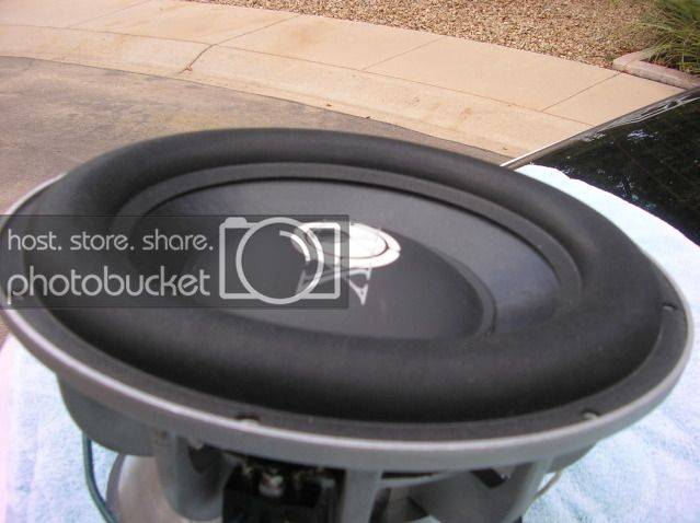

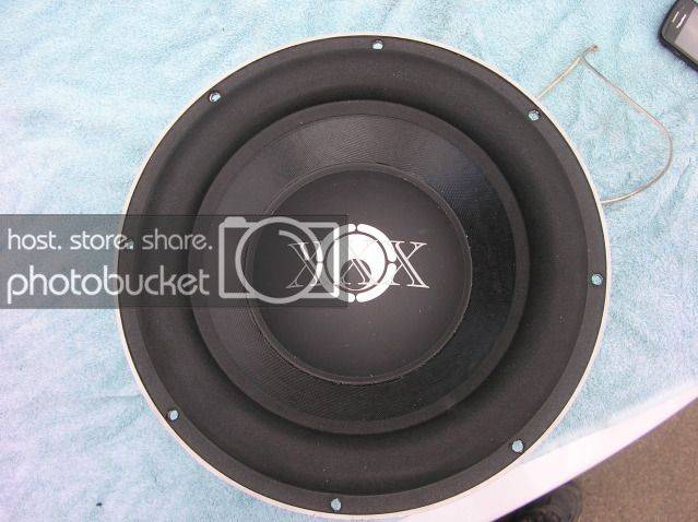

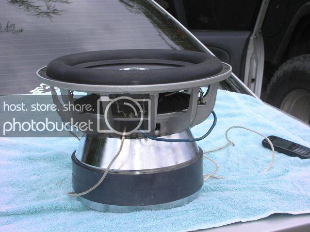

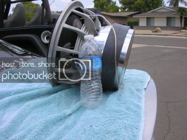

12'' Resonant Engineering XXX sub, 2003
subzero
who knows what the specs are for this sub.
