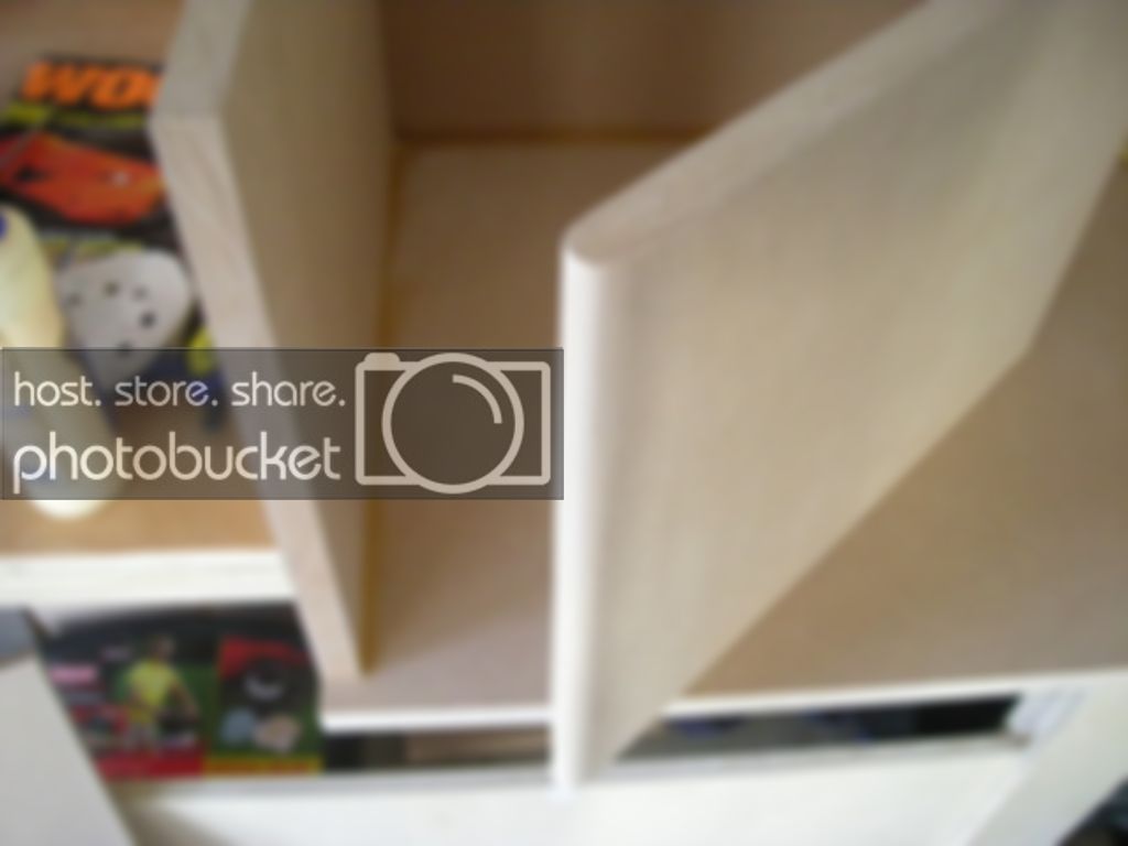

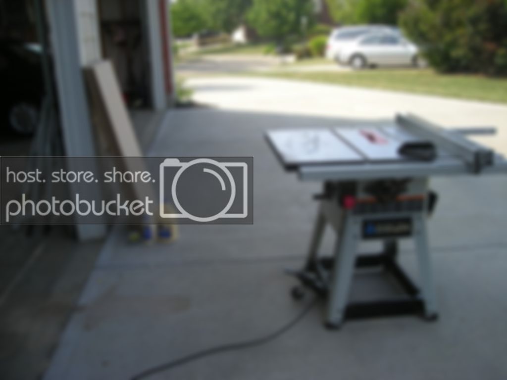

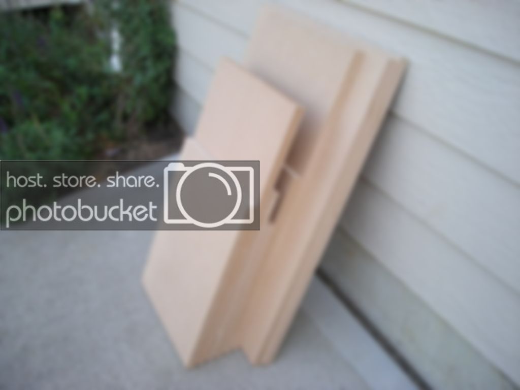

The pieces all cut and ready to go...

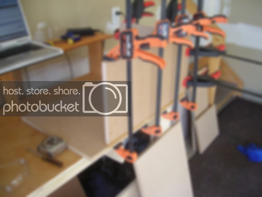

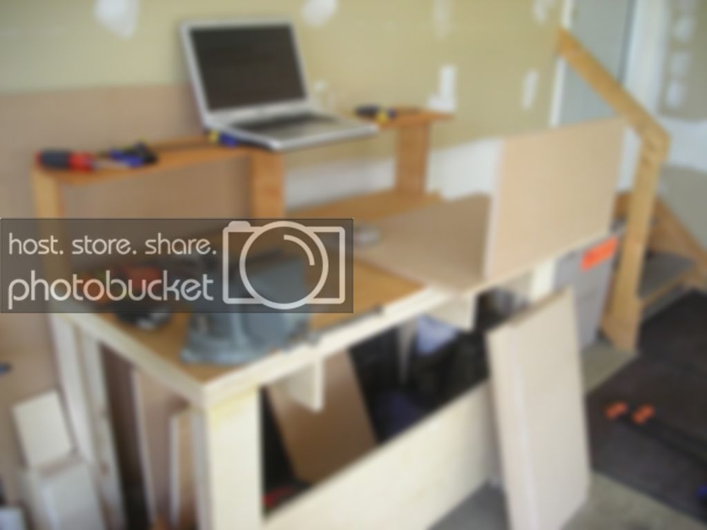

My workbench I just made...might make another for more room though..

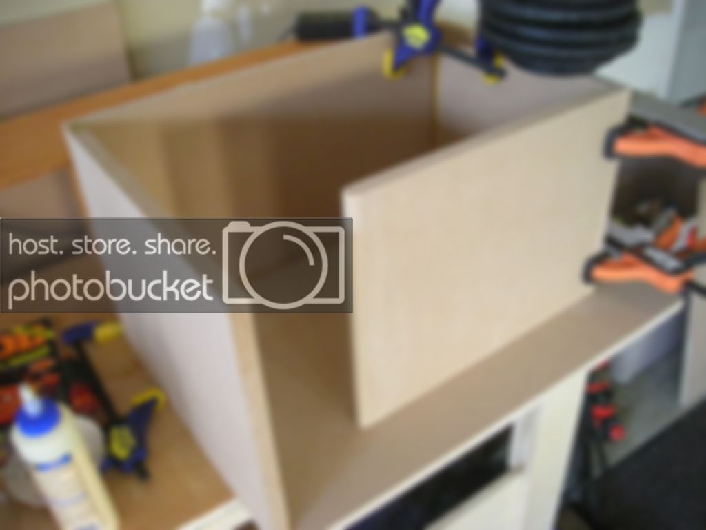

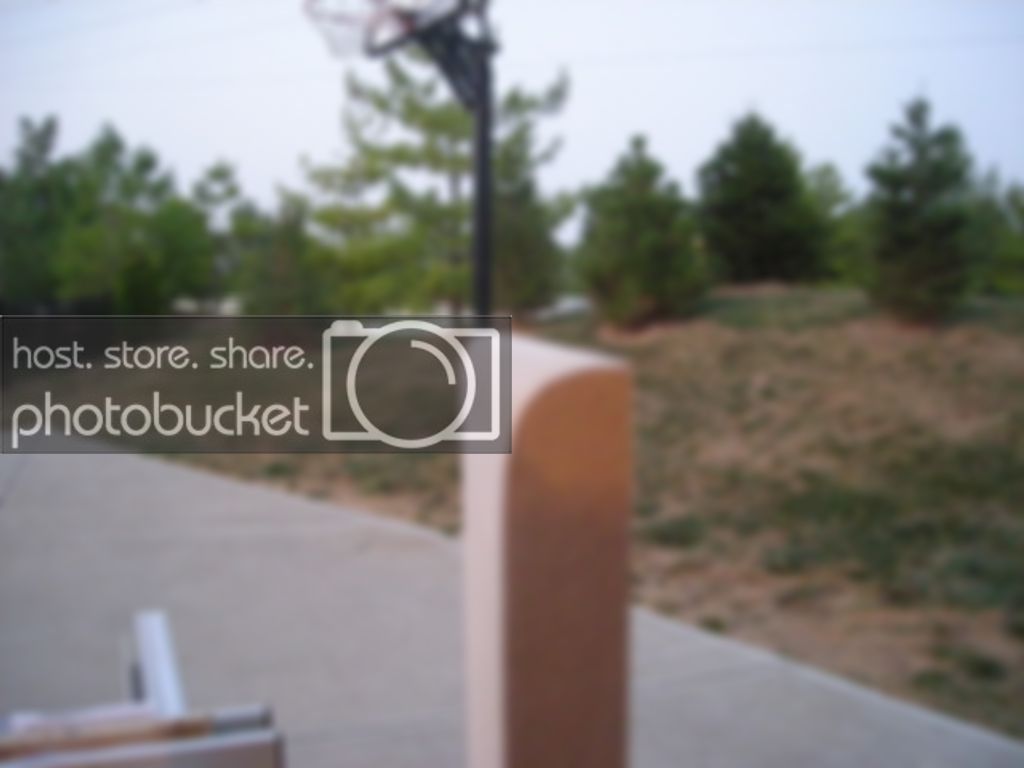

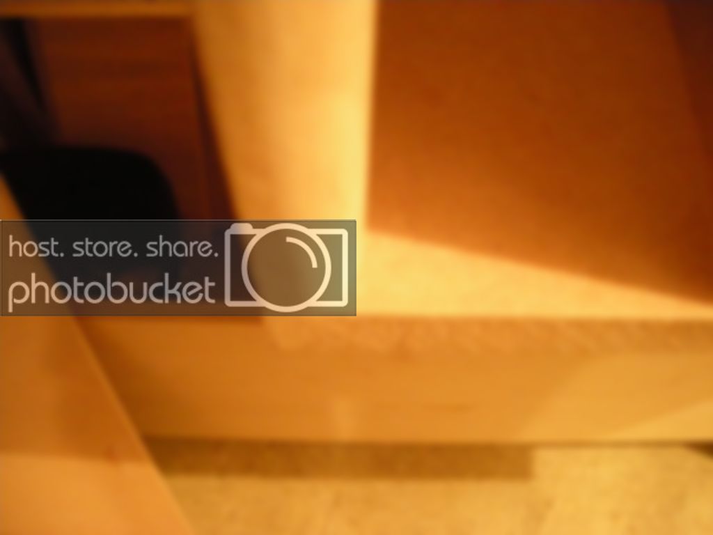

Rounding the end of the port..

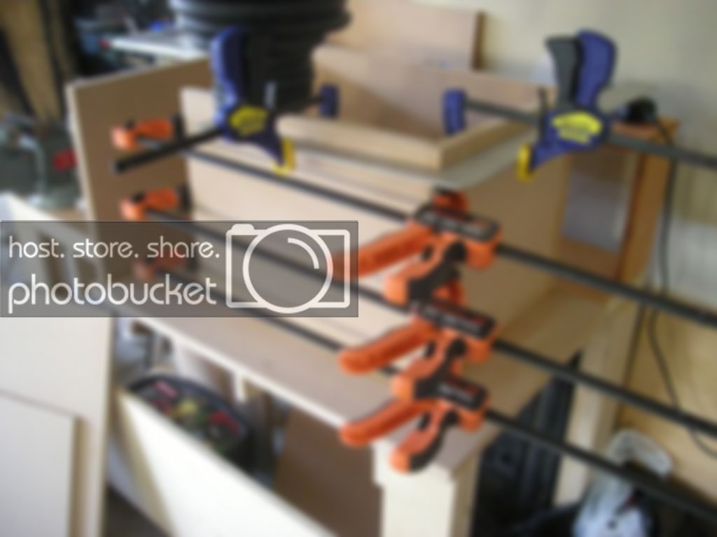

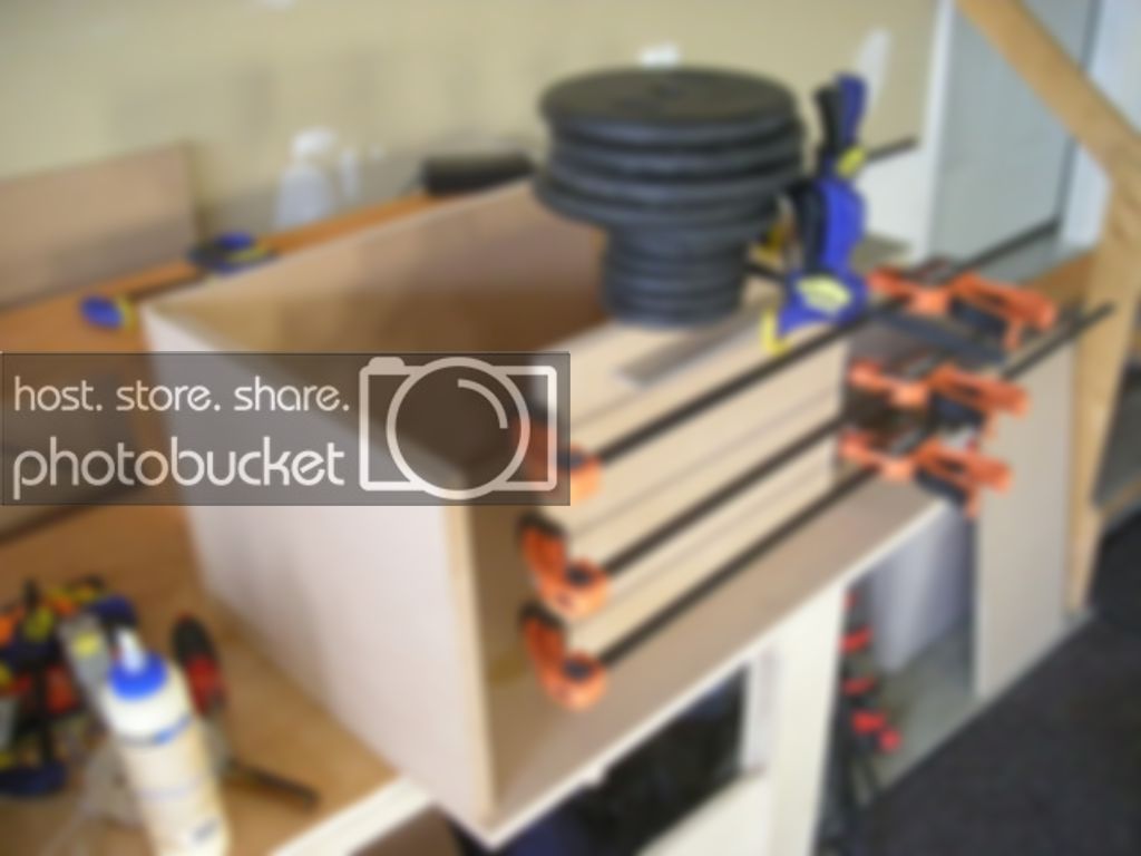

Clamping the back and left side together while the rest is clamped...

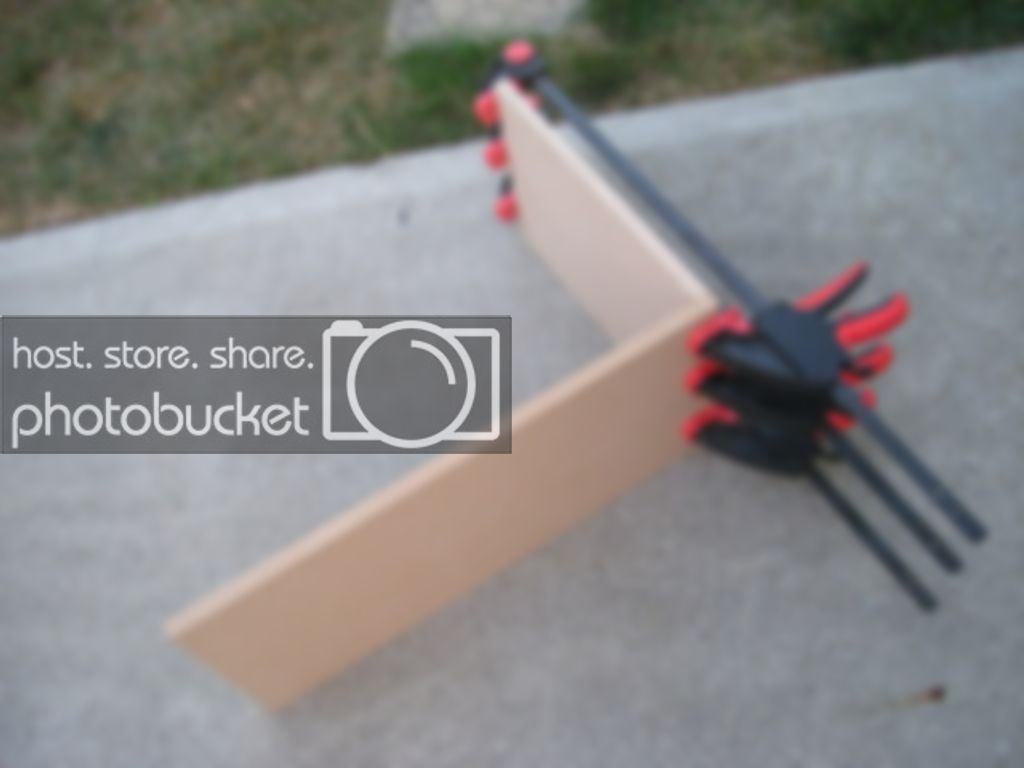

Rounding the outside edge of the port..

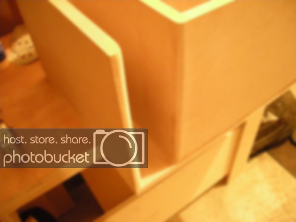

Clamping the 45 degree insert into the corner of the port..

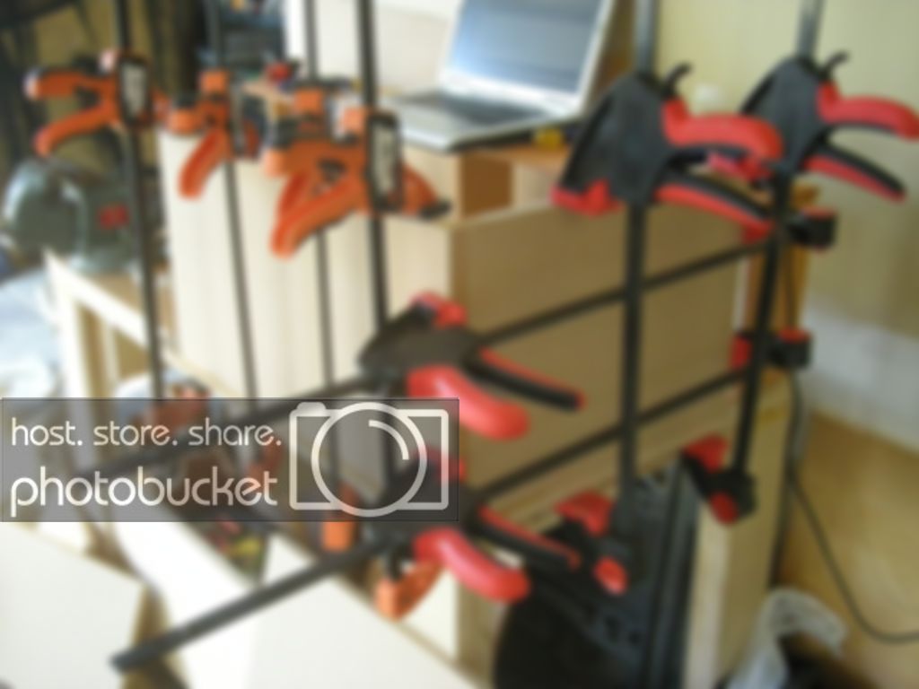

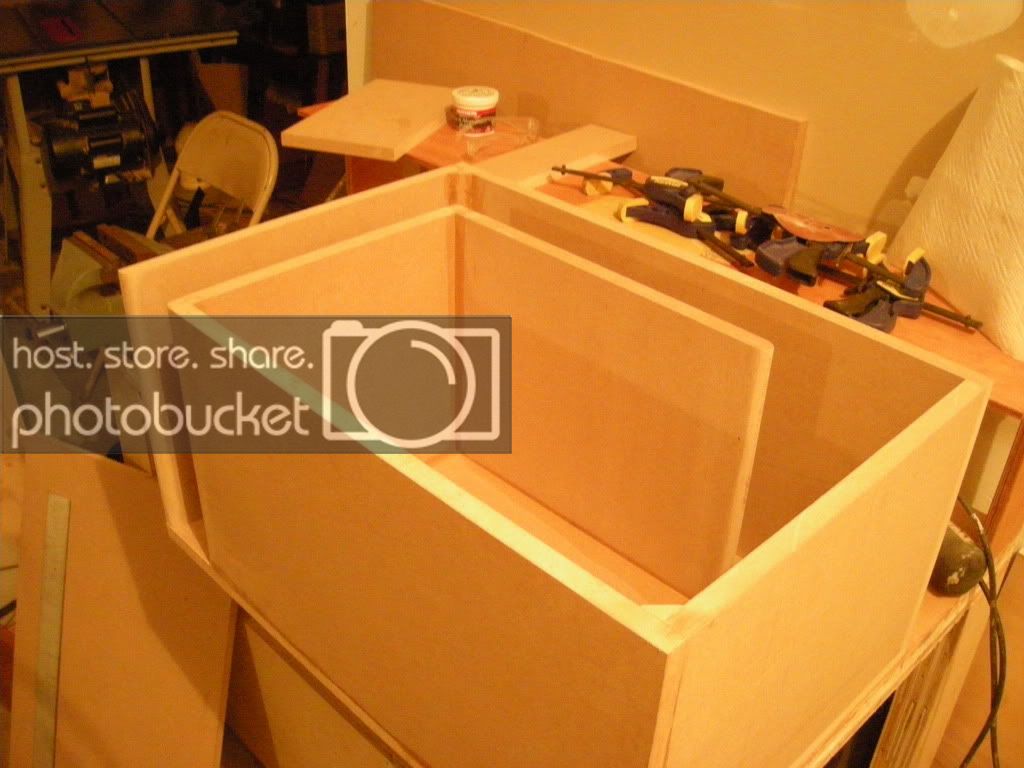

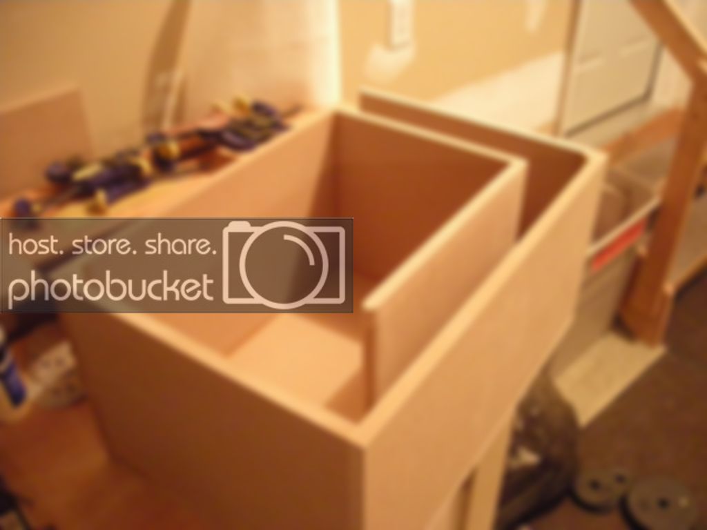

Finishing up (it doesnt have all of its 45 degree inserts in all of the corners yet...so not entirely done)..

Why don't you use a roundover bit and a router to do the port?
Thanks guys
And for the rounding-over there's really no reason haha, other than its a demo and i had my sander out there and I got the main shape with that and just hand sanded it to a better shape...this was only made to show them the jist of what theyd be getting. When im making boxes in large amounts everything will be pretty much the same except for using the round-over bit on a router instead of sanding, haha.
Thanks guys
Ah I see, well it looks good.
