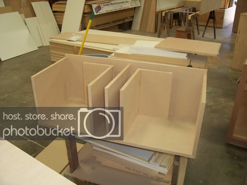

Heres a box i was building for my old 10" Mtx's, i just wanted to show you the shop.
Its nice:cool:
When you have your equipment PM me, my step dad owns a cabinet shop and i can get time there on Sat-Sun. Im only like 2 1/2 hours north of the Bay! If you need someone...
Its nice:cool:
